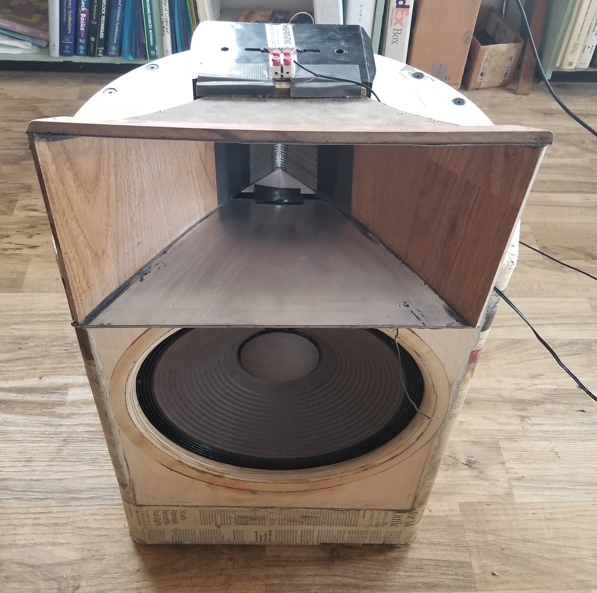

Here is my crude, experimental set-up, almost finished.
Kindest regards,
M
Kindest regards,
M
