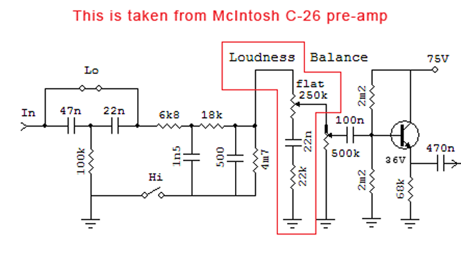

I have found out that for best performance, I have to correct bass level according to sound level on my system.
On the other hand, this is very unpractical an non-optimal. I could use an normal loudness control, but I don't find them working good!
Loking on the sensitivity curves for the ears tells that a level dependent bass eq is needed, but not eq in the rest of the spectrum. I think it is why I dont like ordanary loudness controls.
There are two basic things to look for:
1. Automatic bass correction with volume setting
2. Level control, to fit to system
The first could be a normal loudness potentiometer with only bass correction
The second could be a second volumecontrol
Anybody know about these problems and have some circuits?

I urge you to read "Loudness compensation use and abuse" by Holman and Kampman, and to have a look on the Apt Holman preamp. It's of the greatest help on the subject I am aware.

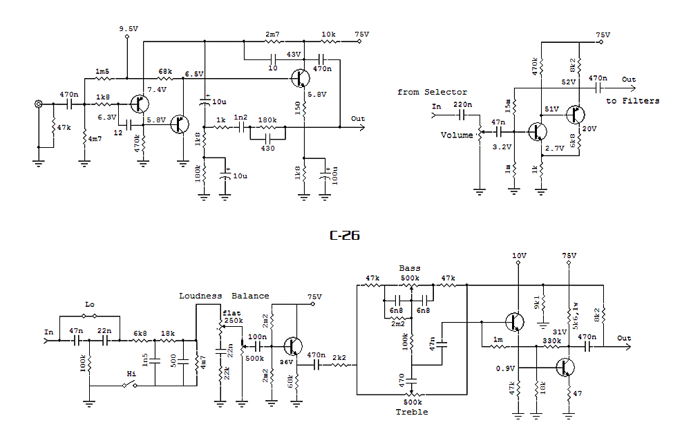

The Heathkit AP-1800 preamp (ca. 1979) was extremely full-featured - seperate bass and treble for left and right, variable turnover, bunch of filters, etc.
Although it didn't sound all that good, it did have a variable loudness circuit (separate pot) with an active circuit. The circuit description did include a reference to "newer" curves than the Fletcher-Munson equal loudness curves (the ones that made everyone believe that only bass compensation was required).

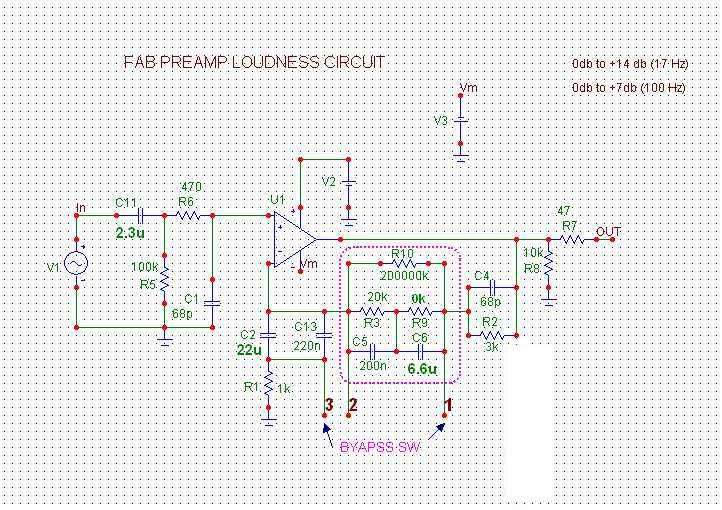

Variable Loudness circuit
I agree that the loudness setting has to be independently adjusted from the volume pot.
I also compensate for bad recordings where the bass has been forgotten...
This is the circuit I have come up with after several audio trials. It only increases the bass frequency gain. The main advantage of the circuit is that it is incorporated in the feedback path of your actual pre-amp so no need for additional active circuit. It can also be bypassed using a switch between connections 1 and 3 when not needed so no feedback cap in the audio path. The pot is shown as R3+R9 = 20K (linear). R10 is optional and the value can be adjusted if the pot value you have in hands does not provide the required compensation. U1 is shown to represent the active portion of the pre-amp since my real pre-amp circuit use discrete parts and not op-amps.
