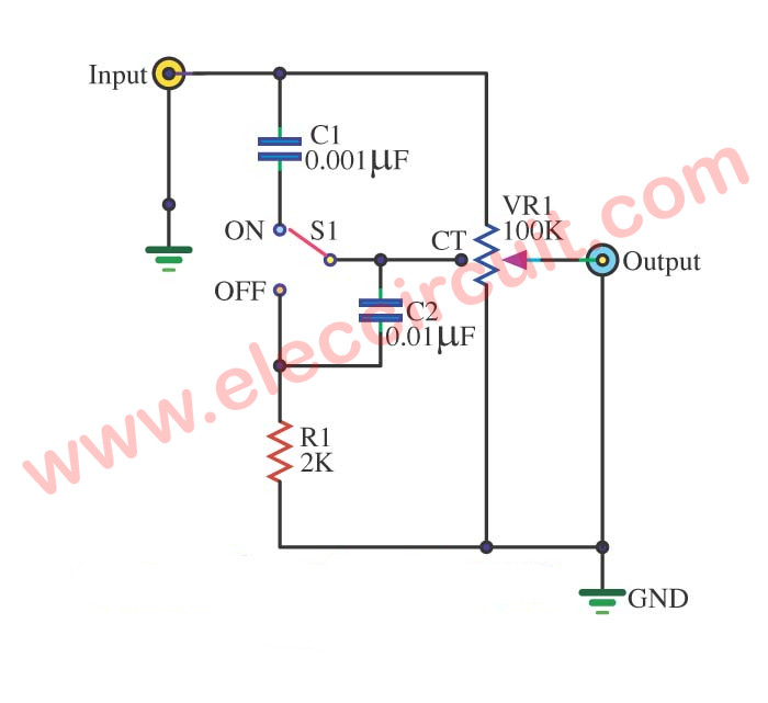

How can I use a 3 pin standard volume control instead of a center tapped 4 pin one in this below circuit.
There is no any 4 pin pots nowadays.Help me to add a 3 pin one.

Now if it were that easy, everybody would be doing it, wouldn't they?
The fact of the matter is you can't. 4-pin tapped pots tend to be not just uncommon but in fact special order to give the desired loudness response with a specific set of external component values. Guess why none of Rod Elliott's preamp projects includes loudness.
What you could try is Yamaha-style loudness with separate volume and loudness knobs. (You first set maximum volume, than proceed to control desired volume with the loudness control.) That gets by with just ordinary 3-pin pots if memory serves.
While not as easy to use, this approach allows for accommodating different source levels. A single-knob volume/loudness could be implemented perfectly, but loudness accuracy in real life is going to depend on source level (loudness war, anyone?) and speaker sensitivity, neither of which you can control particularly well as a standalone amplifier designer.
