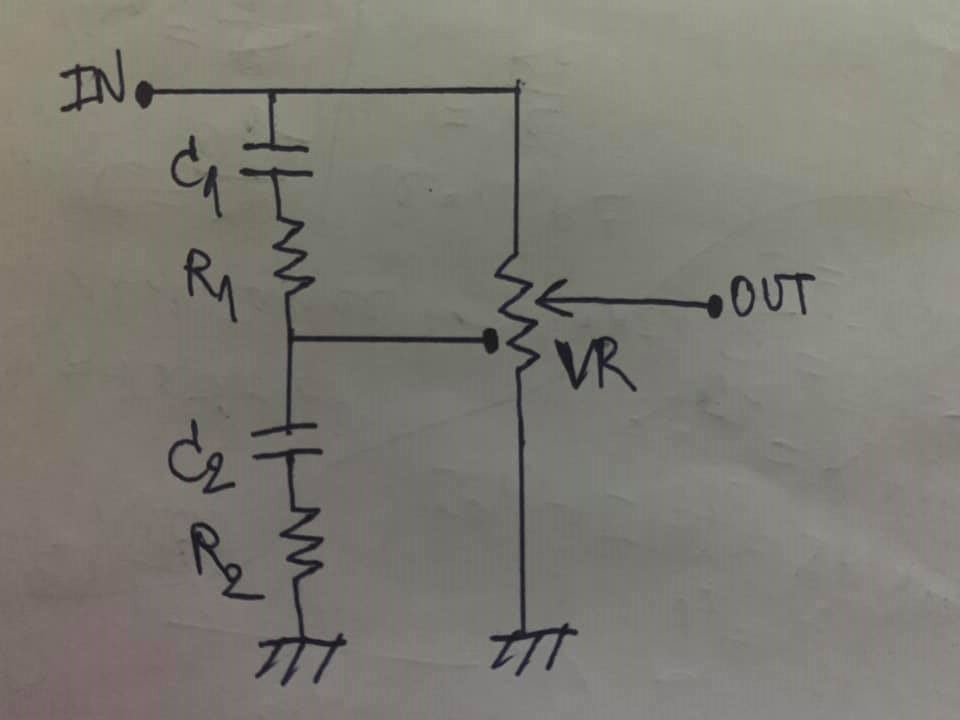

I'd like to modify the loudness circuit of my amp to work like another amp. After reading the schematics, fortunately, I found these two amps have the same loudness circuit! It is posted on attached.

Can I change the values of the loudness circuit of my amp (C1, R1, C2, R2) to the same as those of the other amp?

For calculation you need to know resistance of two parts of the volume potentiometer (before loudness tap, and after loudness tap).

Can I assume that it is 50% equal? Let say it is half of the full scale, 30k would be 15k and 15k, and 100k would be 50k and 50k.
The compensation corresponds to a certain sound level (not the signal level or the angle of rotation of the knob). This requires one more regulator without compensation.
I'd say "no", because of the different VR value. Unsure of your situation, as in do you have lots of spare parts hanging about / measurement stuff - or are you going to have to order the parts, so they need to be correctly calculated at the 1st shot.
Roughly, I'd try 540 pf and 0.1 in the 100K VR circuit - rather than going all the way to 1500 / .47; see if it moves in the direction you like. Should be easy enough if you have such bits kicking around.

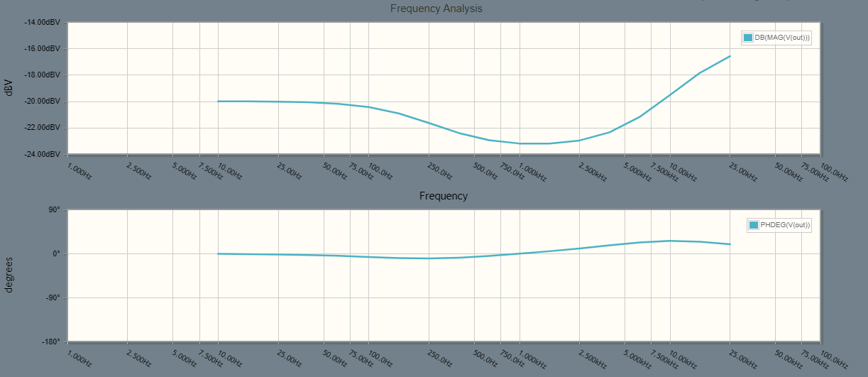

Looks like a good opportunity to learn LTSPICE; it's free and can numerically solve this type of problem. It'll show the frequency response of the one you'd like to match and then the one you have. You can simply change component values iteratively until the curves meet up to what you want. Then order parts and rebuild.

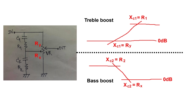

Do you have too much bass treble ?
Bigger bass capacitor smaller treble cap
The 470p is treble 390 will reduce gIn at 10khz

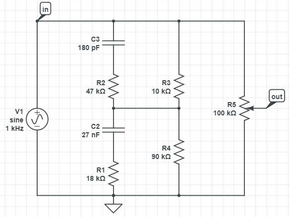

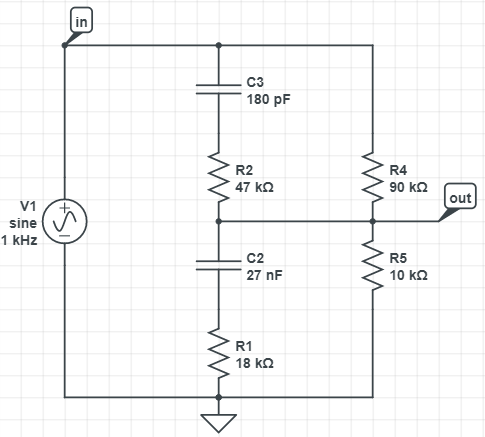

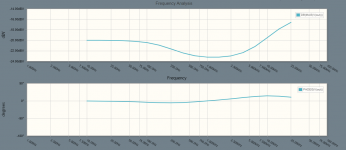

Very well 😉, I had tried on SPICE (online version) as your suggestion, preliminary, I got no results. 🙁
Since the center tapped potentiometer symbol wasn't exist in SPICE. I wasn't sure whether I could draw the equivalent circuit correctly as seen on attached. Could anybody help to check for me, please?
Circuit is not correct. Output must be from potentiometer, R4 must be divided to 10k + 80k and than output is in the joint of them.
Do you mean the circuit should be like this? It looks like a Wheatstone bridge circuit. It had a weird result though. 😕

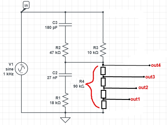

Circuit should be like this:
Out1, 2, 3 and 4 will show different eq curve, depending on position of wiper in volume pot.
Loudness will have most effect at Out1 position, (closer to the ground = lower volume) and will go to flat at Out4 position.
For that, you must divide R4 resistor (volume pot, part below loudness tap) into few resistors, to calculate it in LTspice.
Imagine that you have stepped attenuator volume potentiometer.

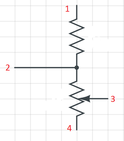

Do you mean that the equivalent circuit of center tapped potentiometer (4 terminals) should be like this?

presscot, yes, that would be the equivalent circuit of center tapped potentiometer (for the volume range from zero to loudness tap).
Upper resistor (also part of the volume potentiometer) is not important for calculations of equalization. But it must be here, because of the LTSpice simuation.
So your circuit is good for LTSpice.
