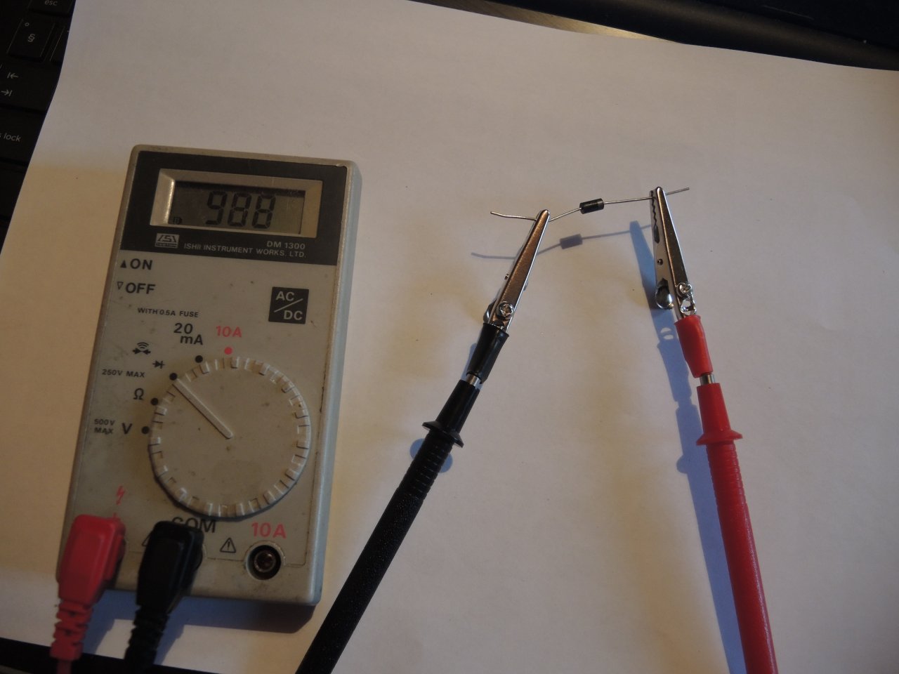

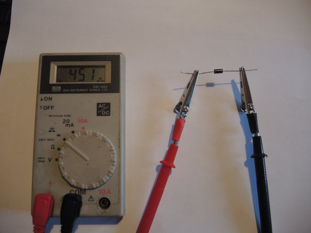

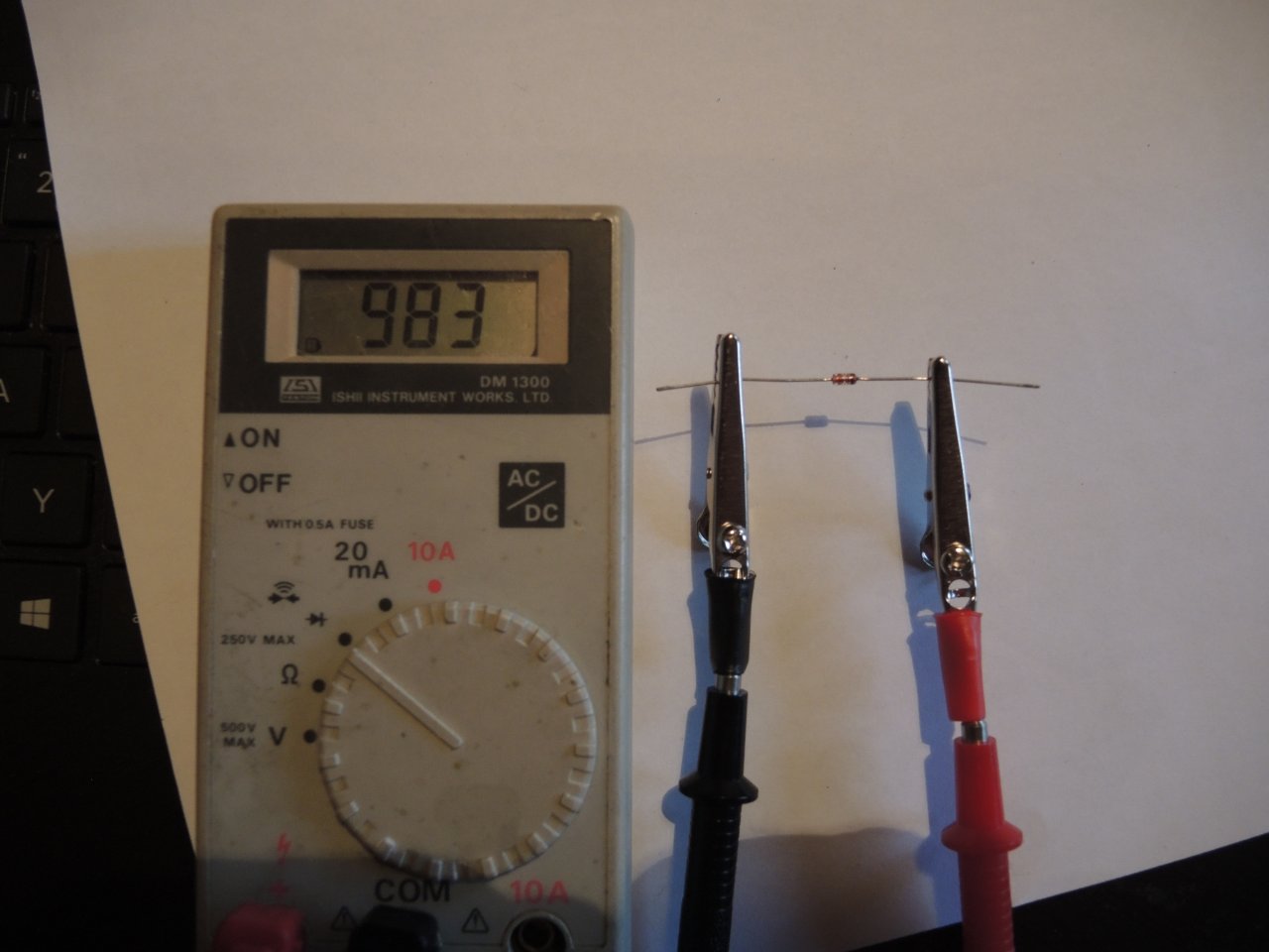

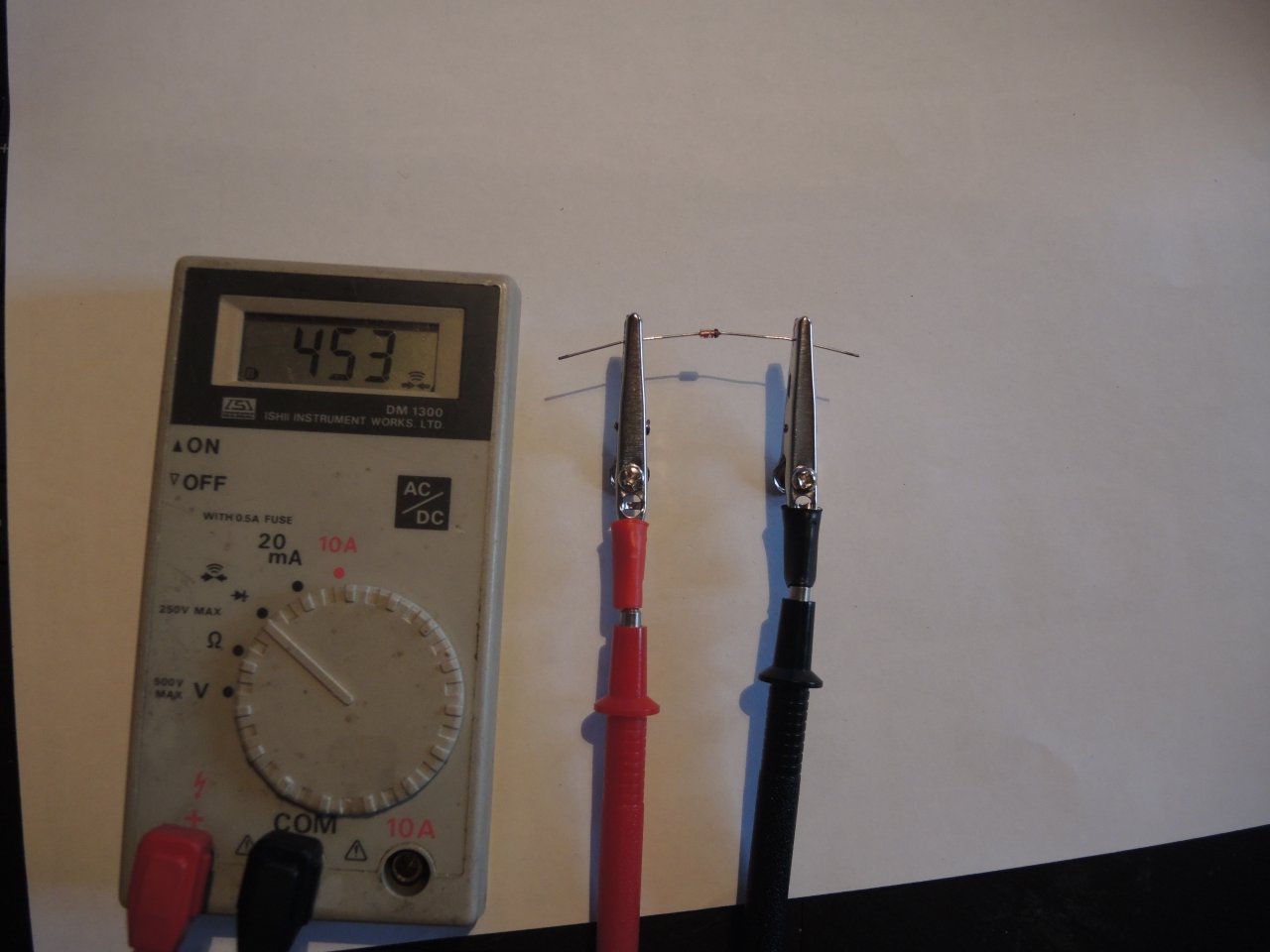

Before you go and make to many try and errors here a few things.
Diodes can be measured with a DMM, Switch to diode Sign and just hold the tips at both end on the diode.. 1 reading must be a number over 300. Reverse the testing pins of the DMM and this reading must be DEFINATELY HIGHER or open Cirquit.
You can measure this while in the circuits . Regular Diodes making seldom a short meaning 0.000 more than likely they will open like NC no reading on both sides.
If transistors are gone bad, then you would not get 25 /30,v DC at the output.
