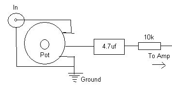

its my first time to build a gainclone, i have wired everything up and plugged the amp into a 220 volts socket. all i hear is a loud humm and a faint sound of the music. im a little confused with regards to the diagram.
where do you put the pot?is it between the 4.7 ufd 35 volts cap. and the phono input?cause thats what i did.
are my speaker busted already?
instead of the 56k filter, you can put the pot right? the pot that i have has 3 solder leads, how do you wire them up?

DONT connect your speakers now! Use first some crap speaker you dont mind to loose.
Measure offset of both channels. Starwire the ground wires. Try it without the pot: input cap (4.7), 10k resistor to -input. +input to ground. 220k on feedback. 1000uF caps on the rails. And youre done!

yes, use a rubbish test speaker.
sorry about the bad quality diagram, i hope you get the idea though...
