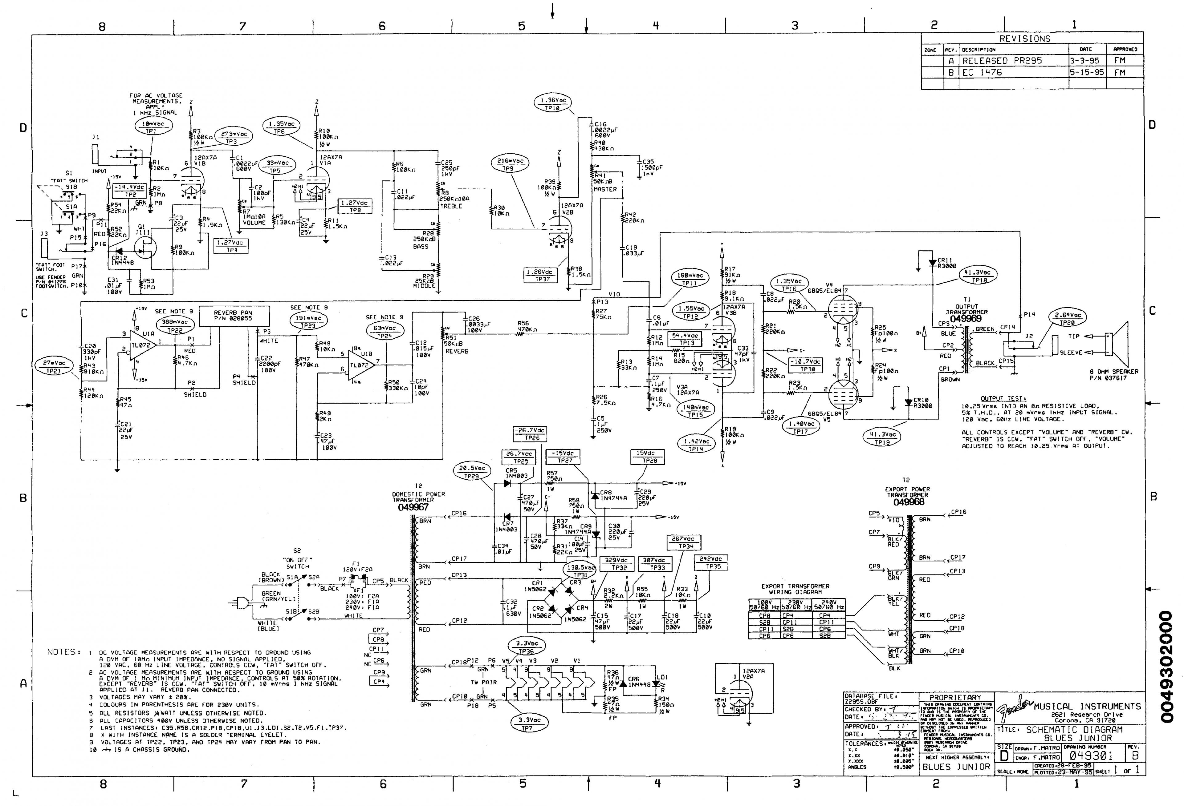

Okay.. i'll see what I can do...I don't quiet understand the reason, but when I open this page I see the schematic I posted big and clear..?OK...
Things like endless speculation can be eliminated by posting a useable schematic of this unit.
The link previously provided does not work.
And so many of us just hate to dig blindly.
I've always had troubles posting images here - in other forums one can usually just drag and drop an image, copy and insert, or at least upload from your computer. Here it seems on can only link to an image uploadingn site, and even then it is dificult to get the link working...I have given up trying a few times before, and this is one of the reasons im not around here so often to post.
This is the full schem, not as neat as the cutout i was trying to post.
OK your statements are not really consistent with any fault. So start again, measure the DC voltages on the power supply to check they are all OK (without OP valves). I would then suggest removing the driver valve v38 and seeing if the output stage is the problem. If you measure DC voltage across screen grid resistors it should indicate if the plate current is very roughly OK. Its just possible there's a fault in the power supply low voltage rails which put massive amounts of hum on the PA input. I still don't understand by probing the V5 plate stops the hum unless there is poor connection or HF oscillation.
Well its clearly oscillating at high power levels, probably ultrasonically and maybe pulling down the supply rail - did you measure the supply rail?
