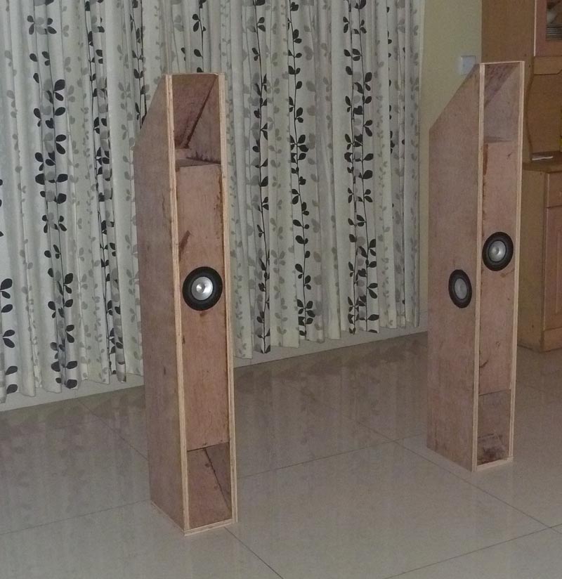

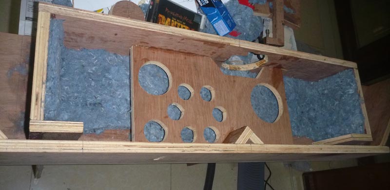

Finally completed the build last weekend. Had this project in my mind for quite some time, and IIRC had most of the pieces cut back in August.
Thanks to Italynstylion - his Lotus^2 build documented through posts on this thread was very helpful and informative.
http://www.diyaudio.com/forums/full-range/141496-mark-audio-chr-70-application-thread-7.html
Besides, Steven was always very helpful via PM on any questions I had :). I would also like to pint out the Coniston^2 build thread from Motosapien:
http://www.diyaudio.com/forums/full-range/175808-coniston-2-build-2.html
Another well documented build which gave me clear indication on how to go about lining the cabinet. Other members who would like to build either Lotus or Coniston, would do well to go through the above mentioned threads.
Why did I plan to build the Lotus^2:
1. Good reviews from forum members who had built them (they had CHR-70 gen1 drivers IIRC)
2. They had mentioned that bass was really good!
3. Elegant design

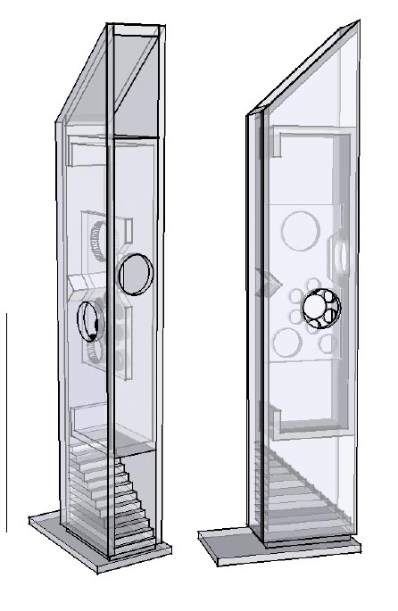

4. Since I find the CHR-70 a bit bright (I have gen 2), the side firing design gave me hope of balancing the sound
I am happy to tell you that the final result exceeded my expectations :).
I am getting best results by placing them ~8-9 feet apart (even foot or 2 wider would work fine I guess), with the side drivers firing inward towards each other. Placing them closer like 6 feet apart also works, but imaging and balance are much better placed further apart. Most of the times I have been listening from 12-13 feet distance from the speakers, and at times 6-7 feet.
The sound that these speakers put out is good - nice clear top with plenty and I mean plenty of bass... On tracks that have bass, you'll look for the sub-woofer in the room :). The bass is not as tight or dry as some MLTL/horn/pipe designs - it's warmer and has more bounce. And even at lower volumes there is healthy bass presence. The speakers put out a big sound stage and tall listening profile (these speakers are ~50" tall with double horn mouths). Sitting or standing the sound is nearly the same. They also have an open and live feel to them on a lot of music.
Another great thing is the wide sweet spot. Lot of FR designs have a very tight sweet spot and sound thins considerably if you are out of that - not with the Lotus^2. I can walk around the room (~250 sq feet) and enjoy the sound. The imaging is not point source type as some other speakers, but it's still good to listen to and instruments get nice separation.
I am using P10 enabled CHR70.2 in these cabs. I tried my Omnes BB4.AL (Black CHR-70 for Germany), but Dave's matched quad sounded smoother to me with more pleasant top. In my experience the CHR-70 gen 2 drivers work nicely with Class D amplification, and I am getting best results with my Dayton Tripath amp.
Music wise I've thrown plenty at them - and the speakers take on all genres well. Again, more advanced drivers capable of more refined sound like the Alp 7 will best the CHR-70 in many areas. But nonetheless, most music sounded good. Acoustic and jazzy stuff played with plenty of detail. Whereas when I tried Progressive House (Anjunadeep Vol 2 and 3) the Lotus^2 delivered in spades. Woofer like bass all the way, with nice articulation (not one note type). I can play around 75-77 dB with 80+ dB peaks and it sounds very loud in the room. Some bass heavy tracks do result in healthy cone movement, but it looked under X-max to me. Hard rock is also good - tried Satriani's Black Swans and Wormhole Wizards and songs had good energy to them with a "live" feel; I noticed 86 dB peaks on some of the tracks. Feeling encouraged I finally tried some real heavy stuff - Carcass's "Tomorrow Belongs to Nobody", and again the speakers acquitted themselves nicely, with solid sounding riffs, bassline, and drums. Tried them out with the TV also - they work very well as front left and right.
Clever design by Scottmoose that brings out the strengths of the driver. I am very happy with the build. Now Coniston^2 beckons! :D

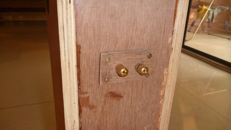

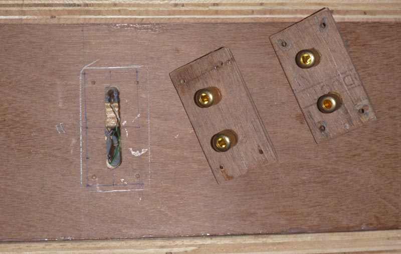

Had joined the back before cutting the hole for the terminal cup... Thought I'd resort to something different to get the terminal posts in place.
Cut a 8 mm x 50 mm slit with the router; then used this home-made terminal "cover" (well it''s not a cup) made from 6mm hardwood ply. Worked out nicely.

Let's see if I can cut out two circular pieces and screw them on in place of the side drivers to check out the single driver performance. But my understanding is that the dual-driver config will be better:
1. Less excursion
2. Side driver acts a 0.5 driver and adds more bass vs top end - balances the CHR-70 sound
3. Wider sweet spot
But if you are looking for bass, the Lotus^2 and Coniston^2 should be right up there.
