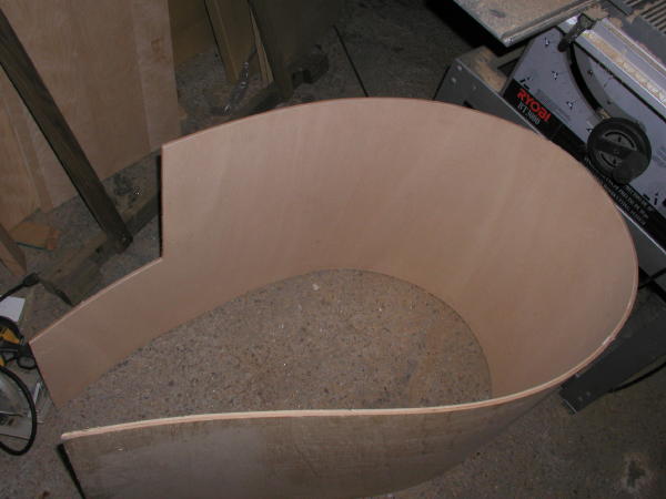

My friend Chris (the guy i get to build any cabinets that have to be presentable) just went thru a bunch of experiments building a curved back box. There is a specific, but somewhat pricey material that he says is all he will use. I'll see if i can get him to come explain.
dave
There is 1/2" plywood which can be bent to any shape. Apart from being pricy it also doesn't seem to be hard. Available from building suppliers.
The other alternative is to use ribs (which will also serve as braces) with matrix construction (like B&W) and use wet plywood or MDF.

plywood would open up so I prefer to use MDF.

Well, I finally went and found some pictures of the speakers you were talking about, and I would have to say that YES you want to laminate layers!! As to the lead sheets between layers, I think you'll find that you'll have problems with maintaining the shape of the curve and securing the MDF to the lead. (I have no idea how you'll attach them, unless some type of two-part epoxy will work) I think the stiffness you'll get with the curve and anything the glue you use will add will make it pretty stiff that adding the lead will probably make little difference.
I definately recommend using t-nuts (and yes that's what others were trying to think of) to hold the drivers to the baffle. As to the lamination stuff, the picture that I get in my head is going to cause problems. (Are you planning to mount the drivers to the back of the baffle or the front?) In my mind I see the laminate coming loose from the drivers and buzzing.
