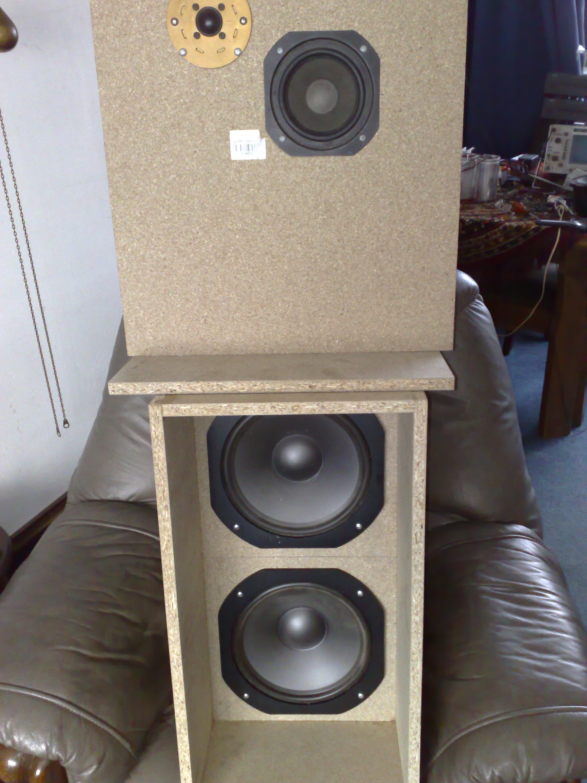

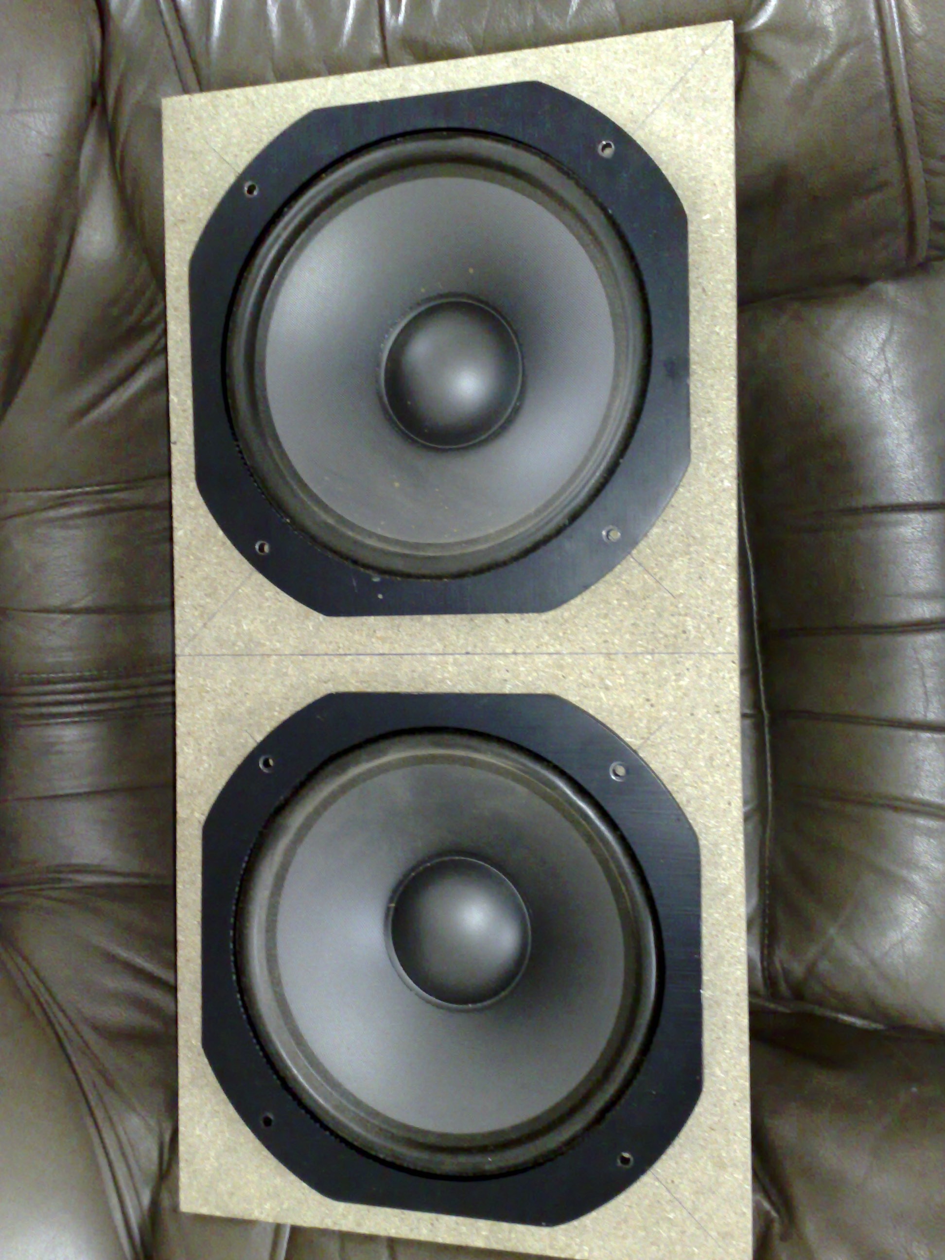

I have get music out of it, it is mono, it has some colouring because of the 6 db filters who has a wrong go over.
woofers go to 250 hz, and then H frames do colouring the sound, but the bass is deep, and beautifull with this low qts speakers, but one big high qts speaker will work beter I think.

I go change tomorrow the filtering to 12 dB octave, so hollow sound dissipair or little damping on the wall
s of h frames ( 2 a 3 mm thick), but filtering will do..
