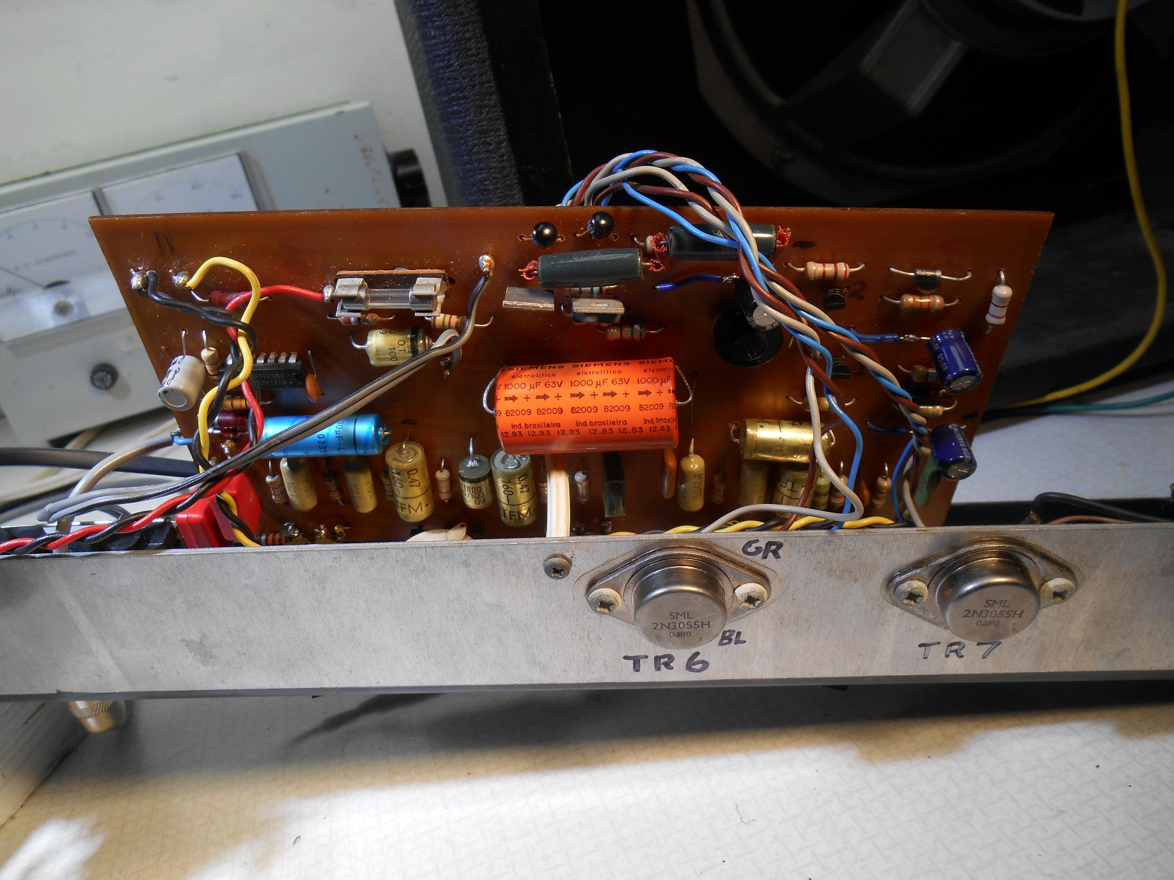

Hi, one thing I recently discovered about my Vox Escort Bass was that R20, which should be 22 Ohm on the schematic, after the two diodes and before the base of TR3, basically a bare wire (I.e. no resistance) on the PCB. It looked like that was factory installed. My amp was clipping after notes were played, almost a “after-note distortion”. Replacing the wire with the correct resistor appears to have solved my problem. It sounds like your problem may have a different source but it’s worth checking this, just in case. You could also try an oscilloscope or audio probe to follow the signal and help isolate the problem. Hope this is useful and good luck!

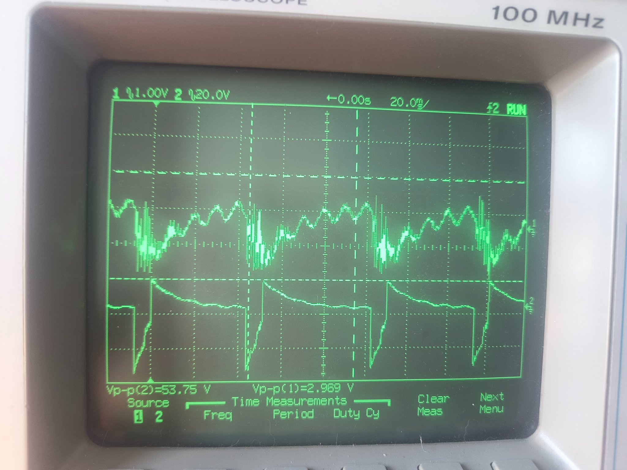

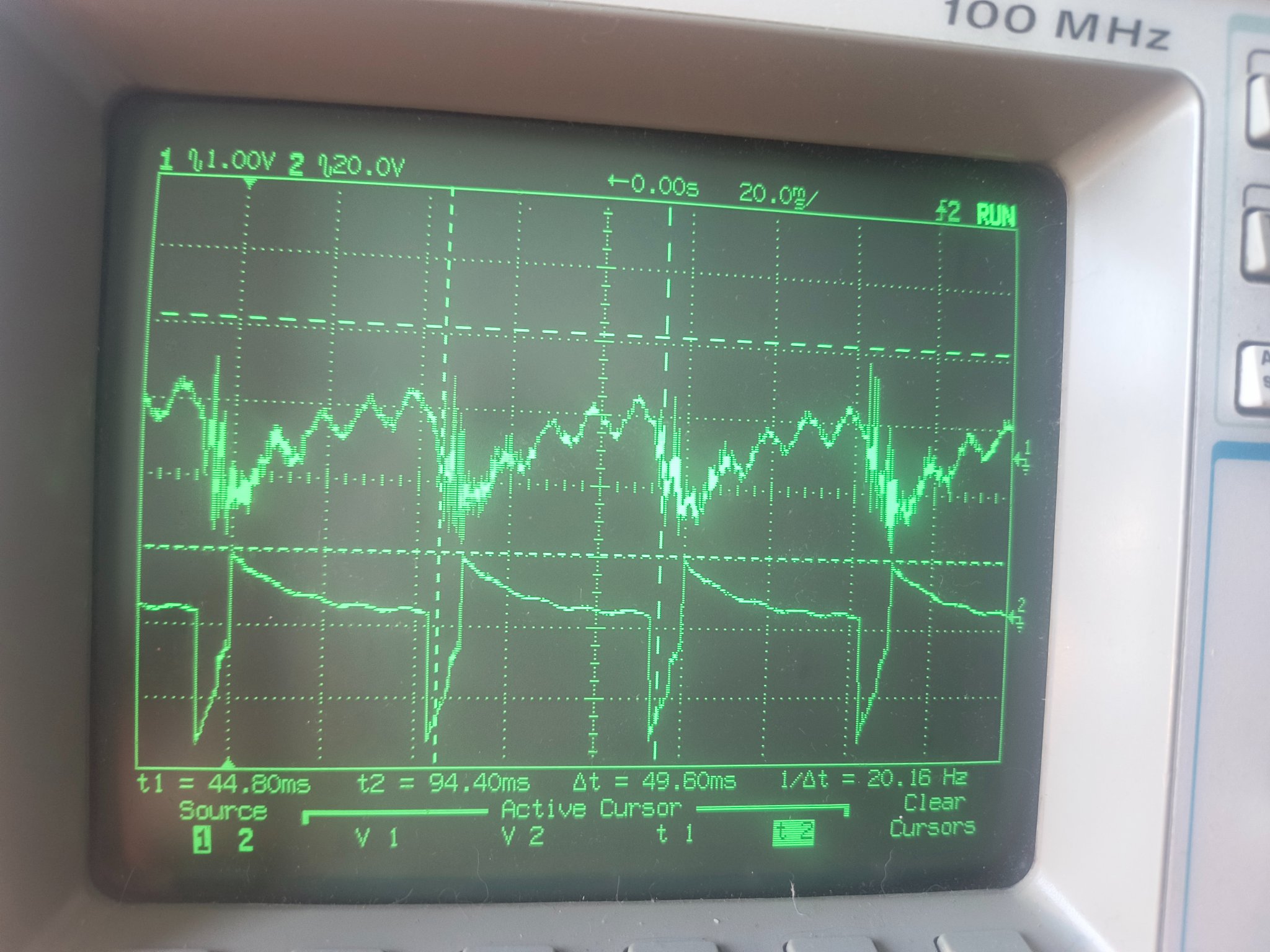

So the amp gives nice output but only to 40V P-P. Then severe limitation on positive wave occurs. Negative wave keeps raising in amplitude to the cutoff. I tried another pair of CDILs. And exact the same as before happened. I'll attach photos from the scope. Channel 1 is TR1 base, channel 2 is output. This happens with quite low input. Increasing the input shortens the period of the havoc on the output.

Next I mounted random old Czechoslovakian KD607 and the amp again "somehow" amplifies, this time 45V p-p. Verdict: CDIL 2N3055 I bought are probably unsuitable for audio use. Very interesting fact is, when I measured them, the Hfe raised with current. For example Hfe of 83 at 500mA vs 104 at 3A. Same transistor. Just weird. Maybe tempco played role there but as far as I remember I tested them warm and didn't let them go very hot. I hoped they will be ok, as I bought them from quite reputable seller. Well, maybe I'll build some regulators with them.
