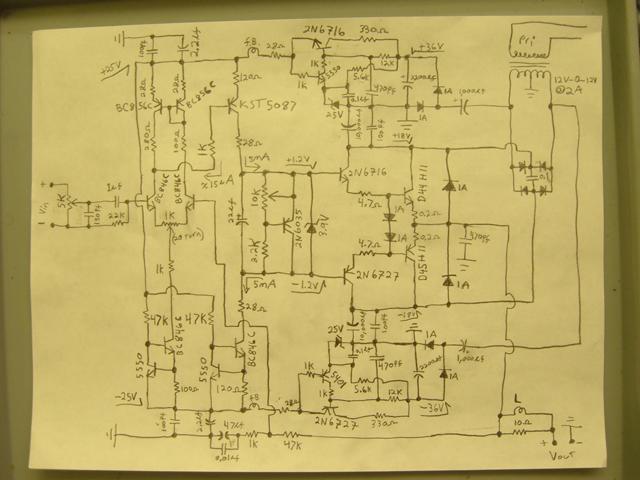

Normally I agree with capacitive compensation to hold stability. Always worked for me in the past. However, the last amp circuit I made seemed to tell otherwise. Straight forward design with single LTP w/mirrors, CCS VAS, darlington arranged drivers and outputs. When I attempted to compensate, as normally done, I found adding miller comp, miller feedback, or small pf cap across the feedback resistor, caused it to occilate.
A 470pf cap from output to GND as part of zobel net totally killed the small RF occilation it had. Quietest amp I've made yet.(noisewise of course) I have yet to work out the details of why compensation in this circuit seems to have opposite effects.
I'm certainly not complaining, I've made 2 channels and have the same results.😎

HI CBS240
A schematics with indication of locations and values of capacitors which made your amp oscillate, and the exact location of the Zobel network which stopeed it, could help to find the origin of this unattended behaviour.

Hi Forr,
It seemed like as small as 18pf caused problems and larger values were worse.
miller feedback (from collector of VAS to base of -diff transistor) miller compensation(from collector of VAS to base of VAS)
or small pf cap across the 47K feedback resistor all caused instability. Without these I get perfect 0V output, well maybe a +/- a millivolt or two.🙄 With a 20 turn pot, I can zero the output quite accuratly. I'm perfectly satisfied with the results, but a little lost as to why. I think the small Cout of the VAS I used may have something to do with it...like 2pf at 25V. Or the larger degeneration of the 1K pot in the LTP.
output is like 25-30W into 4Ohms.
PS sorry about the quality, I think it's legible though.
