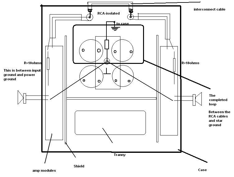

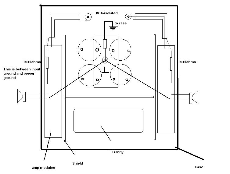

If the loop area=0 there will be zero hum pickup.

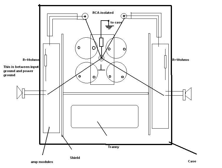

I think that is impossible or I can't understand exactly.Check the pic.
I have been told that toroid transformers can produce very directional "spears" of magnetic leakage. You could use a search coil connected to an amplifier to map these out in 3-D. Then turn the transformer to minimise the field in the direction at right angles to the loop.
I tryed to move the tranny in all positions and angles and yes-the stray effect is different.I choose the silent mode.
In that pic. is how I intend to do but this is possible only with two power supply's.
What do you think?
Zero loop,zero humm,zero noise.
Maybe this is impossible.
What do you think?

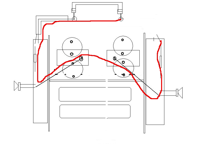

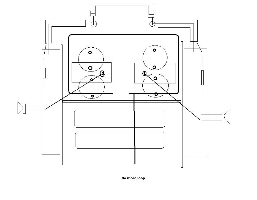

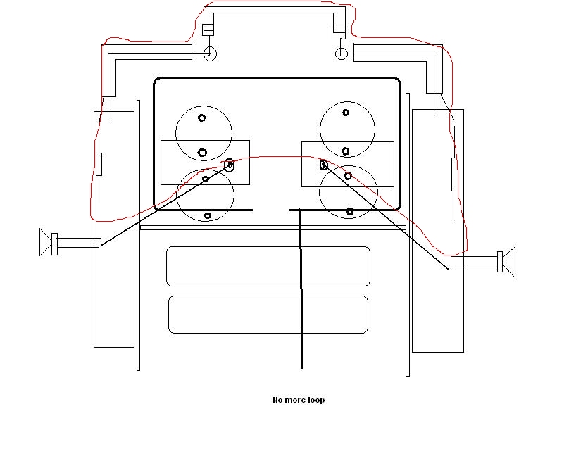

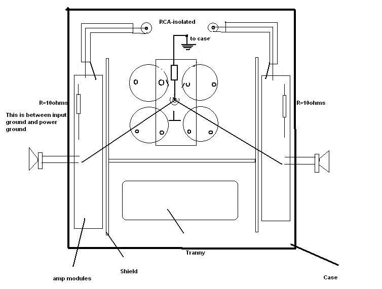

Felix as far as I can see you still have a huge loop area (shown in red in my attachment) in your last picture (case 3). You need to take the left input cable over to the right as I described in an earlier post. I will try to draw a picture if I get some time.
This is what I meant. The right input shielded cable should follow the thick red line I have drawn in order to reduce the loop area. You should tie or twist the left, right and ground cables to keep them together.
I apologise if it offends your sense of symmetry. I'm sure you could devise a better way that still keeps the area small.

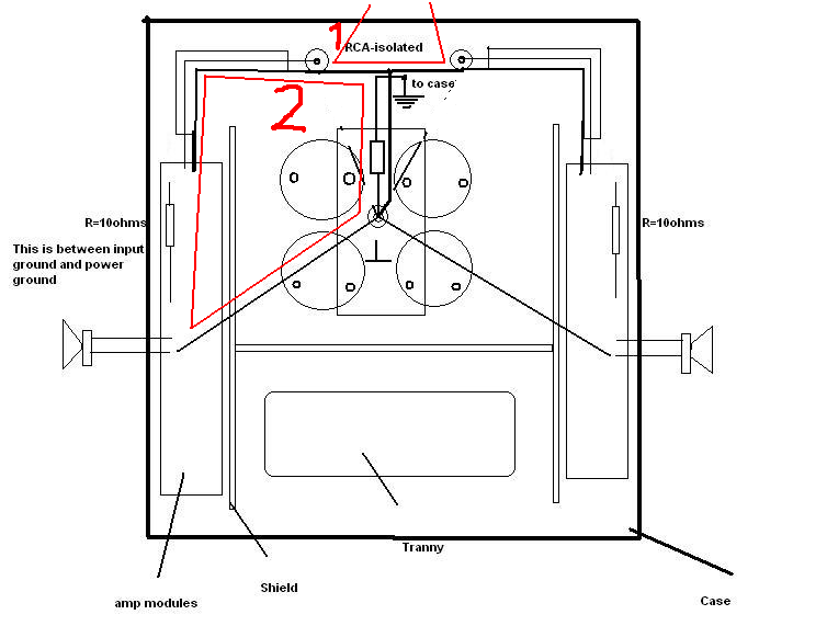

Connect the input RCA grounds to each other at the connectors and then connect with ONE wire to power supply common, not two like in your last picture. Also make sure you remove the wires from power supply common to input ground if you haven't done that already. Input ground from each board should go through the shields and meet at the inputs. The 10 ohm resistors make sure there is no loop around the amplifier. Connecting only one wire from power supply to the inputs makes sure the loop that is still left has a very small area.
This makes loop 1 as small as possible which is what matters. Loop 2 does not matter as no significant current can flow through it due to the separating resistor. The voltage that falls over the separating resistor is only amplified one time instead of by the gain of the amplifier so the hum should be inaudible.
Observe that the shield is now connected at both ends! This is VERY important.
Optimally, the star ground should be moved off the plate as Andrew says too but it may not be needed. Current between capacitors and transformer must not be allowed to flow through the star ground point.

Wasn't that with the input ground disconnected from the screen? The loop breaking resistors won't do any good in that case. The screen is used to sense the ground potential at the input terminals, the amplifier only amplifies the difference by its gain. The voltage on the screen relative to amplifier power ground is only amplified one time.
Without the screen connected at both ends the loop voltage will fall between the RCAs' shells and the input ground. This voltage will be amplified by the gain of the amplifier when another unit is connected.
megajocke said:Loop 2 does not matter as no significant current can flow through it due to the separating resistor.
Are you sure about this? If we assume that without the 10 Ohm resistor the loop resistance would be around 0.1 Ohm then the resistor will reduce the loop current by 40dB. Maybe this is not enough? Difficult to tell without being there and listening.
You might have a point, but the 10 ohm resistor seems to usually be enough. What matters is the voltage drop over the shield of the input cable, because that will be amplified. It should be possible to get this resistance pretty low.

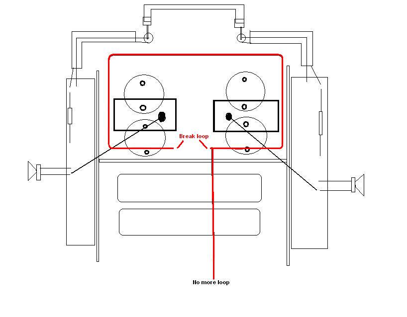

Splitting the PSU's should be fine! 🙂 But isn't that cheating? 😉
Is your "Case 5" still silent when connecting other equipment? It should be possible for it to work.
I'm surprised though it started humming when connecting the RCAs to the PS with a single wire. What stuff is connected to the input ground on the amplifier boards? Is the ground of the feedback network connected there? It would be interesting to see a schematic of your amp. 🙂

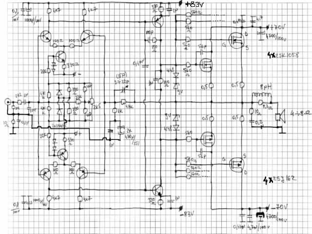

The schematic is simple as possible.
Vali,
Cut the 100nF capacitor in parallel with 10ohm on input ground.
Add a follower between VAS and output stage. The output capacitance seen by the VAS is huge at HF without drivers (you have multiple parallel FETs in output stage). An amp without drivers is suitable only for subwoofer.
The 2 diodes CCS has a poor PSSR. There is a regulated power supply for the LTP and VAS?
Mihai
Mihai
That looks nice, the cap between VAS bases might cause som strange effects depending on the power supply, but it probably has nothing to do with the hum. 🙂
