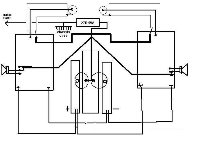

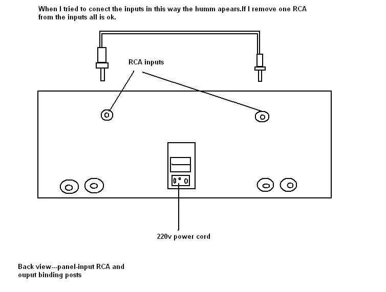

Two amplifiers are connected to the PSU by +ve, -ve and power ground.
I have two screens from the signal ground to the RCAs. Both RCAs are isolated from the chassis.
When I connect one input plug, still silent.
Now connect the other input plug and look at what I have -A BIG LOOP.
Start at power ground to PCB power ground through PCB to signal ground to input screen to RCA to interconnect to source component across the source component to the other interconnect to the other RCA to the other signal screen to signal ground to PCB power ground to power ground= closed loop= hum.
I must break this loop.How?

Hi Felix,
Make two separated PSU, one fore each amplifier, like in a true monoblock but with a single case. Then, you will have only one common ground point, at input of the amplifiers.
Mihai

That is one way, but the most complex/expensive one. It is perfectly possible to have no hum with a shared transformer - look how many commercial amps do it.
Are the amp boards made by yourself? Does the input lead screen just go back to the amp board which in turn has a ground back to the star at the PSU?

a dual rectifier PSU for each power amp will separate the power grounds between the channels. This won't eliminate the hum but it will reduce it significantly. The power grounds must be taken separately through two disconnecting networks to the safety earth.
Better still is a four secondary transformer that completely isolates the two channels. Again two disconnecting networks are required.
Taking the two RCA grounds back to their main audio grounds so that the signal grounds go via the input plug ground may be quieter than running the PCB signal ground to the PCB power ground.

A loop is only a problem if the area is large and there is an interfering magnetic field crossing the area. For example, all twin phono leads complete a loop via their screens when they are plugged in at both ends, but, that does not produce hum because the area is small.
Try re-routing your input wires inside the amplifier to reduce the loop area and to get them away from the mains transformer.

Mihai....all that is done.
10 ohms parallel with 0,1uf.
And the problem is ONLY when I attached the other channel interconnect to the cd player.
When I run amplifiers separate all is ok.
I replaced the toroid tranny with R-core and the problem disapear....too bad because the R-core was borrowed from a friend.
But now I want to try to modify the star ground to make that 1kw toroid to do the job right....I hope.
I will try to disconnect the case of the amp from the 0V buss rail and
connect a 5 watt 27 ohm R between case and 0V,close to RCA inputs,like in the picture.
The 27 ohms is a much higher resistance than the shielded wire to the cd player,so any ground loop voltage should not appear across the lengths of shielded wires used anywhere.

Is it hum or buzz? Buzz is rectified ground current.
Simple solution: run each screen from it's RCA to the point on the board where you put the signal. For instance, you probably have a resistor from the input to ground on the board. Put the screen on the same ground point as the resistor - or connect directly to the resistor terminal. No connection from screen to any other point.
Then, the speaker return goes to the supply star point for that channel, not to any other point

Sounds like you're making progress but I have a suggestion. If it's hard to move the transformer, move the wiring instead. You just have to re-route the input shields so that the loop that they form when the external interconnect grounds are joined, has its area reduced and is in a different orientation to the transformer stray field. i.e. run the left input cable across to the right input socket and then have both left and right run (twisted together) to the right channel pcb input. The right ends there. The left shielded cable can now carry on to the left channel pcb but via some other route which keeps the loop area small. Probably the other side of the transformer, but you'll have to try it and see.
The only reason you get hum when the cd interconnects are both connected is because you have completed the loop. Reduce the area of the loop and move it away from the transformer and you will reduce the magnetic pickup.
