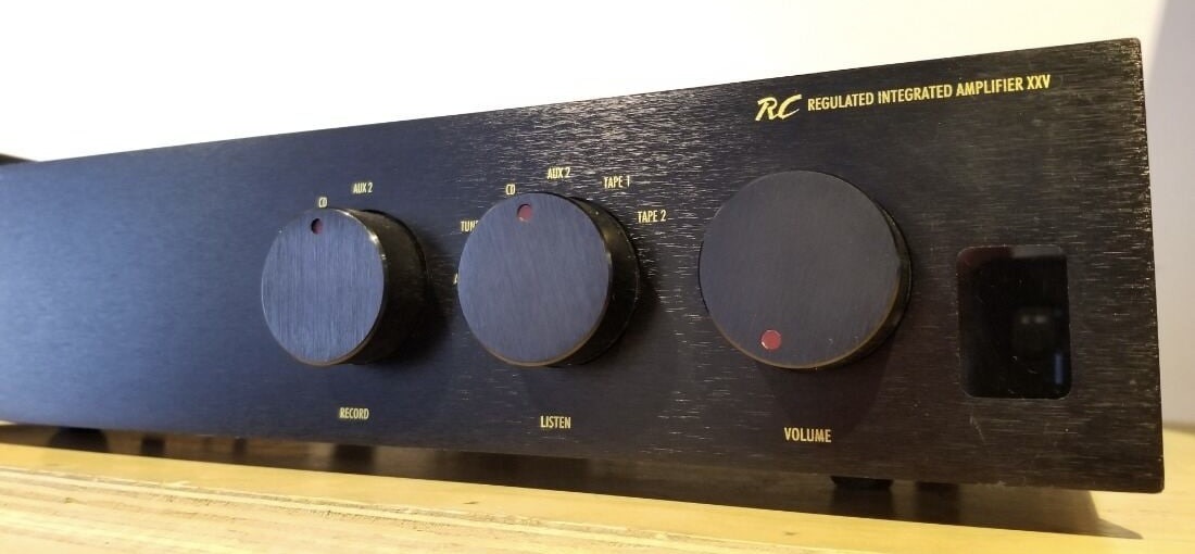

Exposure XXV integrated amp
This one:
55w/channel AB amplifier. One of the many small UK amp makers that has always been of interest but i have never seen & heard. You should have plenty of power but you do want to be careful of the sensitivity a bit.
dave
Dave, (AKA Planet10), thanks for your reply.... Yes that's the amp I have. Old but I still like it!

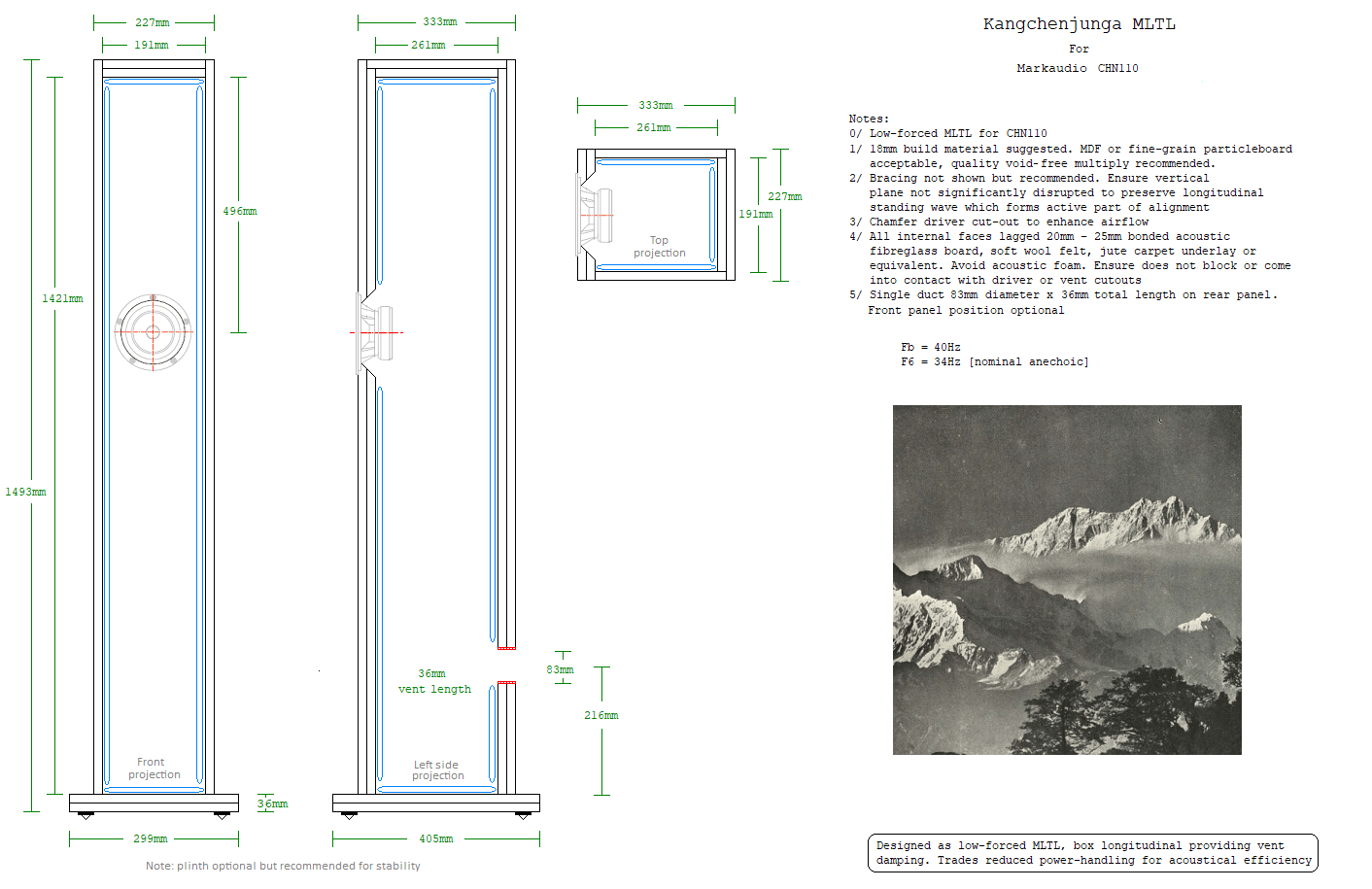

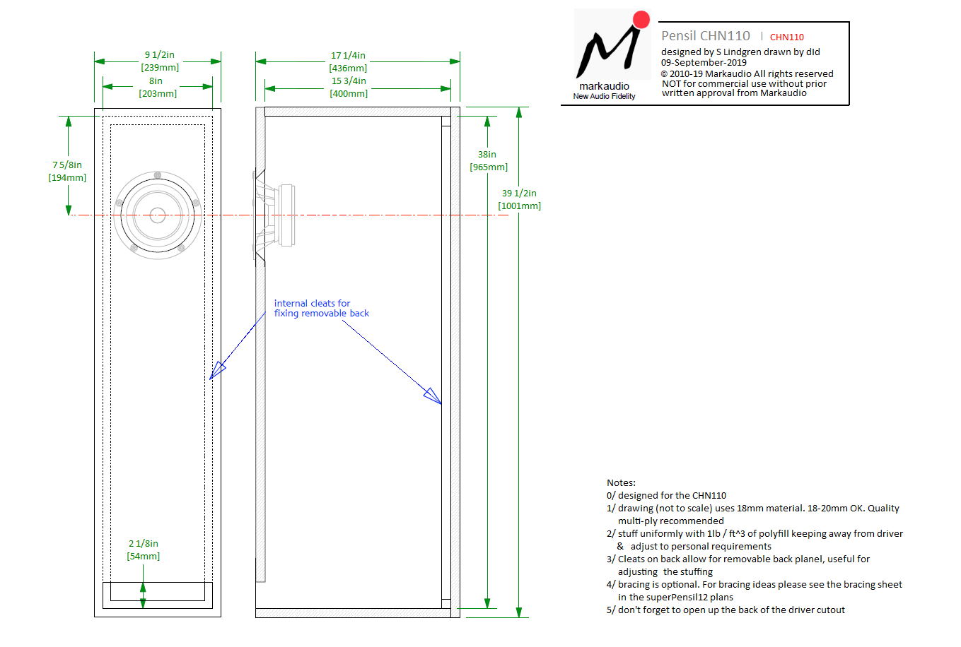

Build a simple FR. A set of Suoer Pensils would likely work well. They were designed for a room similar to your in NZ. But there is a broad choice. CHN-110 is really inexpensive and well behaved option. @waxx has done a goos TL and i am sure Scott @Scottmoose has done some as well. Give you a good handle on what a TL can do and as a side effect of keeping the first experiement pretty painless £££-wise.
heer number of designs out there is vast and I can't really see the wood for the trees
Yes, inmdeed. But a better situation than 3 decades ago when there were but a few saplings growing on a prairie. You are smart to start smaller, with each build (a diy speaker builder rarely stops at. asingle build) you learn somethign about speakers building, speakers, your room, and you.
TLs are a little out of fashion, subs are in but something
Almost every tower bass reflex loudspeaker is actually an ML-TL in disguise. TLs are also big & heavy (typically) and expensive to ship … especially impactful who skimp on box material (ie use MDF) and th distributor and dealer (and the punter off the street in the end) pay the shipping. Since Y2K and the apperance of acurate quarter-wave modelers (ie TL, voigt, horns) a whole new surge of TL designs have come from diyers. Baby Labs, microTowers on the small end up to huge monsters.
When you have a better idea of where you are and what questions to ask, pick something interesting and jump. Beware analysis paralysis… you can try to absorb the disparate views and experiences of many members, but you will just get confused without knowing more.
Here ar esketches for the Pensil and a tall one (different traget alignments).
If you end up likeing teh sound but just need more there is a twin one and even a quad (would need to stand way out in the room (1970s EPI Super Tower the inspiration)
It has been show, (ref Toole, Geddes) that mulltiple woofers below 80-100 Hz are the most effective way to deal with the typical bass room modes that come with shoe box shaped rooms. You have a vault, big, and lots of windows to tame the bass right off the bat so the experiment of a TL that hits 25-30 Hz can tell you a lot about your room.
