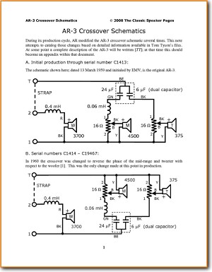

Hi all. Looking for recommendations on who can restore a pair of AR3 speakers. I live in Tucson AZ and I'm not really a DIYer, but thought I could get some useful advice. Tweeters, mid-range and woofers all work, and in spite of their age the foam on the woofers have no visible cracks and still seem pliable (one woofer was replaced about 25 years ago). Some pitches seem to jump out almost as if they were triggering a sympathetic vibration somewhere, especially in the octave just below middle c. I'm sure the speakers are far out of spec after all these years because the sound is muddy and in general not what it used to be.

Something as simple as updating the old capacitors in the crossover circuit could bring the sound back to life.Seems more like unevenness across the sonic spectrum.
The versions of the AR-3 crossover circuit shown in the attachment contain 6uF and 24uF non-polar (NP) capacitors.
However, here's something simple to try first:
The level controls may be making intermittent contact, especially when vibrated by the music. Try turning them through their full range several times to see if that cleans them up.
If this makes a difference, but only temporarily, replacement of the level controls would be on the cards

The level controls on the speakers are the most common problem. They get corroded and then become intermittent.
The next most common problem is that the ferrofluid in the midrange and tweeter has dried up and this adds massive frictional damping to them which gives each a Q of around 0.1.
The caps might be bad, but I really doubt it.
