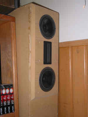

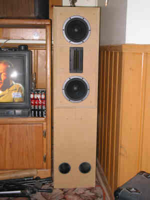

OK, as promised, here are some pics and design details. The cabinets are not finished yet as I am still listening to them.
OK, enough pictures. I used 3/4" MDF from The Home Depot for all walls. The section where the speakers are attached is double thickness MDF. All the drivers are flush mounted. The total volume of the box is about 143 liters. The calculated volume was 130 L, but I added 10% for bracing and internal padding. The external dimensions are 48" tall, 20 5/8" deep, and 11 5/8" inches wide. There are two 3" diameter ports that are 9 7/8" long. For now the x-over is very simple, and not really optimized for the drivers. I used a 4.7 uF cap in series with the tweeter, and a 0.8 mH coil in series withe the two woofers. These values are a bit of a crap-shoot. (I pulled them out of old JBL SR crossovers). I found that wiring the tweeter in inverse polarity I got a smoother response. The woofers are wired in paralell. With this arrangement, the total sensitivity of the speakers is about 92 dB. Yes, these speakers are tube-friendly. I wanted to place the ports in the back, but this just wouldn't work, as the speakers would be placed against a wall. At least I don't need baffle step compensation.🙂
As for the sound, It's pretty damb good. Even with the x-over being so makeshift it sounds pretty good. I can't believe how much bass these things put out. I have to keep reminding myself that there is no subwoofer running. I had a few friends over when I hooked them up, and they all want a pair.
Now for the things I should have done better: I really should have braced the inner walls better. I think I am losing a fair amount of low energy response through the cabinet walls. Making the walls thicker would have helped this also. One thing I plan to do is add some more sound dampening material to the inside of the cabinet walls. I was planning on using something similar to what is used in the car stereo circles to help deaden car panels. On top of this, I will glue carpet tiles to add mass and to help reduce reflections. On top of all of this, I am going to attatch the Auralex 2" pyramid foam that is in the speakers right now. This should help a lot in tightening up the bass. It should also increase the efficiency slightly since I won't be losing so much energy through the walls.
Finally, I am going to sand the boxes down and finish them. I still can't decide between piano black or a nice wood veneer. I am leaning more and more towards black right now.
Anyway, I hope this helps. I am very happy with these speakers, and considering how little they cost to build, I am even happier. They are rather large, but they sound so good that I don't care. See......My son likes them to.
Zach

WOW!! These are some nice speakers! Thanks this is something similar to what I was planning to build except perhaps for the crossover which will need to be of the second order.
Thanks a lot for taking the time to post all this.
For the wall thickness, perhaps you could just add another ½" veneer-core plywood. That would take care of the finish and definitely add rigidity to you walls.
Now I can't wait to get started on mine.
Sébastien

Well done.
Nice work usekgb!
Always good to see another project up & running.
As youve discovered bracing & damping is absolutley critical and can give significant improvements in sound quality.
Your idea of using car sound deadening material is a valid.
I used some in my latest, ongoing project, sandwiched between a layer of ply. Certainly helped reduce the panel/wall vibrations.
Keep us informed of your progress.
