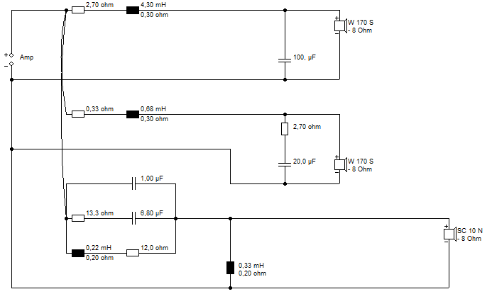

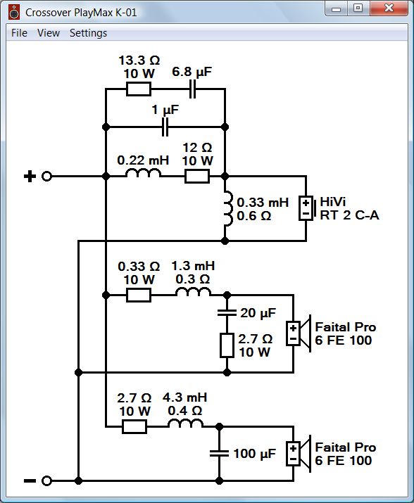

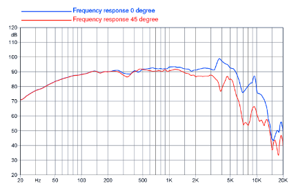

This design proposal looks strange when you calculate that two of the faitals with baffle step loss accounted for, gives spl just about close to hivi tweeter so there seems no particular reason to perform woofer attenuation for that matter.

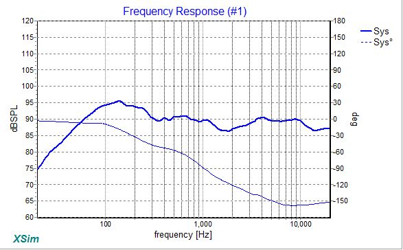

I agree but a dip in frequency is not something that we should design for but isnt a flat response more beneficial?
The series resistor in the woofer filter is indeed unusual, and a resistor bypassing the tweeter capacitor is always a bad idea. The reason probably is to prevent the impedance from going too low and to do some response shaping in the bass as well.

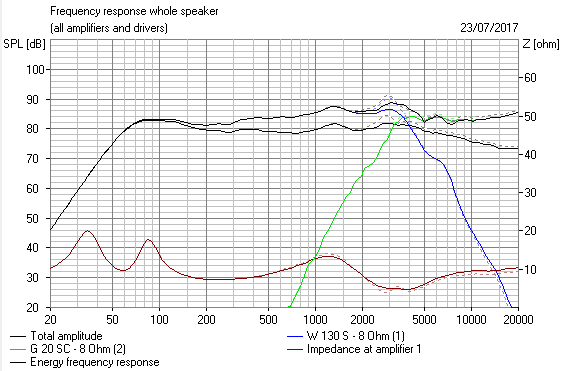

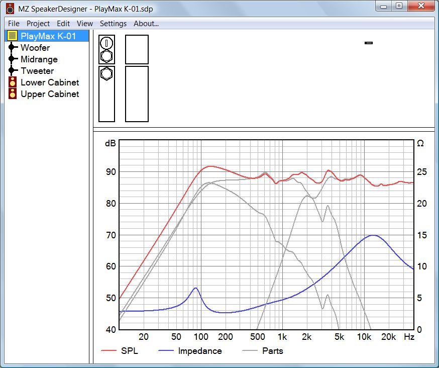

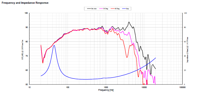

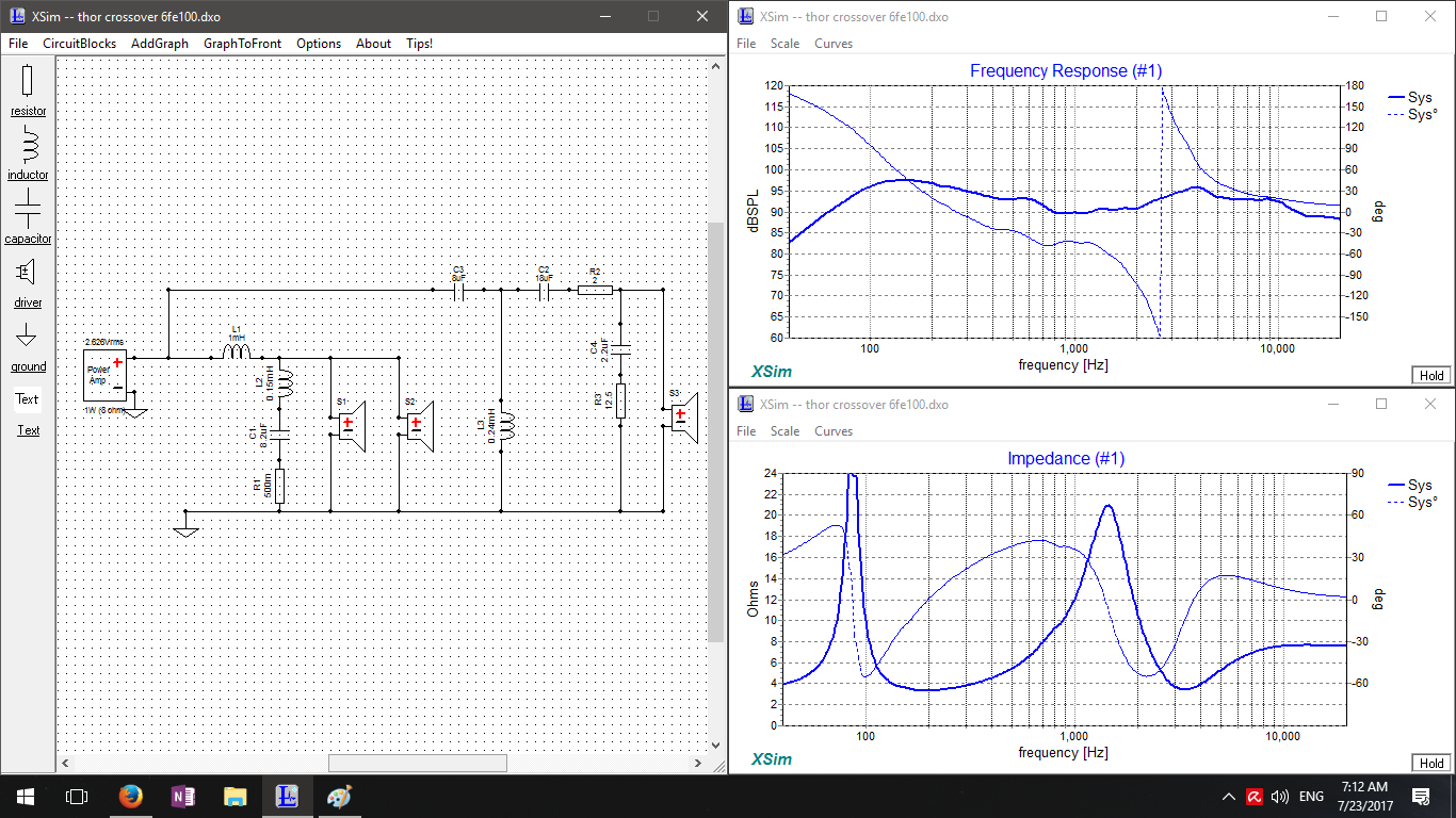

I don't get that dip in my simulation of the PlayMax K-01 using the woofer measurements from diBirama: Faital Pro 6FE100

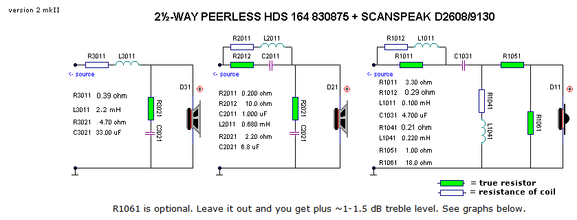

I looked at the FaitalPro 6FE100 and thought I've seen that sort of thing before. It's very similar to the Peerless Nomex 164 aka 830875.
PEERLESS-NOMEX-164
A little more efficient at 90dB, and more of a 0.5 cu feet closed box driver IMO. You usually notch speakers like this at about 4.5kHz= 6uF/0.2mH/2.2R shunt or a RC tank across the bass coil, which is what Troels does to the mid in a 2.5 way.
I think we decided the Troels Nomex 164 could be improved, as it goes. I think you are better off using a MTM style filter. Even if it's laid out TMM.

I've just increase R1051 to 1.2 ohms and lowered the box tuning to 40 hz from the original design by TG.
They are sounding VERY good IMHO 🙂
Construction d'enceintes "Nomex 164" - Le blog de pguerin

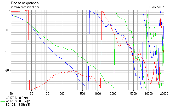

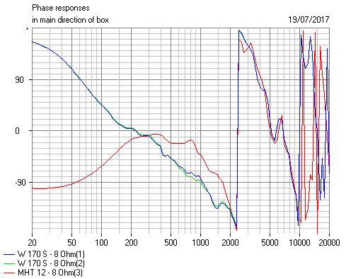

I'm not surprised about inverting the tweeter polarity. I just simmed your filter. The phase for your tweeter circuit is all over the place! I see no merit in that circuit whatsoever. It's a complete muddle IMO. Troels' circuit looks much nearer where you want to be.

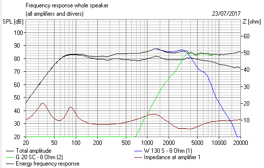

Here's the sim with any old 6" woofers and 1" tweeter on positive polarity. It's a dreadful tweeter circuit. No real rolloff, and terrible phase. Whatever were you thinking of! 😱
I appreciate the planar tweeter is something else: HiVi RT2C-A Planar Isodynamic Tweeter
But basic principles still apply. I think you must lose the 0.22mH and 12R. The 1uF is evidently just a bit of top end lift.

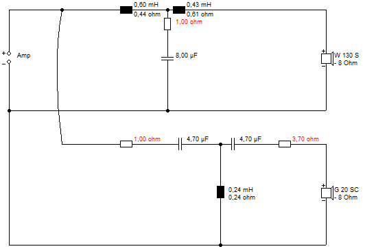

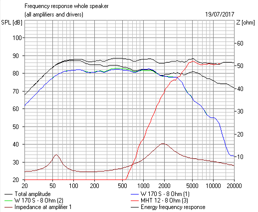

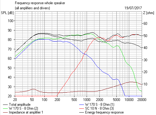

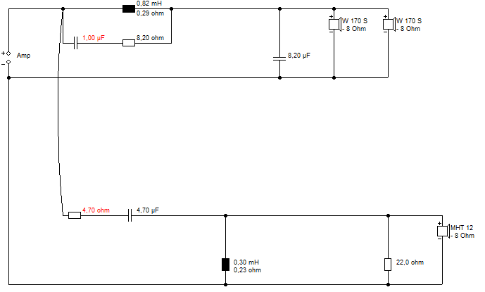

What I would try with this Naresh, is a simple circuit. Below.
The only real variables are the notch point, here 6kHz on the Visaton W170S. Which can be taken down to 4.5 or 5kHz with, say, a 1.2uF or 1.5uF cap instead of the 1uF.
And adjust tweeter level. It all works nicely as a near LR2. It's really not far away from Joe D'Appolito's SEAS Thor design, albeit with tidier woofers. THOR

Ok I will try it.

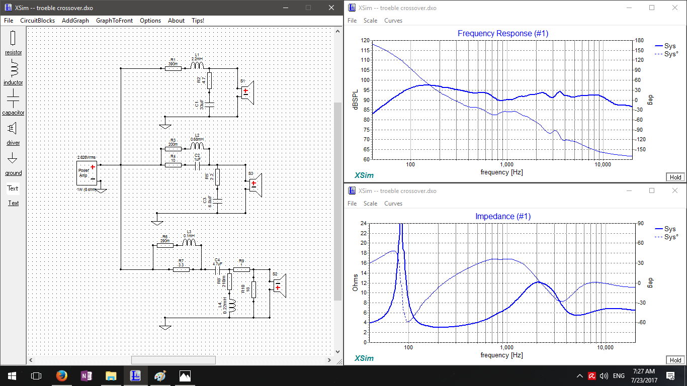

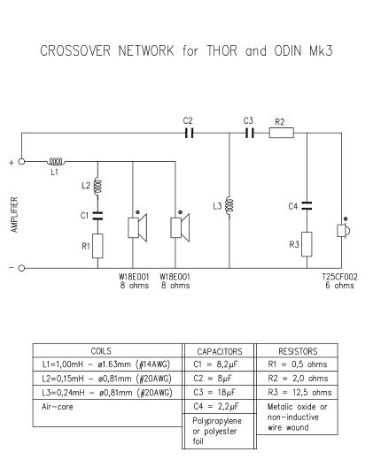

Crossover design

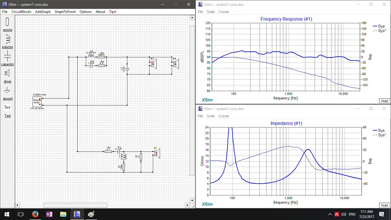

I have some screenshots of the different model of crossovers.
Which one will you all recommend to go with?
the system 7 crossover looks the best for frequency response
impedance looks well controlled in the playmax cross except for at high frequencies

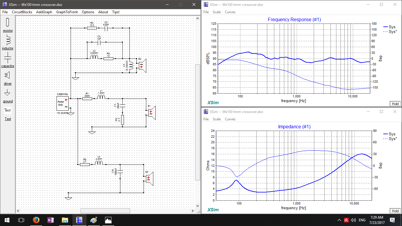

troeble cross
THOR crossover, I have found when polarity on the tweeter is reversed there is no dip in frequency response, what does this mean?
There's at least a dozen ways to design a crossover that does similar things.
You usually end up around 2.5kHz on a 6" bass. A TMM 2.5 way has very deep bass, maybe too much because you end up with 6dB of bafflestep.
MTM filters can be easier.
Tony Gee's Proteus tries two different filters:
Humble Homemade Hifi - Archive
It's interesting that you make the SEAS Thor MTM to be a BW3, because that is the filter that can use either polarity, being 90 degree phase. In fact Joe D'Appolito advocated BW3 for an MTM to get the lobe horizontal.
Here's another BW3. You can see the 90 degree phase.
If we are lucky, flipping polarity on the tweeter should preserve the frequency response. Not create the deep null of a LR2 or LR4. Below. 😎

Im going to build a simple 2way with the 6FE100 in tlines before I attempt the MTM/TMM build. I believe I need to get my feet wet before attempting more challenging builds.
I have narrowed my choices of tweeter on ability to play low and off axis response to 15khz. My choices are:-
