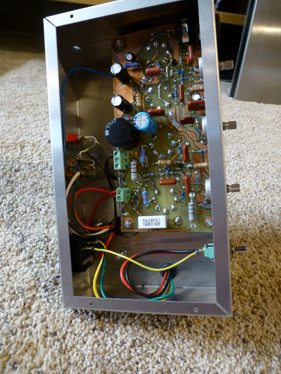

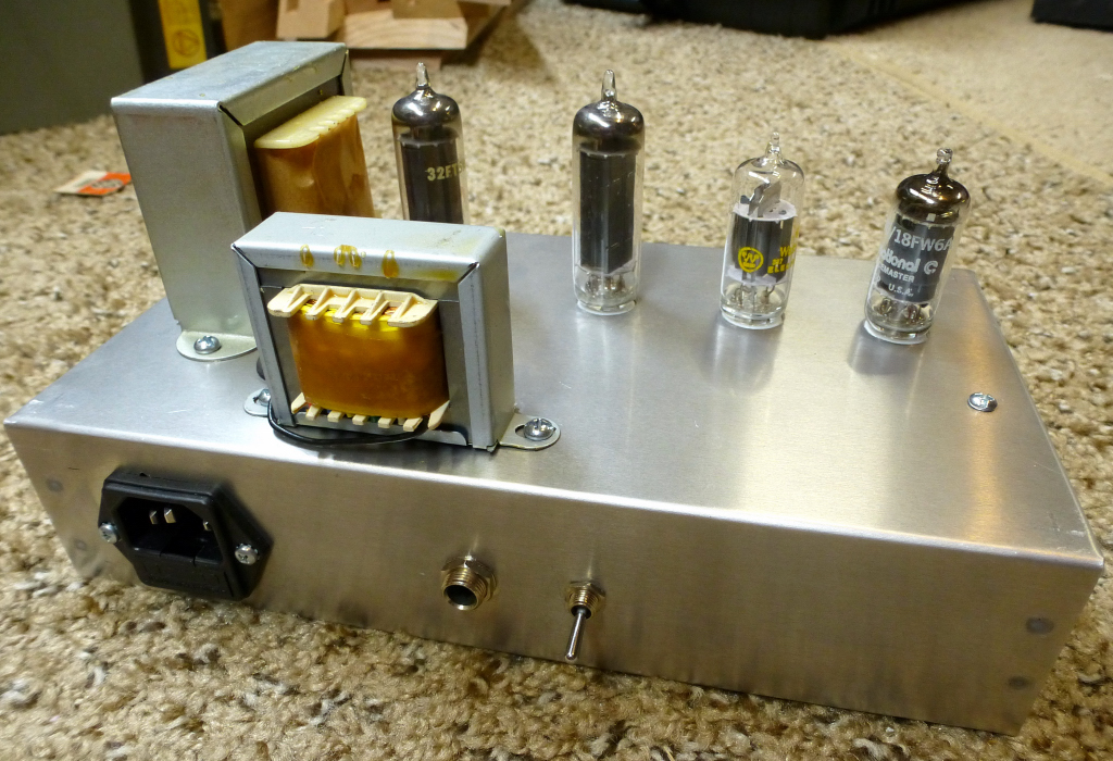

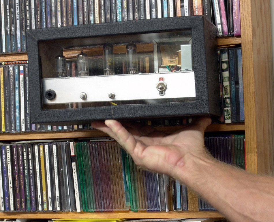

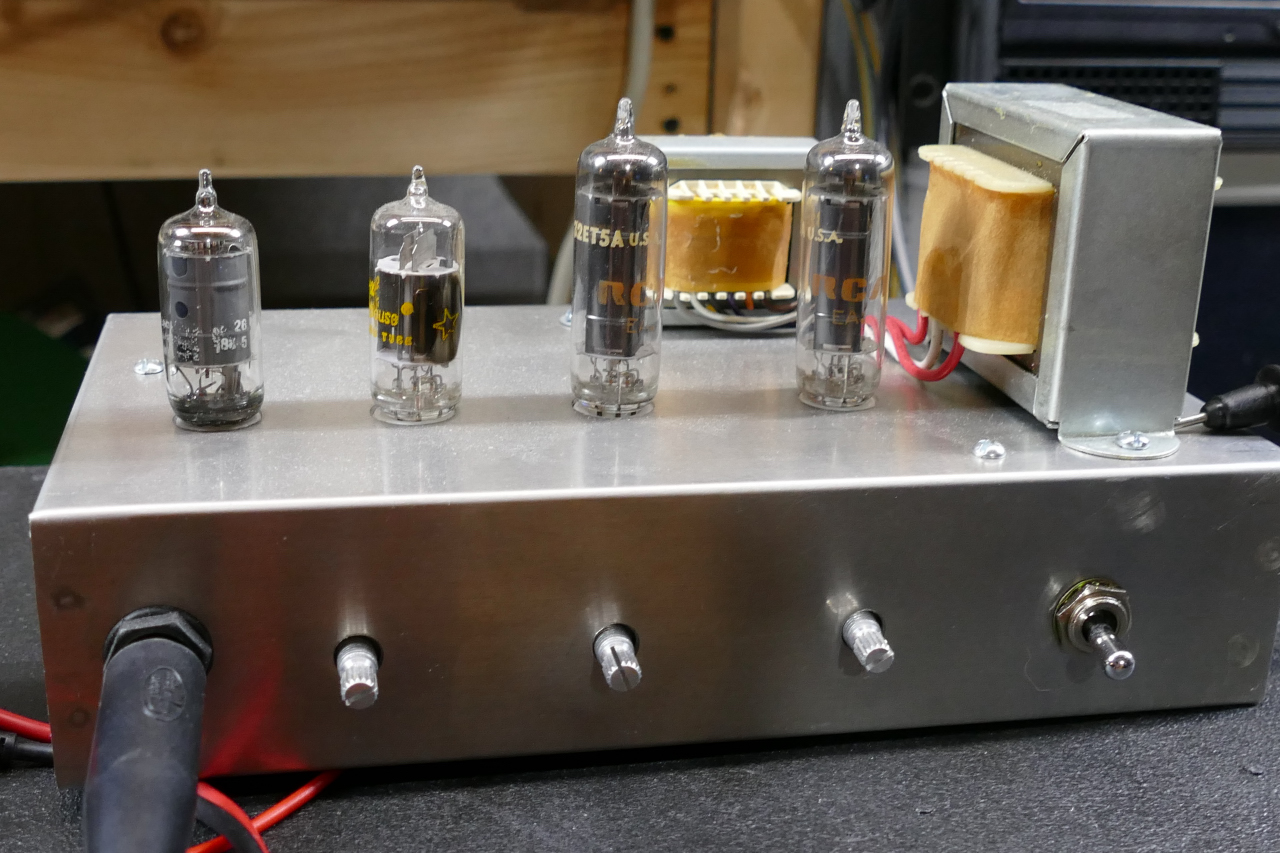

I made the amp in the picture above for the Hundred Buck Amp Challenge. During that adventure there was some heated debate about what constitutes a "tube amp." The loudest objector in the bunch stated that there should not be ANY silicon in the signal path even though this was agreed to in the rules before the challenge started.
Therefore, the amp sitting on my hand has diodes for the rectifier, and no other active parts except tubes. It worked, but just didn't SCREAM, so it wound up in a box and, that box got stuffed in a warehouse during the time period where my career ended, a 1200 mile move ensued, and "retirement" started.

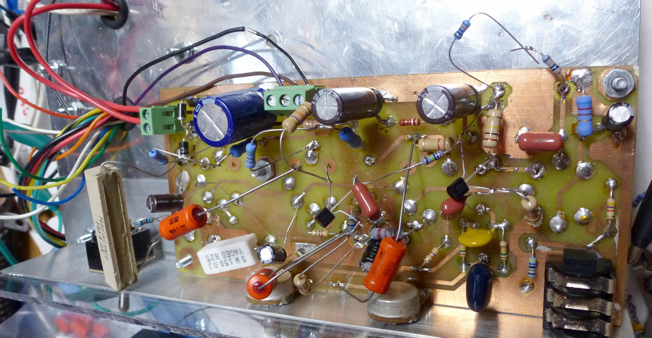

Several years later I found the amp, and fired it up.....BORING, so I ripped it apart. I reinvented the circuit with flying parts. The result is in the first picture. Now it works great, makes more power, 3 watts clean, over 4 cranked, but doesn't quite fit back in the box.....So
I made a new PC board and made a new amp with nice parts and a Hammond chassis. Pictures....
It still looks like that today....never did stuff it back in the box. It can be seen here sitting on top of a DIY speaker cabinet above the third fret.

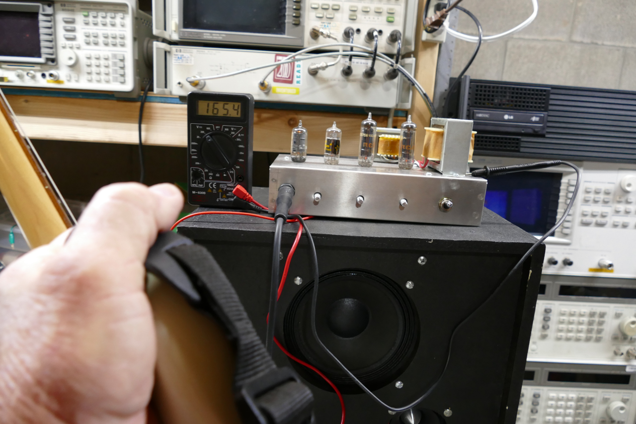

A little over a year ago there was a dispute about my actual B+ voltage, so I wired a meter from OPT CT to ground which displayed almost 170 volts at idle, and 165.4 volts when doing a trainwreck style feedback with all knobs dimed. Pictures of meter, and the $16 power transformer that couldn't possibly produce 165 volts loaded.
Schematic included.

Tubelab_com what are the ohm values of the 3 pots and what are the part numbers for Q1 and Q2 in your posted schematic?
The pots are all 1 MEG and the mosfets are LND150N3's. The LND150N3's are rather scarce right now. The mosfets should be a depletion mode device, so that rules out most common mosfets. A DN2535N3 or DN2540N3 should work too.
It is a pentode with a "gyrator" load whose impedance is determined by the pot. At full crank the pentode is working into a plate load impedance higher than 1 meg. This gives SLO-100 kind of gain in a single stage. A multigrid tube will become highly microphonic at these gain settings so a combo amp is out of the question and setting the head on top of the speaker isn't a good idea either. Someone suggested putting the triode stage before the pentode which might be a good idea but I have not tried it. I have been using this amp as is for about 3 years now with no issues, so I'm hesitant to mess with it.

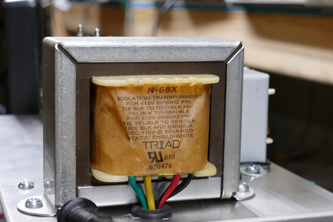

For those into a more traditional power supply the 18FW6 is just an 18 volt 6AU6, the 18FY6 is an 18 volt 6AV6 and the output tubes could be any 6 volt pentode. A pair of 6V6GT's would make for a good bluesy sound while a pair of EL84's would rock. I would prefer a pair of 6W6's for maximum crank!
