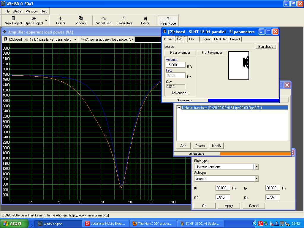

I have just re-modelled in WinISD because I have learnt on another forum that WinISD sets your box 'leakiness' (the QI value) to 10 ('very leaky', the Red line) whereas I would presume that most boxes are much nearer a QI value of 50 ('no leaks'), therefore I have amended this value and re-graphed, as attached below.
Having done so I have seen the cone excursion drop drastically from the original modelled response, and the drivers should hopefully now remain within XMax all the way down to 3Hz, so they should be safe from over-excursion and always within XMech, even with 5kw of power!
I guess the main concern now will be cooking voicecoils from extended ultra-low bass scenes in movies...

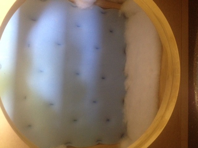

I also played with the QA (interior stuffing) values as well - going from minimal fill (QA value of 80, the Green line) to lined walls (QA of 20, the Blue line) to totally stuffed (QA of 5, the Yellow line) has reduced the box Q from 0.841, to 0.815, and then down to 0.726 (so much nearer to 0.707) but I am a little worried that too much stuffing will make it sound 'muffled'?
I may work to the Blue line and line the walls fairly well, while making sure the box is as airtight as possible!
Any comments or thoughts are gratefully received 🙂 I am pretty happy with the results so just want some reassurance really! lol

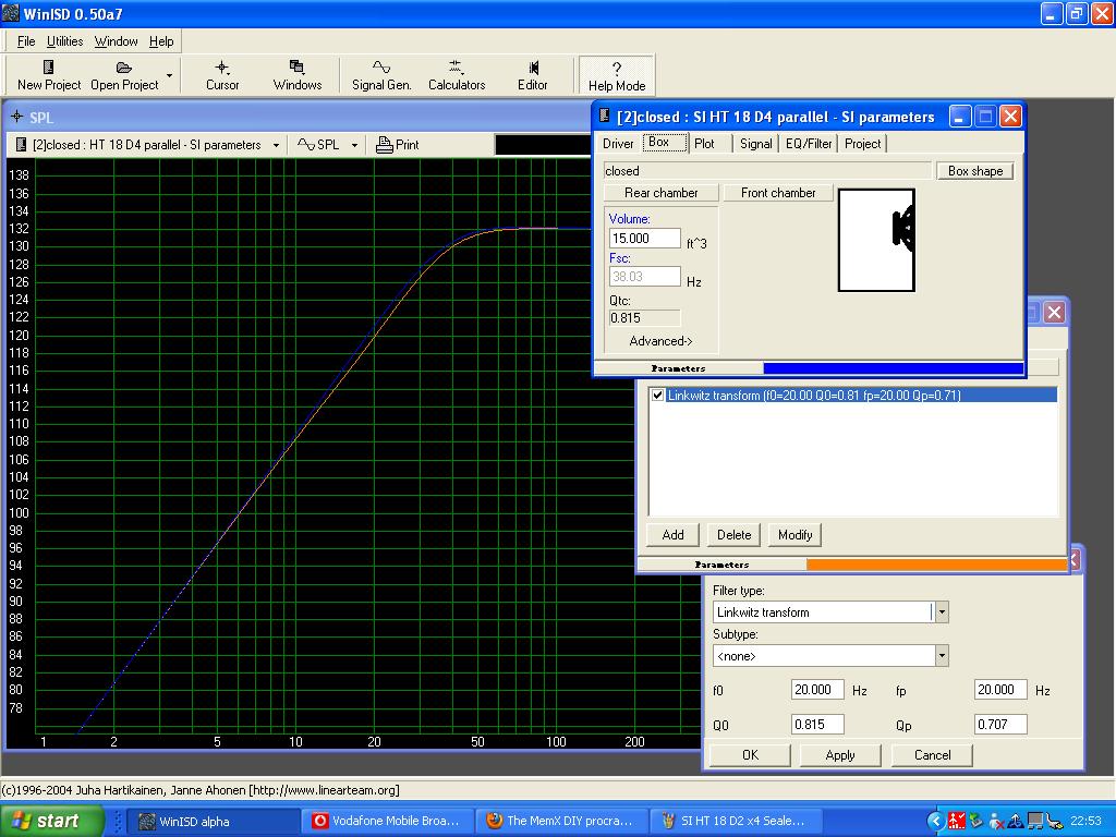

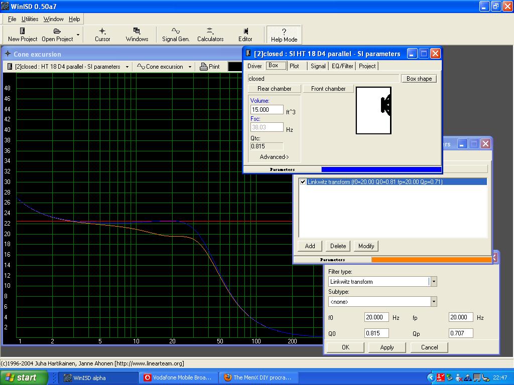

Hey all 🙂
Just a quick update!

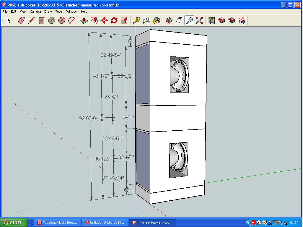

I've played with Sketchup and you can see on the attached my proposed stacking at 1/4 and 3/4 heights, which I think I have read will help with some room modes, hopefully? 😕
I also played with the Linkwitz Transformer section of WinISD and it looks like if I implement an LT using a MiniDSP or similar, I should be able to reduce current draw and cone excursion (and hence improve driver safety) at the expense of only a couple of dB, which I hopefully wouldn't notice. 🙂
The amp rolloff is -3dB at 5Hz so running these with no filters or anything, I should only be constrained by the amp and any other signal chain rolloff, and I shouldn't ever be pulling the full 1250w to each driver the amp could give (hopefully).
Hopefully that's all ok, any input is more than welcome! 🙂

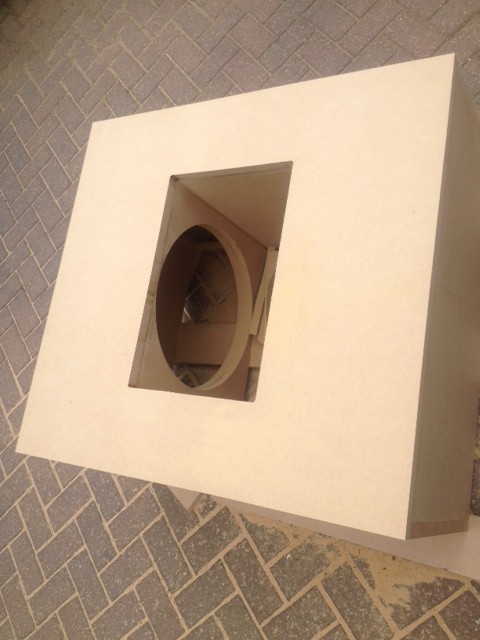

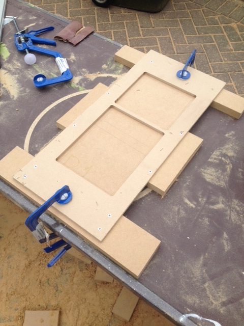

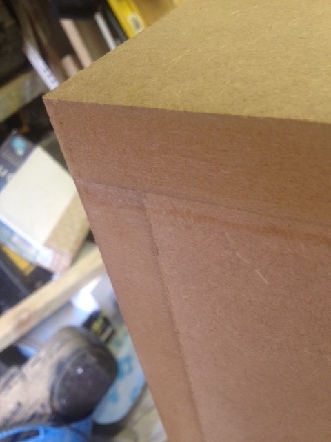

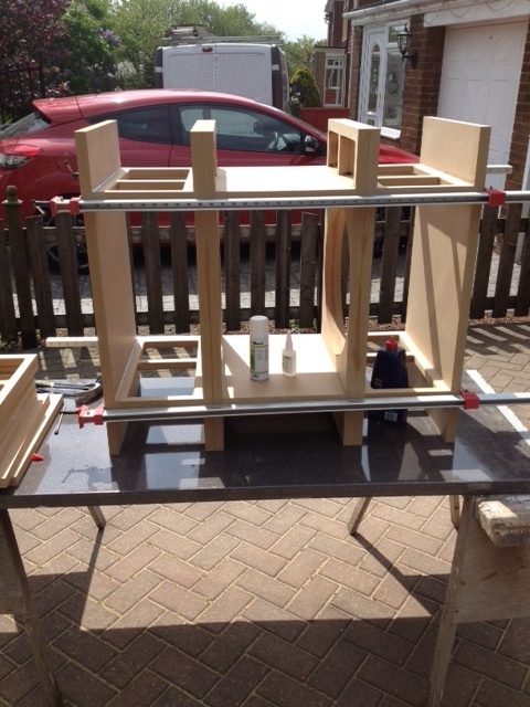

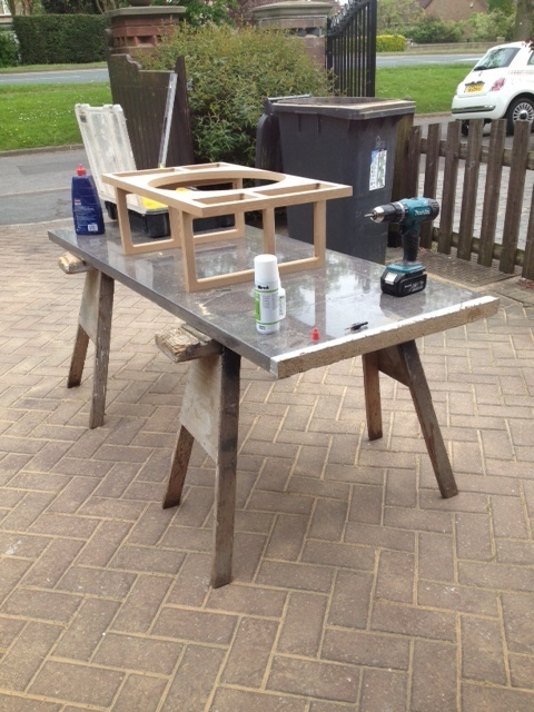

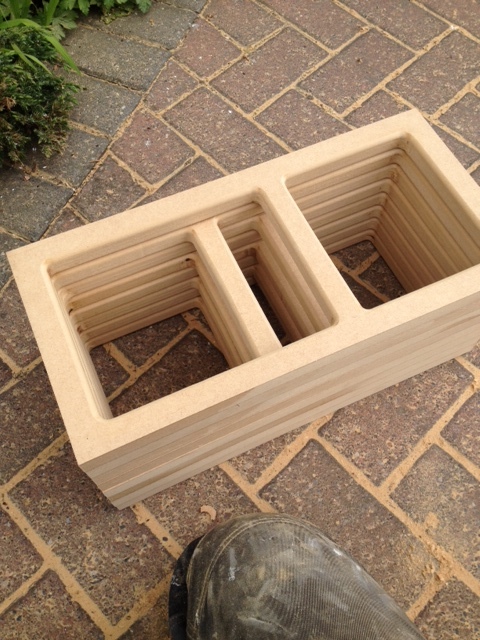

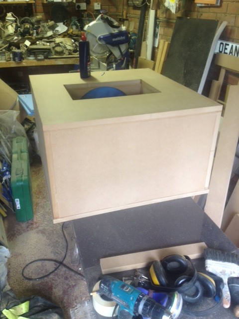

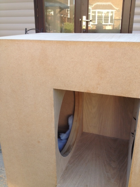

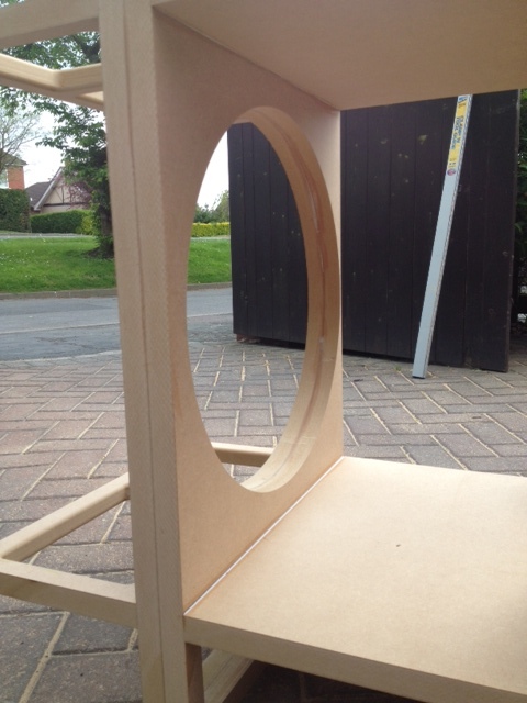

My box builder guy has made a start on the boxes - going from the amount of MDF dust, I'm glad I didn't attempt this in my apartment!

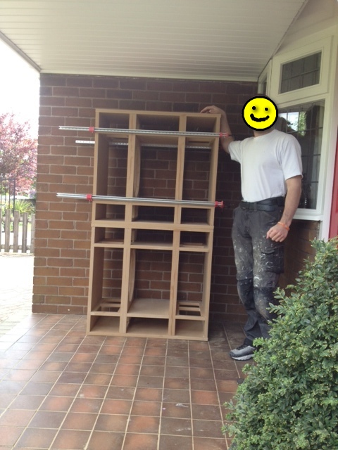

Last pic for the moment 🙂
There will be additional risers at the top, bottom and in the middle, which should locate the centreline of the drivers at quarter and three-quarter heights of the room (which I believe is a good thing? 😱)

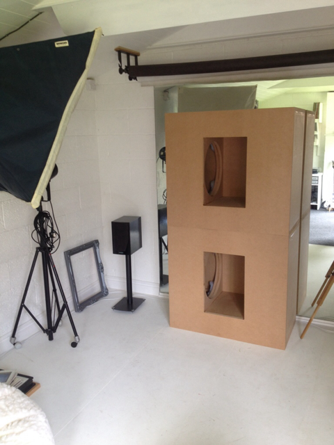

Anyway, as I was trying to say, each 2-driver subwoofer has approximately 7.5 cubic feet of internal space. I left the bracing up to the guy building it so I haven’t calculated it, but as AVS Forum has several large SI-driver based builds running with c.3.5 to 4 cubic feet per driver and similar, c.1kw, power, whether I end up a little over or under my 7.5cuft target should not matter too much 🙂

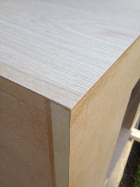

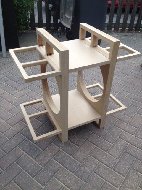

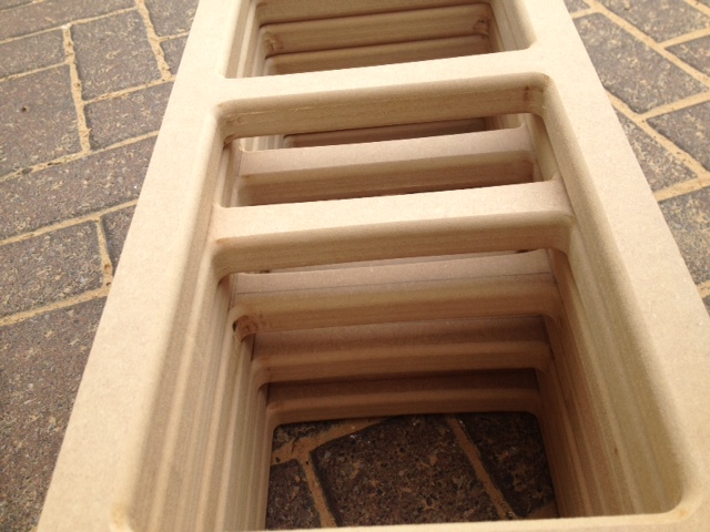

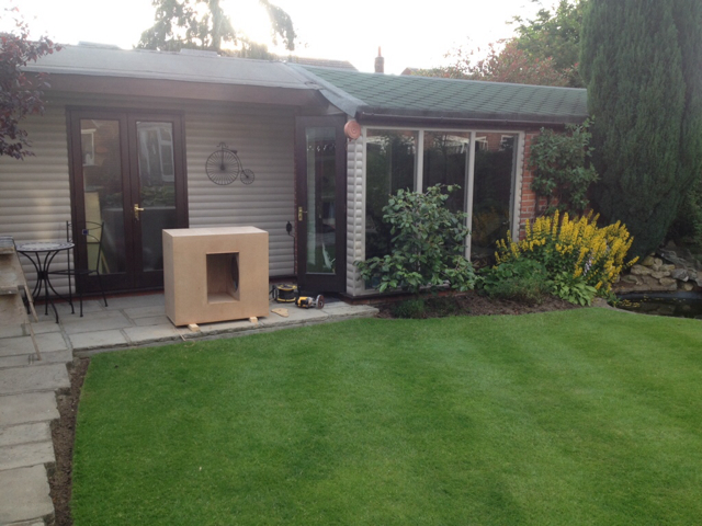

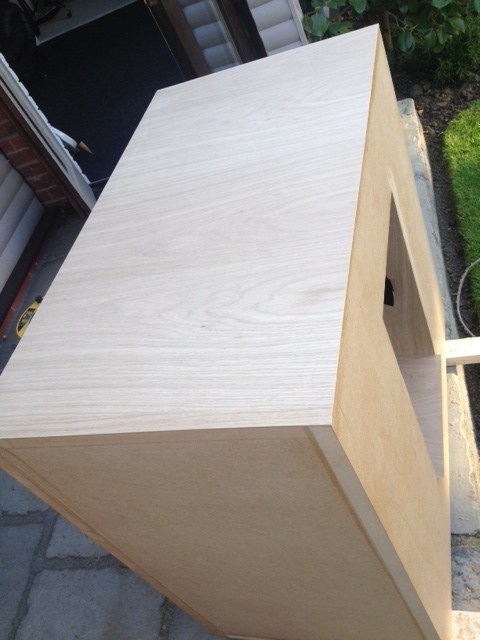

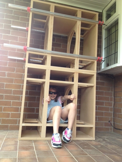

Couple more pics, progress is coming along nicely.
The guy building them sent me the attached pic of the first one in his garden. Is it bad that I think they look reasonably small...?
