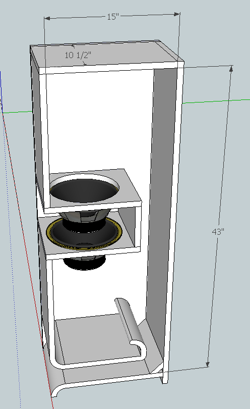

My current design looks a bit like this:
(taken from this thread: http://www.diyaudio.com/forums/subwoofers/239503-10-ppsl-vented-enclosure-design-help.html)
but I would like to build a sealed version instead.

I would suggest doing a sealed PPSL with a Linkwitz transform.
I think the ports would be hard to make work properly with those drivers.

Current workings seem to suggest a minimum possible plenum size of 19.5" wide by 13 or 14" tall (to account for driver depth + XMech) by c.20" deep (width of the box) assuming I mount them horizontally. Assuming the 'port' is the same 19.5"x14", that seems large!

with those specs a PPSL would be HUGE
I would suggest two ordinary closed boxes
and I really doubt you will need any EQ at all

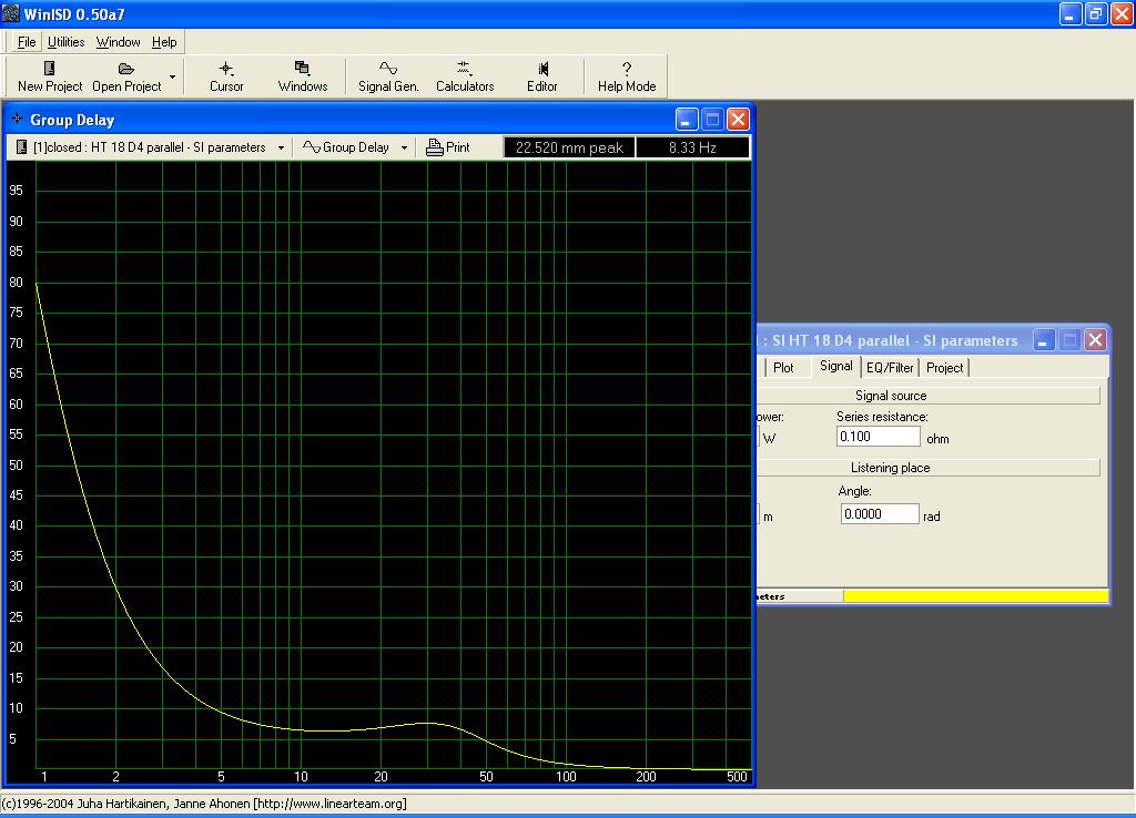

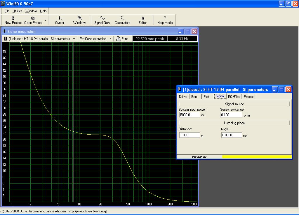

Oops, perhaps if I attach the WinISD graphs for the sealed PPSL at 15 cubic feet with 5000w like I said I would...
415430d1375920918-memx-diy-procrastination-thread-4-si18s-11-cubic-feet-si-ht-18-d4-x4-sealed-15.jpg133.6 KB · Views: 1,199
415431d1375920946-memx-diy-procrastination-thread-4-si18s-11-cubic-feet-si-ht-18-d4-x4-sealed-15.jpg125.9 KB · Views: 1,191
415432d1375920961-memx-diy-procrastination-thread-4-si18s-11-cubic-feet-si-ht-18-d4-x4-sealed-15.jpg115.8 KB · Views: 1,173

I haven't done the calculations for Sd😛ort size ratios yet so I'm not sure how they work out, but perhaps I should try to aim for 2:1 to try to minimise pressure in the plenum at very low Hz but still have a boost, going from what's been said in the PPSL thread about increasing output with close coupling and ~3:1 ratios?
I am definitely planning to make a Sealed box and not a Ported box 🙂 I want to be able to reach single digits (or try to reach single digits!) without risk of bottoming drivers under a port tuning frequency. Not only that, I only have ~21 cubic feet of room for both dual boxes, including the plenums!
I work the plenums out to be ~3 cubic feet each, which should leave me with about 7 cubic feet internal volume for two drivers in each box. The WinISD graphs I posted on the previous page seem to suggest XMax wouldn't be reached until it got down to about 7Hz or 8Hz with that size box and the amount of power I'm planning to use (the CV5000 is seemingly pretty accurately rated at 5000w RMS) so hopefully I will have protected them that way, and also through signal chain roll-off reducing output at the lowest frequencies.
It is quite a lot of power, though, granted... but I have Audyssey XT32 EQ on my Onkyo 818 AVR, so I will only be using a fraction of the power most of the time because it EQs to something like 105dB peaks rather than the crazy 130dB+ that it seems could be achieved if I really cranked the amp gain up! If I have issues with boominess or peaks then I will look at a MiniDSP or similar.
I hear what you are saying about the volume in an Apartment 😉 Fortunately it is constructed with solid concrete blocks and seems to be very soundproofed! I currently have an SVS PB12-Plus/2 (2x12", ~900w RMS) that I run up to about -6 on the AVR when I watch films, and so far I've not had any complaints. I always make sure that I only really turn it up when the downstairs neighbours are out (which they are quite a lot because they are young) and I don't very often listen to music at loud volumes. Any bass that does travel is relatively short-lived and random, from sound effects in films rather than a repetitive bass beat of music, so hopefully that is not too annoying for the neighbours!
I am hopeful that music and movie content will be a lot less stressful than Sinewaves and that the drivers will therefore be ok - some members on another forum are using around 1100w RMS into these drivers with no real reported problems so far, so I will cross my fingers 🙂
Make sure, as mentioned in that thread, to rotate the manifold 90 degrees.
