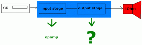

Looking for very simple output driver.
I'm trying to design a very simple amplifier. I want 5W output power into 4 Ohm load. I decided to use an opamp as input stage for voltage gain. But I don't know how to build an output stage that can supply enough current. I want to use mos transistors or jfets's. The less components the better and I don't mind crappy sound. :)
When you supply me an output stage could you explain the working to me?
I added an image for better understanding.

Why not use a buffer ic ?
opamp-buffer-output stage.
A BB BUF634P you can buy at marktplaats for 2 euro.
An output stage you can build with an IRF630 and a IRF9630. and a couple of resistors.
These too can be bought at marktplaats for next to nothin.
They'll go up to 50 watts safely, and not even with crappy sound,
for like 5 euro per channel.

Simplest approach (unless you go class A which you obviously want to avoid) would be a unity-gain-stable IC like the OPAxxx-series.
Then of course the opamp in front would be kind of "too much" really or you could switch it as input buffer as some people would advise to.
...want at least 60% efficiency.
...only want to add some capacitors, resistors and FETS/ MOSFETS.
rather tight corner you’ve painted yourself into with these requirements
5W into 4 Ohms ~ 6.3 V amplitude, ideal class B is only 70% efficient when swinging 100% of the supply voltage on the load
a 60% efficiency requirement means with a "simple" (non-switching) output your output stage must swing to less than ~700mV of the rails and the power supply must be really close to +/- 7 V
this is possible with a complementary common source output but reliable biasing of the output devices probably takes the required circuitry beyond "really simple"
