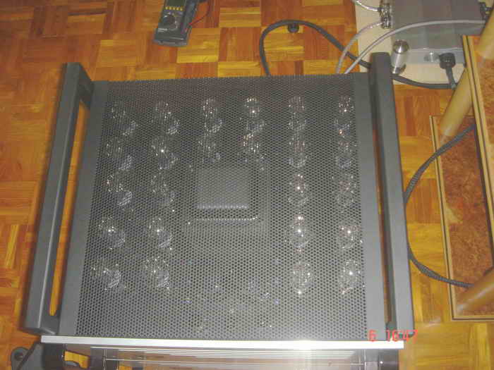

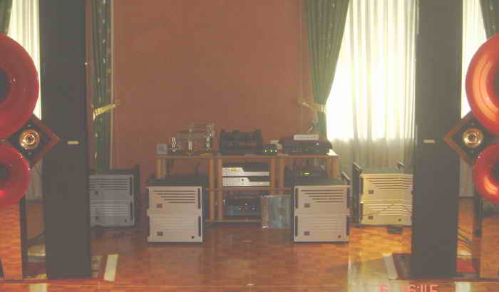

How about use 96pcs (close to 100 pcs) of Western Electric 300B?
This pair of speaker (2pcs, left and right) is powered by 4 amp blocks.
96 x300B
lumanauw said:
Each amp block has this : 24 of Western Electric 300B's. That means total of 96 of 300B's powering a pair of speaker 😀
I'll check with my energy company if i can do that 🙂
It's great, but seems somewhat unpracticle and for sure is beyond my budget.
However... i am truely impressed !!
/Mark
