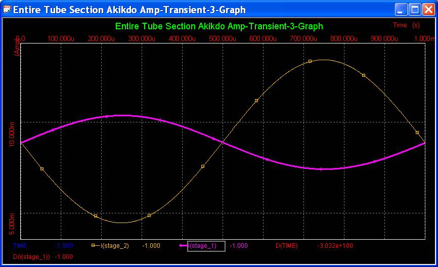

The Aikido stages operate in antiphase, allowing much of the signal current to cancel (depends on tube selection). See image of current simulation for stage 1 (purple) and stage 2 (yellow) at 1kHz using 6CG7s into a 5k load. After cancellation, the power supply sees only 3mA of ripple current (according to simulation). My Aikido operates into a 40k load, therefore, my currents are correspondingly lower by a factor of 8.
Looking at the impedance of the power supply, the output capacitor easily passes the current ripple. However, the choke acts as very high impedance and stops it cold. The output capacitor of the power supply is important, as with any power supply design, as it is the first line of defense against signal-induced current ripple.
