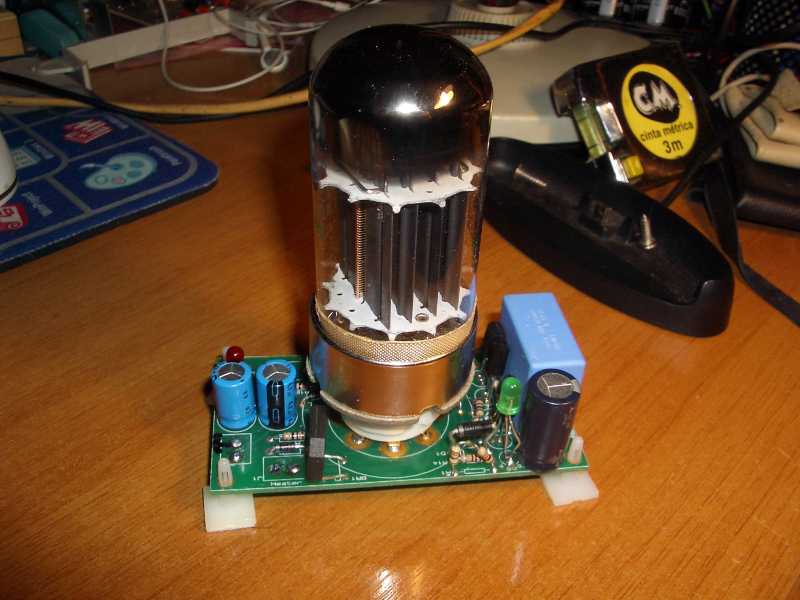

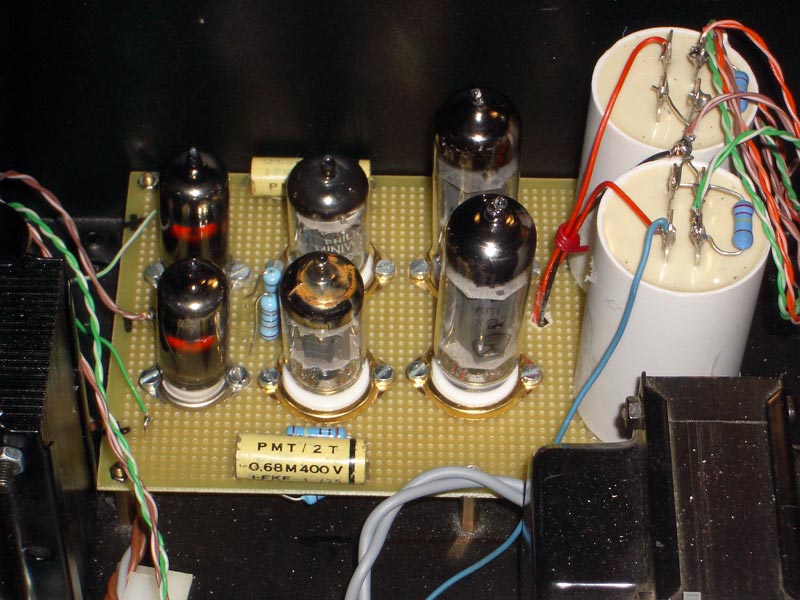

About supply, to my Aikido I tried two tube regulators.
The first one is the quieter about noise, but the second is more musically! The rectified is tube, no electrolitic capacitors, and two inductors (dual mono). I'll now try to mount two salas shunt regulators.
Right now, I use the second regulator, with gas tube stabilizer, a bit noisy, but more musical
