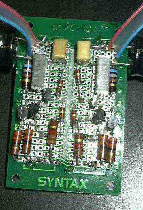

MC Section for Pearl
If you like the sound of the Pearl, why not add a gain stage to the input. Several others have done it with good results. The input stage of the Pearl is a great circuit to start with.
Mine is a pair of matched 2SK170BL, each sitting on a 22 ohm resistor. The pair is cascoded with a ZTX450.
Power comes off the Q5 second regulator of the Pearl. Through a 10 mH choke, 1000 ufd cap, then 700 ohm resitor to the ZTX450. The output is cap coupled with a 1 ufd stacked film and foil cap into the 47K input of the Pearl. The board fits right in the back of the case.
The sound is much better than it was running a pair of AN UK step up transformers. I think the MC stepups work better with tube phono than with solid state. I think it has to do with drive current. When you step up the voltage, the current gets stepped down. The resulting current cannot drive the combined gate capacitance of the 4 2SK170BL in the Pearl.

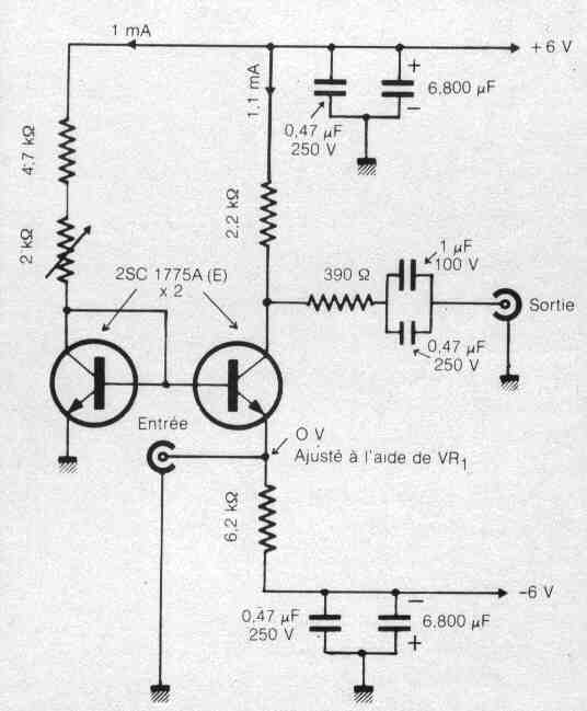

Hi Frank,
I may try your designe eventualy. But first, your head amp and the Hiraga head amp! I'll let you know which one I like the most!
