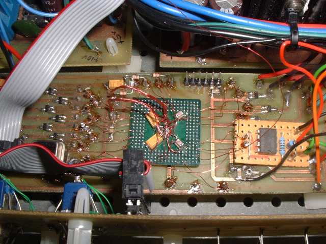

Hello,
I’d be interested to hear more about you project as I’ve recently been considering something similar myself, although implemented more in programmable logic.
I’ve recently started using the Lattice 5000MX series CPLD devices at work and the 512 macrocell parts that I use have up to 256 Kbits of memory that can be configured however you like. I’m thinking about implementing a buffer in dual port RAM so the transport clocks the data in and I use an VCXO (or OCXO) to clock it out. I believe this method is used by Chord Electronics in their DAC64 product:
http://195.40.133.90/website/products/dac64.htm
The Lattice devices also have two onboard PLLs with jitter spec’ed at something like 250ps max although they did measure more like 100ps in the lab (application is 20MHz in -> 66MHz out). Not too great really….
The only downside is that most CPLDs and FPGAs are only available in surface mount QFP and BGA packages which make them hard to mount onto a PCB. Hard, but not impossible…..
The pic (assuming it attaches - not shown in preview!) is a Xilinx CPLD which I use in my pre-amp for various duties but mainly for decoding the Sony SIRCS remote control protocol. I did this so that I could use an old Sony TV remote to control volume, source selection, on/off etc. It's a 272-pin BGA dead-beetled and wired to the main PCB. Clock is only 4MHz.
Anyway, I haven’t given my DAC project too much thought so I’m not sure how feasible it is. I’m kind of reluctant to commit to your project (due to a complete lack of time!) but let me know how much glue you need (and what PLD devices you’re considering) and I’ll try to help.
