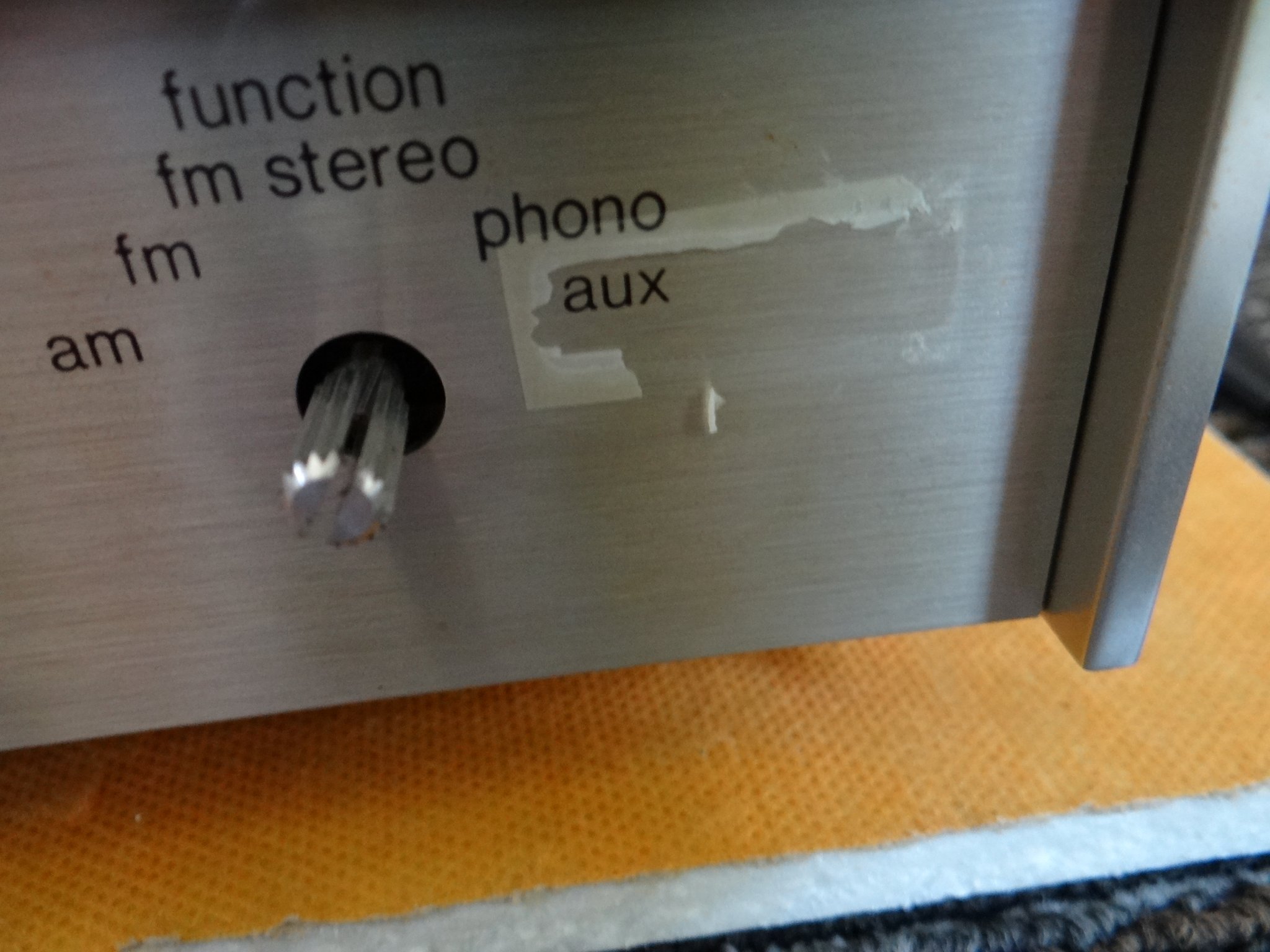

looking for safest way to remove dried tape
I just purchased a 50 year old HK receiver at an estate sale
it looks like for the past 30 years there was tape on the front panel
I was wanting to know how others have removed this tape without damaging the plastic or metal on the front panel. I can think of many ways but not sure which would be safe. I dont want to destroy the finish of the front panel
the picures are samples, there is more than just two pieces to remove

First try simple dishwashing soap and water. Then go on to stronger things, like isopropyl alcohol, vinegar, etc.
Some lettering can be removed by some solvents, so try on a small area first.
