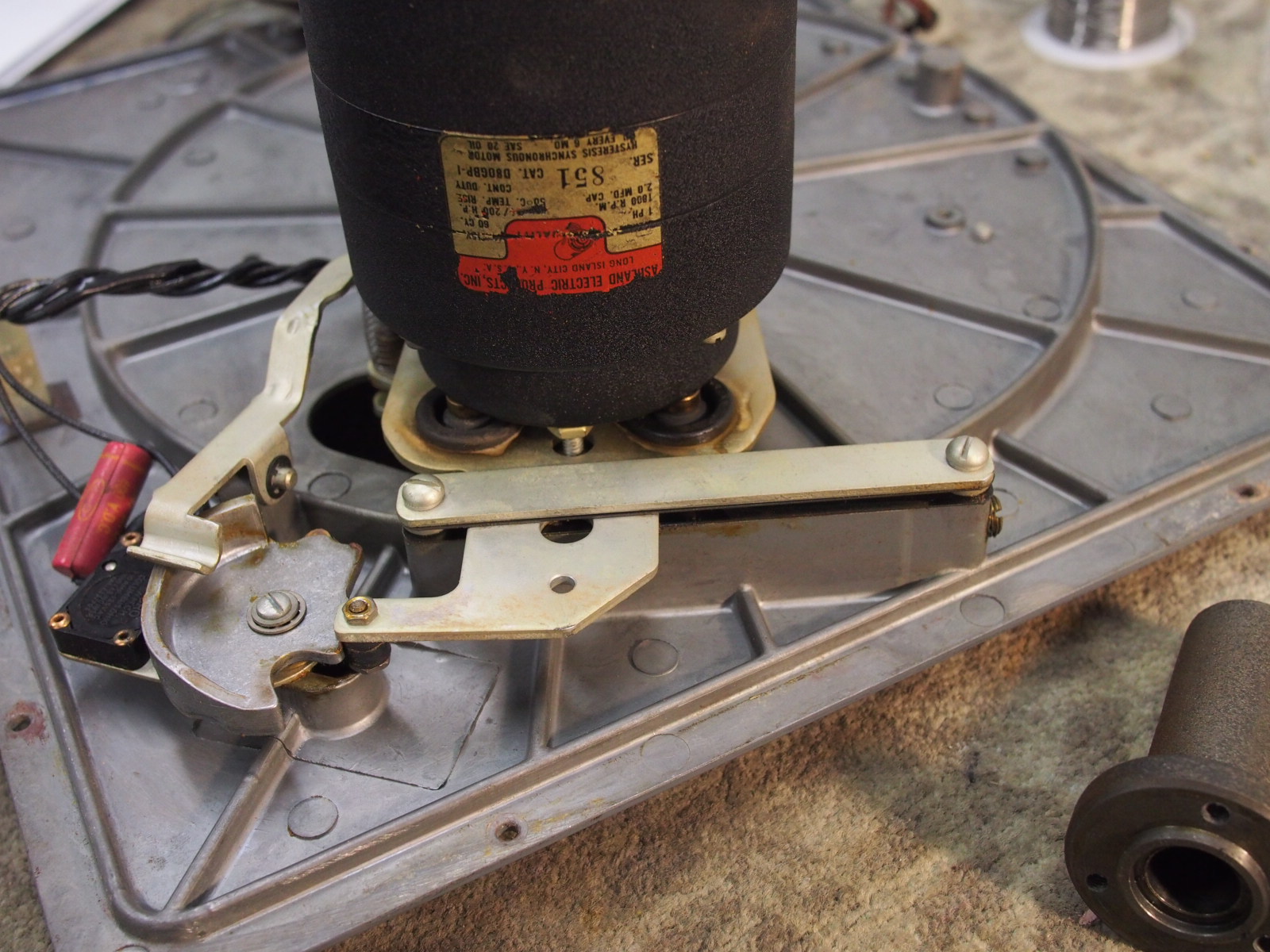

Actually I might have answered my own question. If you look at the mechanism from the side it looks like total chaos but if you flip the machine and look straight down on it, it looks a lot friendlier. Not that it couldn't be botched by sufficient incompetence or hidden traps. And I don't know what's going to fall off when I unscrew the three-point plate topside. What does that thing do anyway?

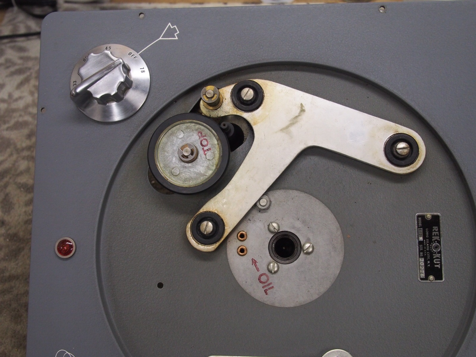

Start on top side. The idler carrier is held by 3 screws through the bushings - one has a nut from the bottom. The idler carrier has a spring that will need to be detached. Then the grommets simply pop out and new ones back in.

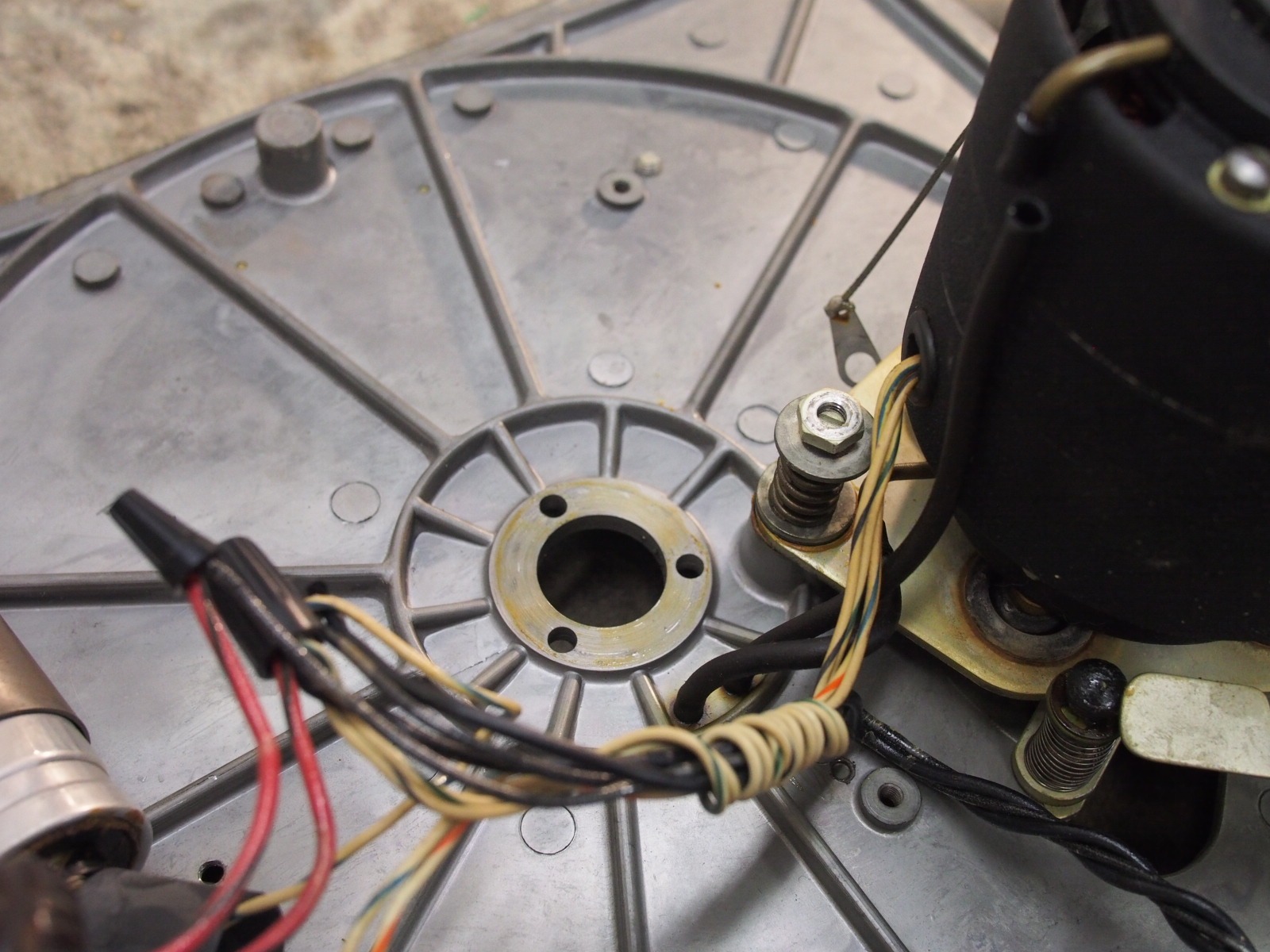

The motor carrier is removed from the bottom. It's best to disconnect the motor wiring before removing motor although you can change grommets with it connected. You'll see it slides under a plate held on by 2 screws. There's a spring under there which is best removed first - comes out at end of the carrier using the brass plug. Then remove the 2 screws on the slide plate. Finally there's a pivot with a couple nuts (locking and require double wrench to loosen). Remove these and be sure to note location and sequence of washers and spring. You'll then see how the motor carrier is attached to sliding carrier by 4 screws through the grommets.

The manual is worth having as it describes the speed adjustment procedure. Also would likely benefit from replacing or refurbishing the idler wheel.

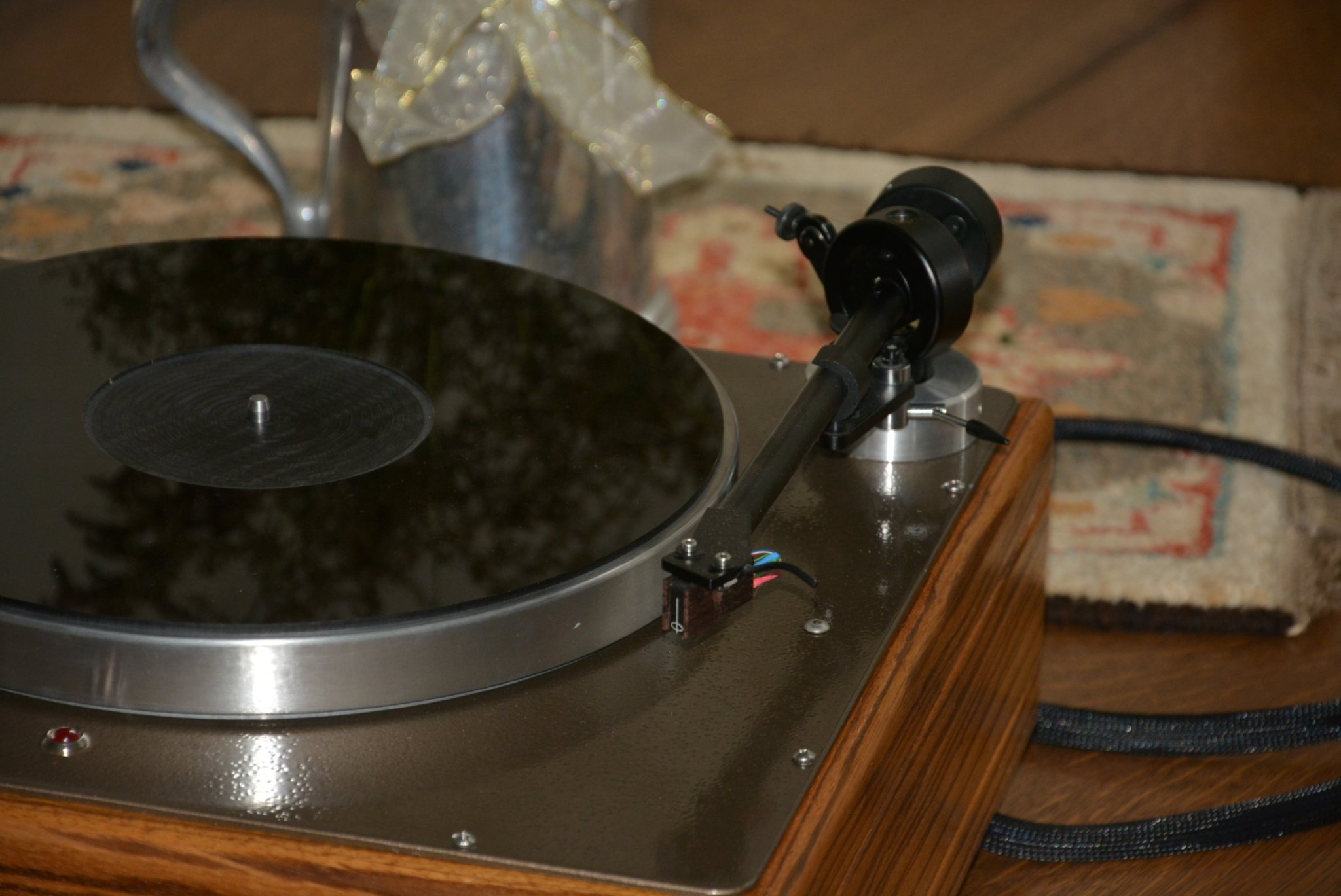

If you have any specific questions, feel free to get in touch - I've restored a bunch of these. They are really nice sounding when restored. I generally replace the arm in the process because you can make a large improvement.

Yes, there's limited space for even 9"arms. I've had luck filling the existing hole (bondo) before refinishing. This gives some flexibility to move it farther back but you have to avoid getting too close to the edge. Most anything 222mm pivot to spindle can work. A normal hole saw will drill the casting but you need a wood blank clamped tightly on top to keep it from wandering. There are a lot of very nice vintage arms that work without using outboard armboard. Any of the Linn derivatives, including Kuzma, Mission SM; AudioQuest (and other Jelco derivatives/OEM) Moerch DP6 is a nice arm for that table.
