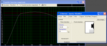

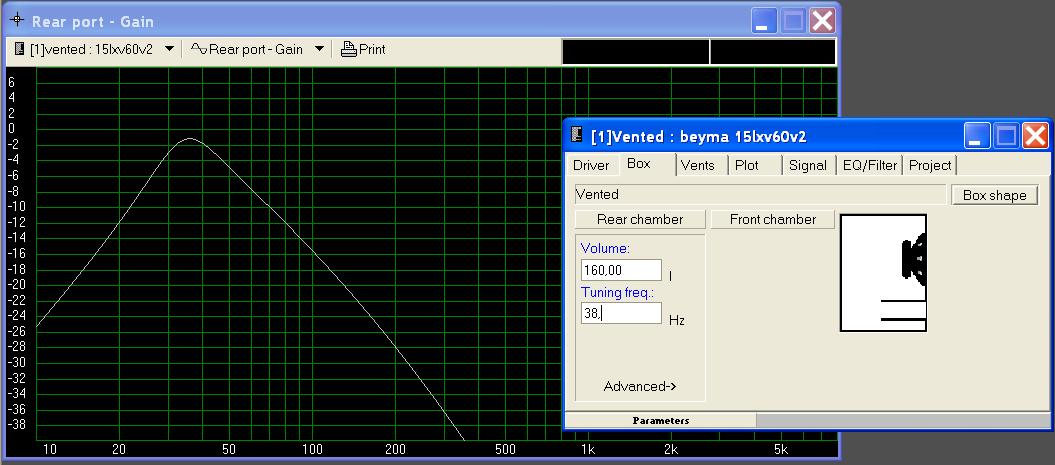

usher 15" I do not know the type number not cheep.
Beyma 15lx60v2 best one for good low end and good SPL.
USHER 15HM Studio
See sim beyma. -6dB 26hz 96db 1Wmtr.

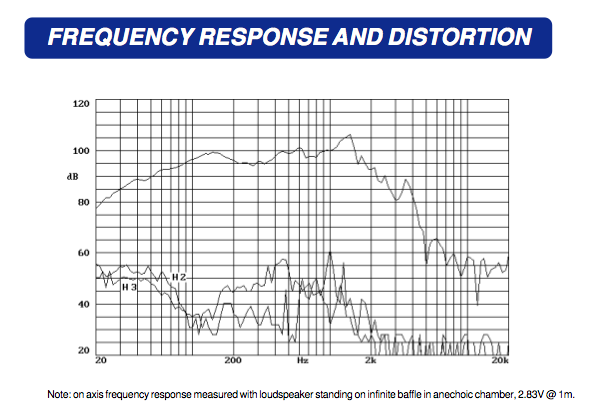

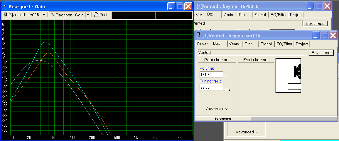

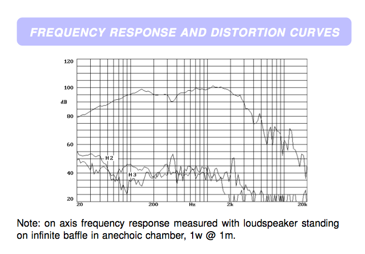

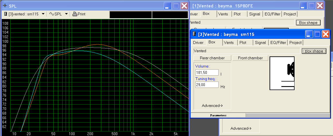

when you look at the THD of woofers they can have very low distortion at higher frequencies and very low extrusion that let them sound good.
Like this sm115/n not expensive at all and high end THD.
third and second harmonic around -55dB. The low and thd is sensational good.
attachment.php

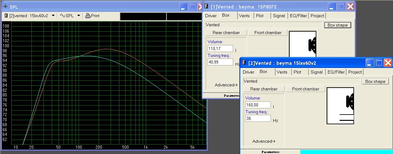

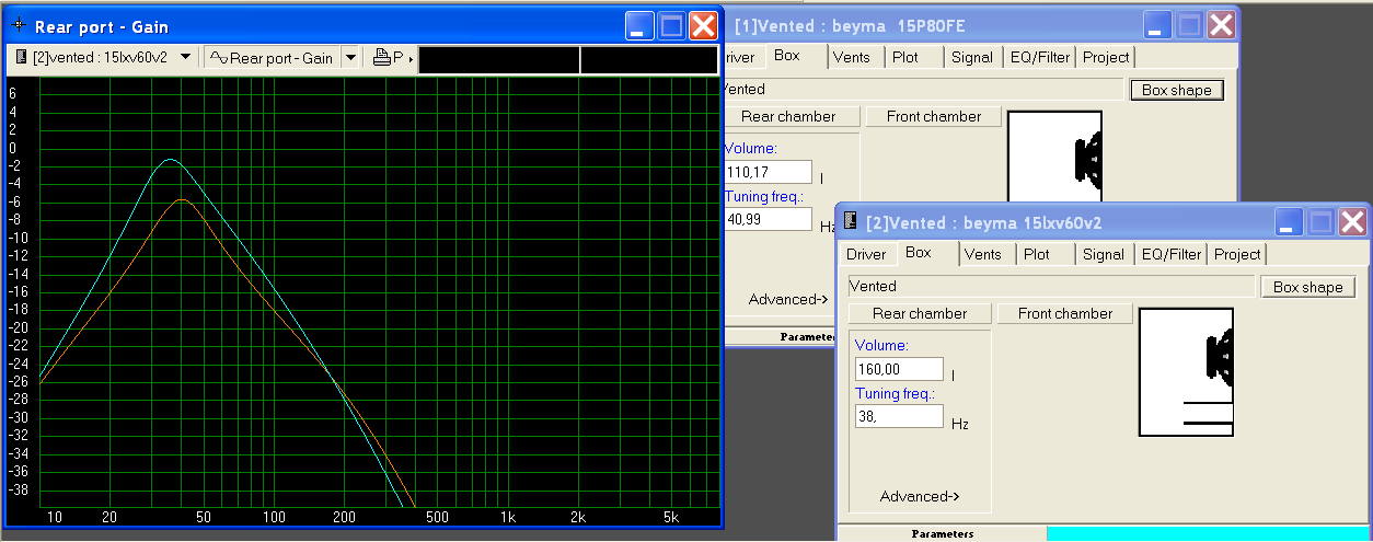

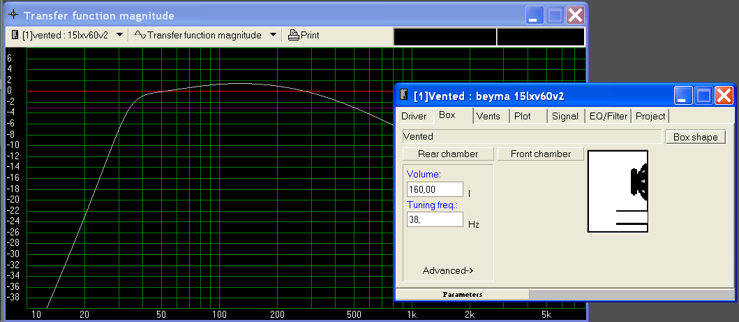

Like I already thought the 15lx60v2 is best in band with and efficiency.
the 15p80fe (orange) can work in a small box but not as good at 30Hz as the 15lx60v2(bleu).
