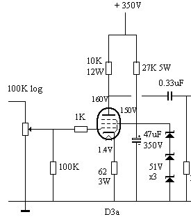

PhillippeS,
Can you please clarify something in the schematic you presented? There is a junction (I think) below the 27K and above the 47uF where this path to ground crosses the lead out of g2. does this all connect there at that 4-way junction? Or does the wire from the 27K to the 47uF cross-over the lead out from the g2 without actually making a connection there?

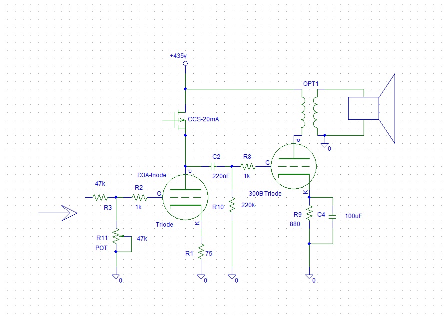

I promised you to draw a schematic and here it is.
I have drawn the shunt mod, and the output stage as well, but I didnt check values, but used the ones you gave me. The shunt mod has one disadvantage, at full volume it still acts as a voltage divider 2:1. But the d3a has a gain of 70x, so the 35x left is still plenty. I presume you don't have a pre-amp? because if you do, I would leave the potmeter out.

Pauldune,
Thanks alot it looks great. I think the only difference is I have 0.33 Russian PIO's I will be using.
I was wondering if I should maybe place some resistance to bring the voltage down some on the CCS....maybe a B+ of around 300-325 rather than the full 435v for the output stage. This should decrease the heat and sinking I will have to use for the CCS. Or am I mistaken? If it is a good idea to bring the B+ down a bit for the CCS is there a particular voltage you would target?
Is there any way to use the CCS for the 300B stage as well? Just curious, I haven't seen this before and I am sure there is a reason. Maybe it is just I haven't seen it too. Not sure. Either way, any use for this for the output stage at all?

Jeff-
the closest I've seen is the Tubelab SE which uses a different CCS for the input tube (a 5842) and a MOSFET follower for the grid of the 300b.
I don't think the 300b would lend itself to a CCS as a load since the load has to be the output transformer. Maybe a CCS at the cathode?
My thought was to go with something like Paul's design with the mosfet follower. The tubelab site mentions that there really aren't other suitable tubes than the 5842, but I am not sure why. Seems that the D3a might be fine.

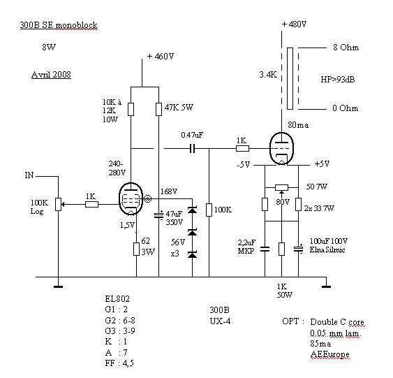

jmillerdoc,
yes, there is a junction between g2, 27K, 47uF and top of zeners, to obtain about 150V on g2 D3a and 170V on g2 EL802.
Philippe

The 0.33 pio's wil be more than fine.
The lowering of the B+ seems like a good thing to do, but when I tried it, the CCS I used (the ixys 10m45s) started oscillating. Directly connected to B+ it didnt do that, so for me the choice was simple. Anyway, its not that much power, so with a nice heatsink it shouldnt be any problem.
With 300v B+ you still have about 200v pp swing, and thats more than you need to drive the 300b. just put a 6k8 10W resister between B+ and the CCS.
But I wouldnt do it, you shift 2.7 watt from the CCS to the resistor. Plus you need an extra resistor and an expensive cap.
You can't use the same CCS for the driver and the end tube at the same time. You can however use another one. You have to use the output stage parafeed with a decoupling cap. But it wont do the same thing as with a driver. With a driver, because of the very high impedance of the next stage, the current through the drivertube stays practically constant. The loadline becomes a horizontal line.
With an end-tube, its a different story. the current through the ccs remains constant, and for dc it flows all through the tube, but for ac it splits. part goes through the tube and part goes through the output transformer. so the load line isnt horizontal, because the anode current isnt constant. What the loadline would look like, I wouldnt know, but i suspect something in between.
One of the advantages of using a ccs for the output stage is the decoupling from the powersupply, its not in the signal path anymore. also, the powersupply sees a constant load; it doesnt matter if you play hard or soft, transients etc.
I tried to use those qualities in my design:here
