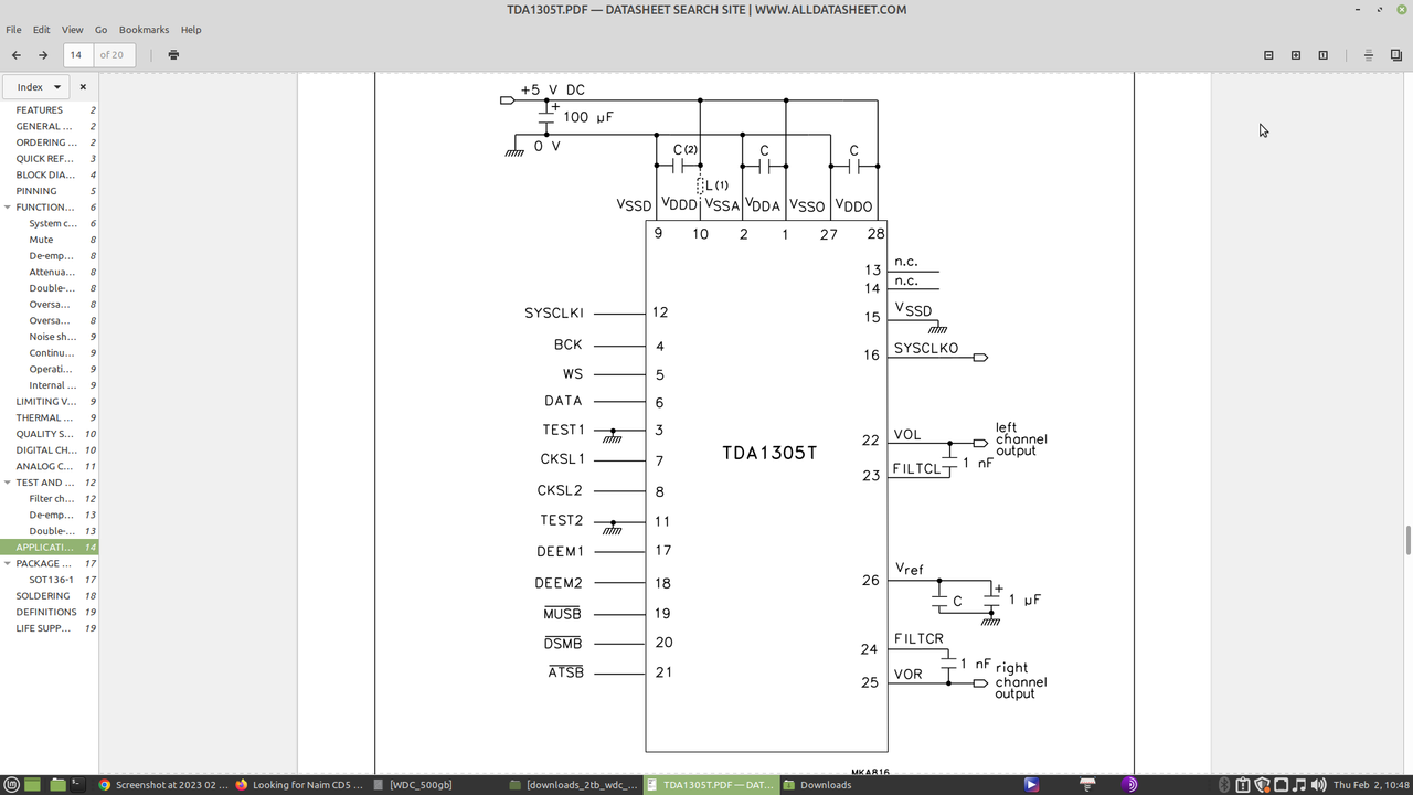

I don't have either. I'm curious about the analog output section because the DAC used in both those CDPs, a weird Philips Bitstream device, has a simple Vout. Naim seems to have added a multi-pole filter (output) that goes well beyond the datasheet of that DAC. Overkill? Or a better buffer? In any case, I have a Harmon-Kardon multi-disc CD player that uses a similar DAC IC. Thinking about modding it for improved, Naim-like sound .
The TDA1305 is a very straightforward device - have a good read of the datasheet.
Anyway, Naim's strong suit (to my taste) has always been their analogue filter stage design in such things - and the layout is part of the brilliance.
These players use a 7-pole, Bessel alignment; the first pole comes from the feedback cap on the TDA 1305 datasheet; in the CD3.5 and CD5 it is followed by two, well-finessed, equal value Sallen-key 3-pole low-pass filters in series. That's it, that's all. Except that compared with many, the physical layout and power/architecture of signal 0v layout and supply rail decoupling is really-well executed - just replicating the schematic on veroboard, will not perform as well.
To get really-good performance from Sallen-Key filters requires attention to teh sensitivities of such a filter design; Sallen-key requires surprisingly-high opamp bandwidth, about 100x the output passband, and output drive capability (hence clean power decoupling a big part-of). The map, is not the territory, kind of thing.

(The 1305 datasheet indicates the DAC has "internal" opamps; VOL (pin 22) and VOR (pin 25) are each, respectively, tied to pin 23 and 24 for "channel 1st order filter function should be connected between pins". The datasheet suggests this cap to be 1nF. And this is full output -- nothing more is necessary???)
I have a weird Chinese USB/SPDIF dac kit -- with two 1305 DACs used in parallel.
In that kit, there is equally weird output section that uses NO external opamps. Rather, some sort of resistor-capacitor network with 220uF output electros -- these caps (DC blockers I assume) are in series with the output jacks.
I thought all this was overkill so I hacked the kit, JUST using the datasheet-suggested circuit, but kept two 1305s in parallel. This heavily muffled the sound and gave me 2.5v DC at the output.
Restoring the orig Chinese circuit restored the decent sound (and output DC back mV) . But I have no clue as to why the 1305 datasheet circuit does not work????

BTW: The datasheet notes:
V_FS(rms) full-scale output voltage (pins 23 and 25) (RMS value): 1.425 - 1.575 V
