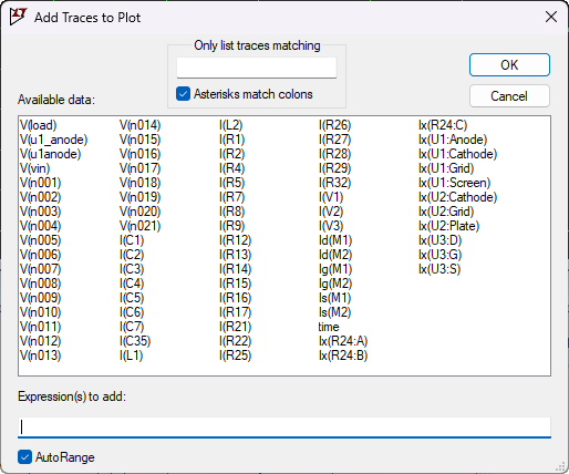

Are R11 and R3 on G1 and the cathode of the 6EJ7 placeholders for values to be determined under test to prevent oscillation?
No, they are there so that the simulator will give you some way to report cathode and grid current. Neither are present in the test board. Generally, if there is a 1 ohm resistor in one of my schematics that was drawn in LTspice, its there so I can graph the current flow through that point.
