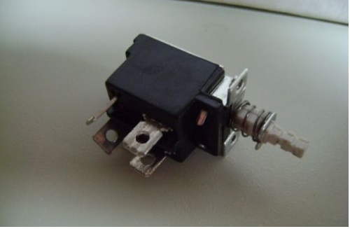

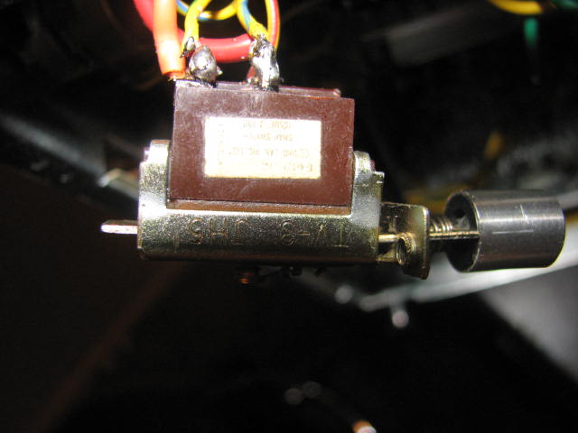

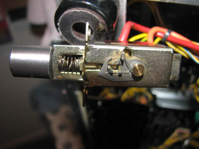

Hi here are the photos thank for your help Ivan

An AT PC computer switch may work if there is plenty of room around it. The hole spacing on these is about 20mm with an M3 thread and they have a square shaft for the knob (button). Usually the knob can be pulled off to check.
Alps has plenty of switches like that but are only low voltage and amps. Some Japanese manufacturers overcome that by wiring through both poles. Finding a high amp push button switch is not easy and is why I suggested the AT PC computer one which are rated at 5A-10A.
