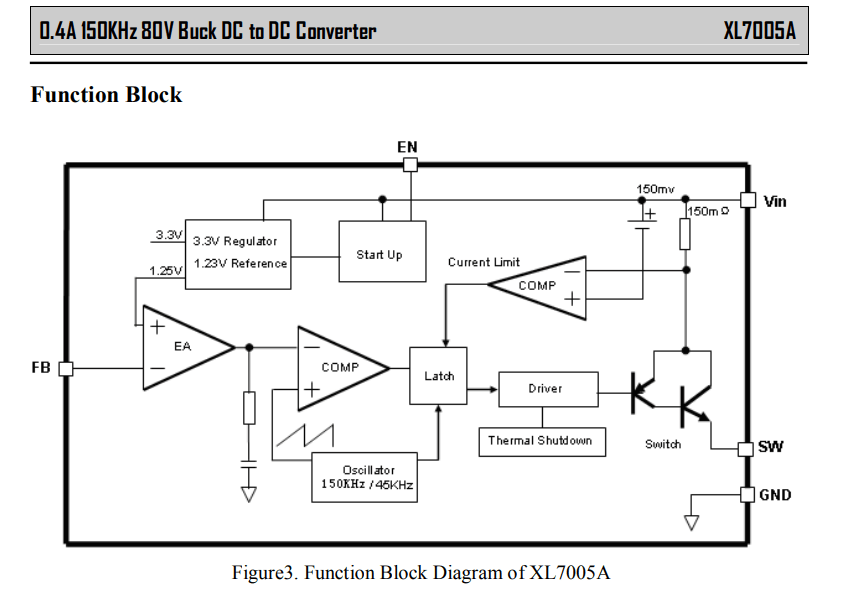

Awkwardness arises because it's neither simple nor cheap to build a square wave oscillator which runs from a +58VDC power supply.
The simplest solution, assuming that 150kHz is an acceptable frequency, would be to repurpose an XL7005A buck controller IC to operate just as an oscillator.
I'm not sure this would work, the oscillator output is not push-pull. I doubt it can pull down all the way to the bottom supply rail in 3.3 microseconds (half-period of 150 kHz) when driving the flying capacitor in a charge pump.
_
Ha, good catch. I wonder if there's a sync buck that could handle it, I'll look around.
