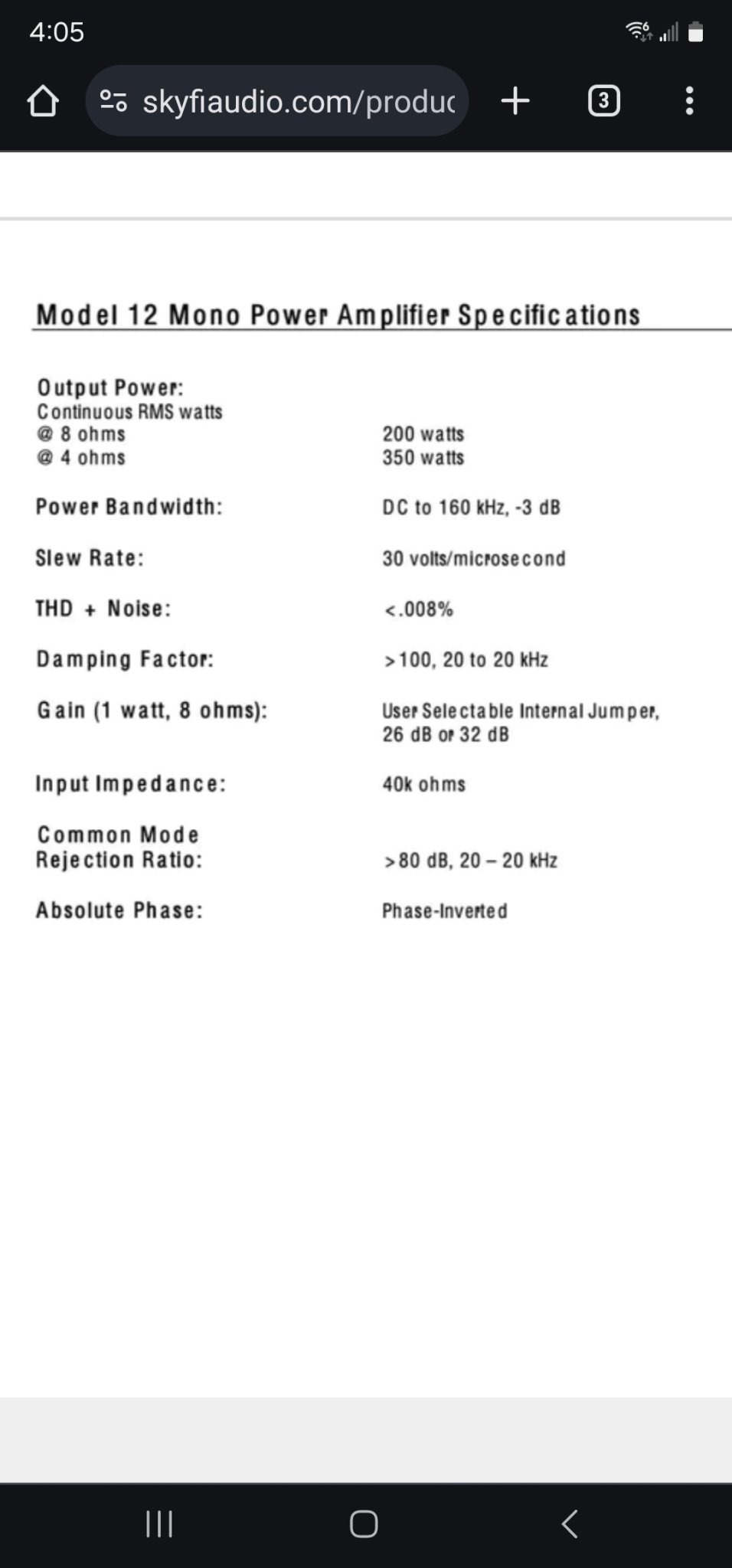

In the spec jeff rowland claims 350 watts with six lm3886.
https://skyfiaudio.com/products/jeff-rowland-model-12-four-piece-mono-block-amplifiers-wow

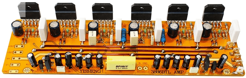

It is much easier with TDA7293X2 parallel. You can find by Google many public domain PCBs or board from Ali.
https://aliexpress.com/item/4000092889019.html

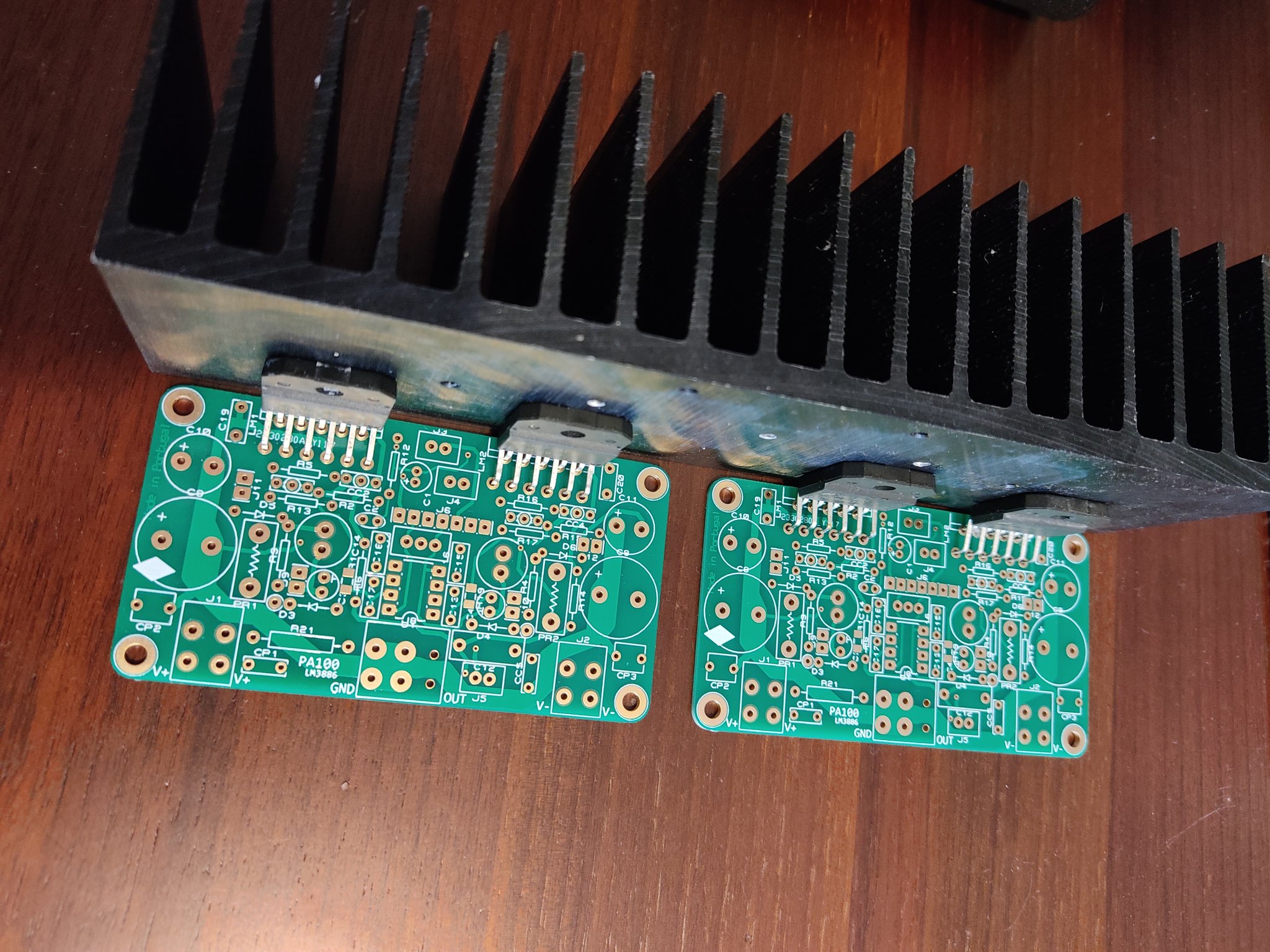

I develop very recently the pcb's witch I show here:
Or you may wanna check out my other solutions like PA150 or other here:

Have you seen any reports of a build of a build with that board?

First, thanks @adason for mentioning this board.
Now, I have one channel based on this board and it looks like indeed a promising project. Right now it is on my test bench and I have completed prelimminary meassurements. It has great frequency response and incredibly good square wave response.
Now, I'm testing its endurance on 200W 7.3 ohm dummy load. For time being I was able to run it at 125W constant 1KHz signal. I do really push it at the limits of thermal endurance.
Otherwise, the board is a real beauty, very well designed with wonderful layout. It is going to have from me a beauyiful chasis.
I intend to start a new thread devoted to this project. It will be fun. Very soon, perhaps this weekend.
