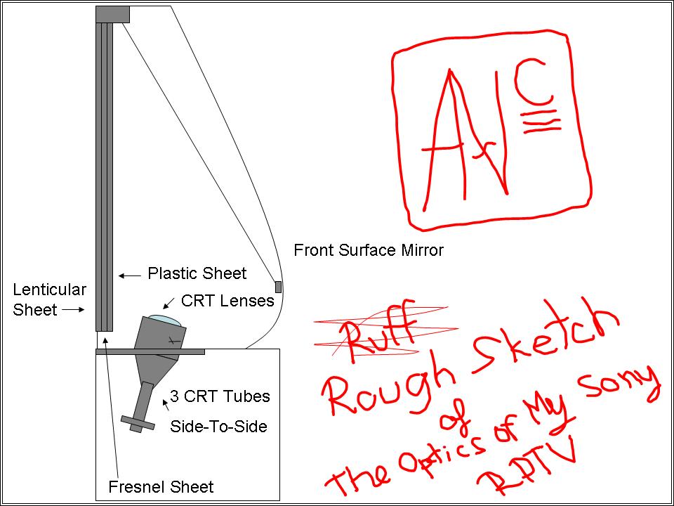

Tetutigre,
I dont know the mirror dimentions - didnt measure it, and the tv is closed up... Its shaped like a trapezoid (is that the right word?)
The top is about as wide as the screen, the bottom is about 5-10 inches shorter...
The CRT's in a projection tv (or DLP/LCD projector if you wish) focuses through the projection lenses, the projection light path folded by the FS mirror, bounced off onto the screen. The fresnel is ontop of the screen is to push the light towards the viewer, help reject ambient light. On top of that there is a lenticular sheet that I belive adds alot more horizontal viewing angle. My theory - but probably the real theory behind RPTVs...
"hows the alignment accomplished?" alighnment of what, the mirror or the CRTs (convergence?)
I was talking about the alignment of the mirror in respect to the projector and the screen... covergence only applies to the crt tubes I believe. I just wanted to check and see what was the alignment like - from the projected image onto the mirror and bounced to the fresnel focal point (I think)... now, what do you think if I projected a TV's image to that path... would it be something doable, or would I need your kind of triplet? Just wondering again... and wandering. LOL

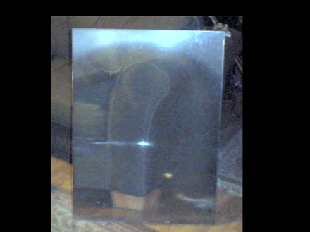

I thought I had already posted... mmmmmm that's weird. Anyway, I'm attaching the picture of the fresnel so you get an idea of it. I remember having one of those tv screen magnifier (they still sell them for older people with vision problems and stuff I think) ith turns a 19'' tv to a 26''... of course the viewing angle was limited, you could not see it from the sides and stuff.
Now, about the brightness... a crt or lcd projector are way brighter than a tv, but would it work ok in those conditions (enclosed, short distance)?? Just wondering again.
