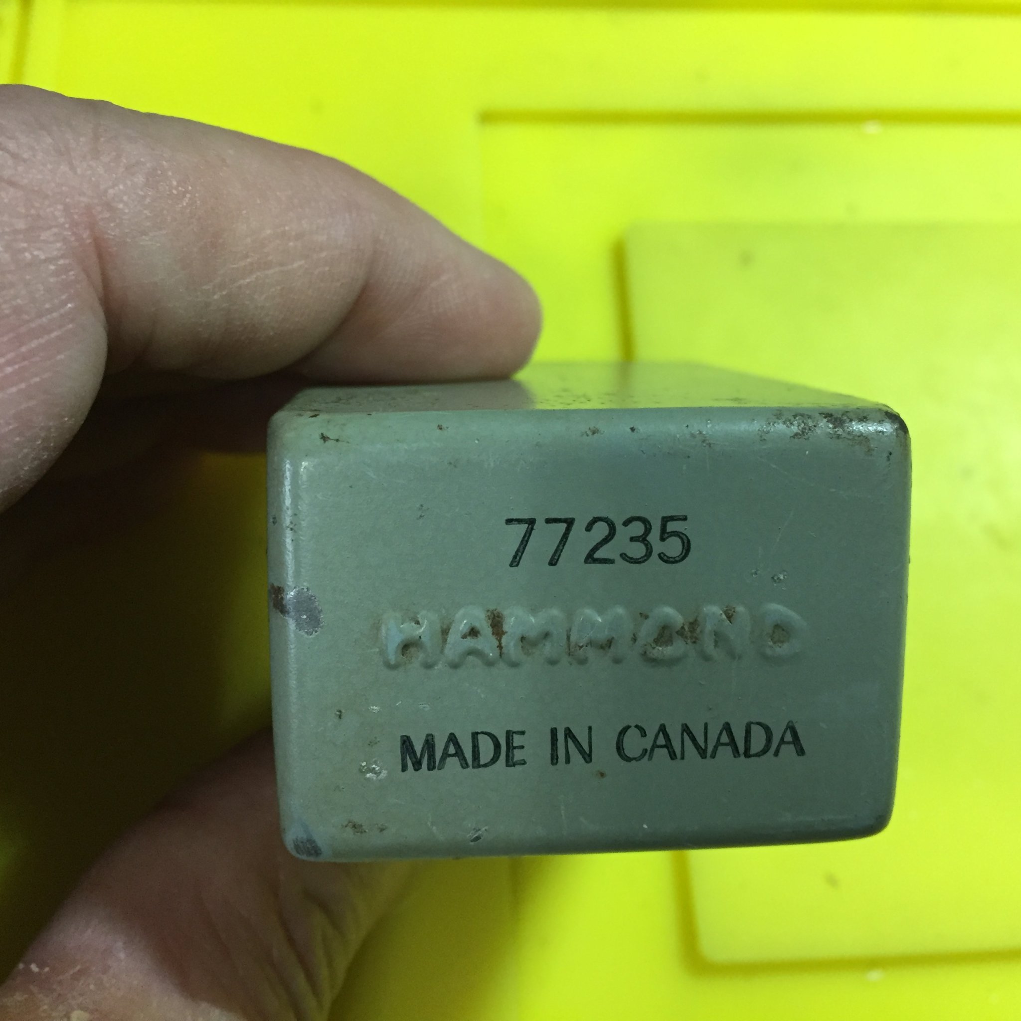

Wondering if someone could have information on this unit. See picture below. The only identification is the 77235 which I assume is a model number since it is the same on the two units I have.
No information about this on current Hammond catalog, but physically it looks like one of their "broadcast quality" units. Transformer is in sealed case, looks rather vintage from the ancient Hammond logo style.

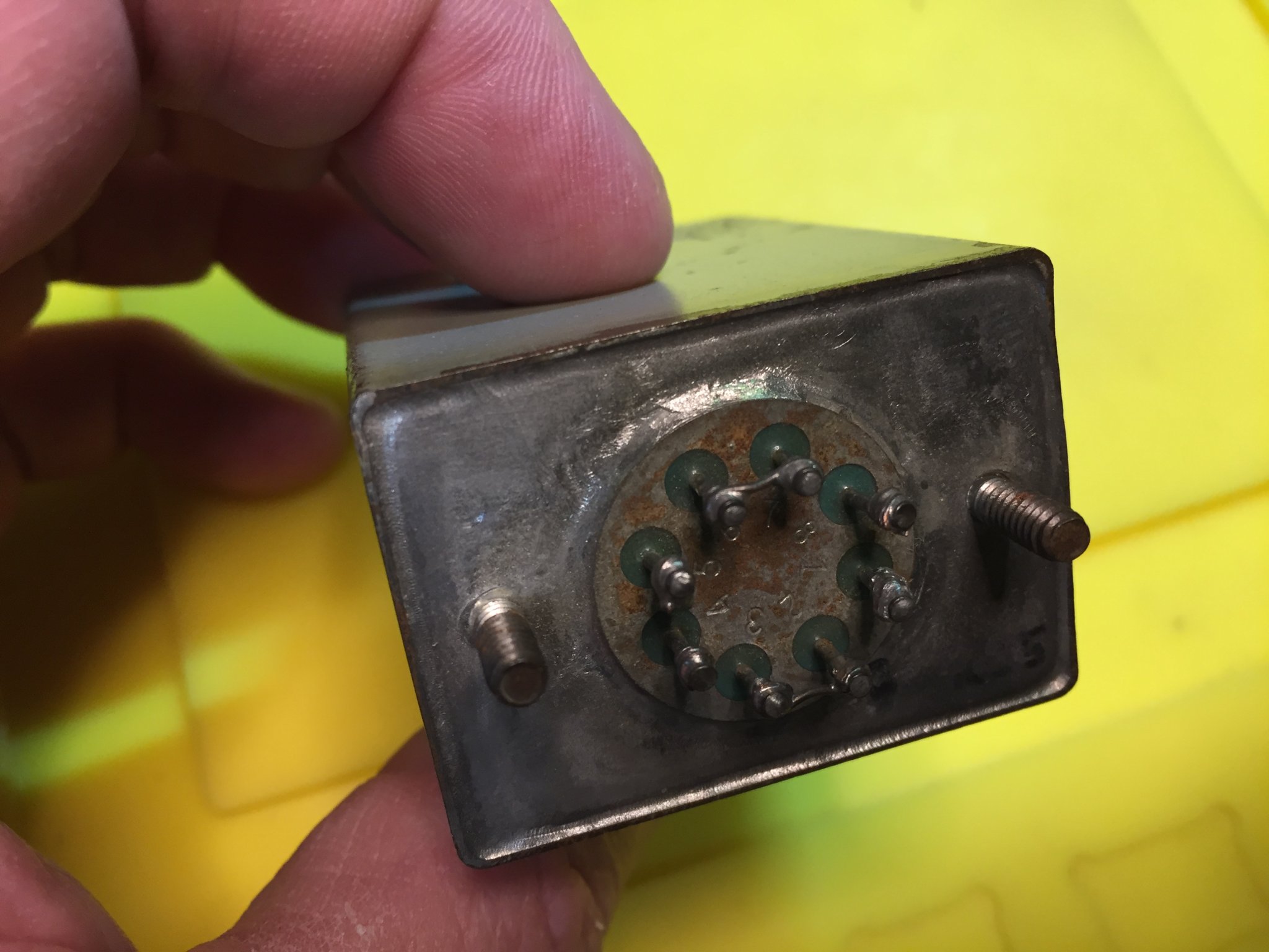

The soldered pins strongly suggest dual windings, and winding pairs from each side are isolated from the other as you one would expect. Measurements are:
- Pins 1-4 : 59 DCR, 3.27H
- Pins 5-8 : 46 DCR, 3.3H
