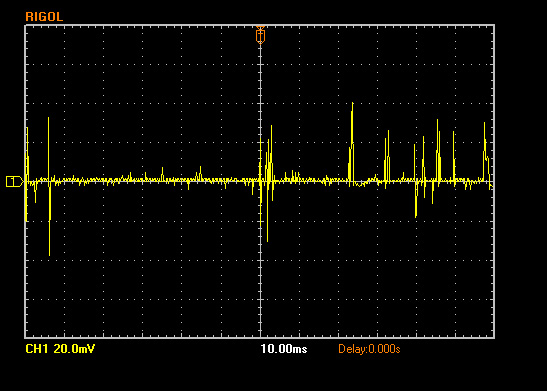

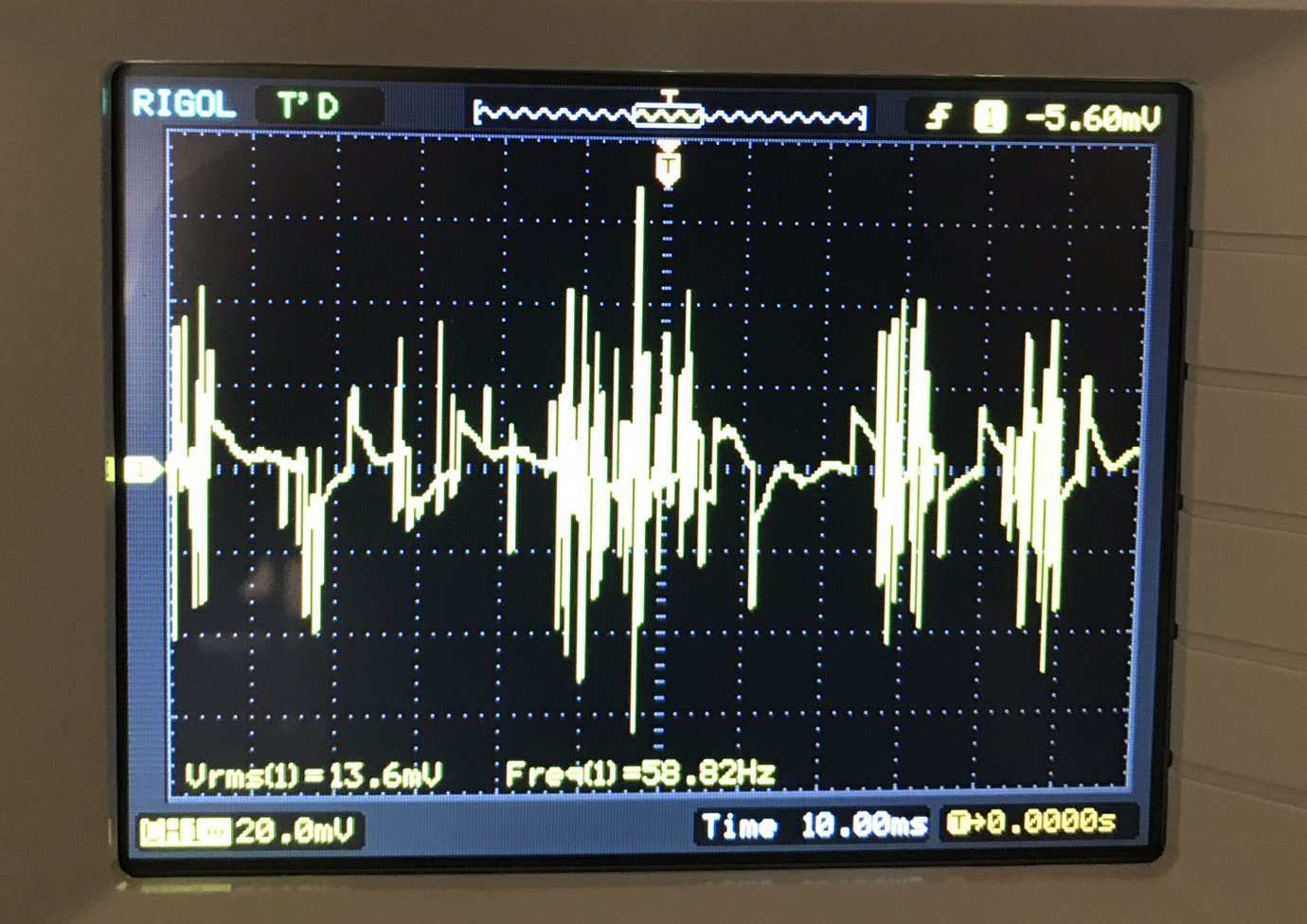

Anyway, it sounds like pffft pft pfffffft etc. I think it might be more evident just after turn-on. It's not continuous; there are relatively quiet periods. On the scope it looks like this:
The big spikes correspond with a "pffft" sound culminating in a "tick" from the speaker.

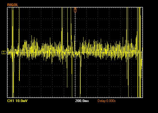

There's no feedback in this amp. I can trace the noise and spikes all the way back from the output to the output of the front-end voltage amp.

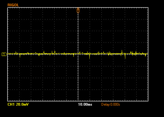

There is spiky noise on the input whether the amp is on or off but the the spikes don't correspond with the spikes in the output when the amp is on.
There's no RF filter on the inputs of any of my amps. The power rails look clean enough.

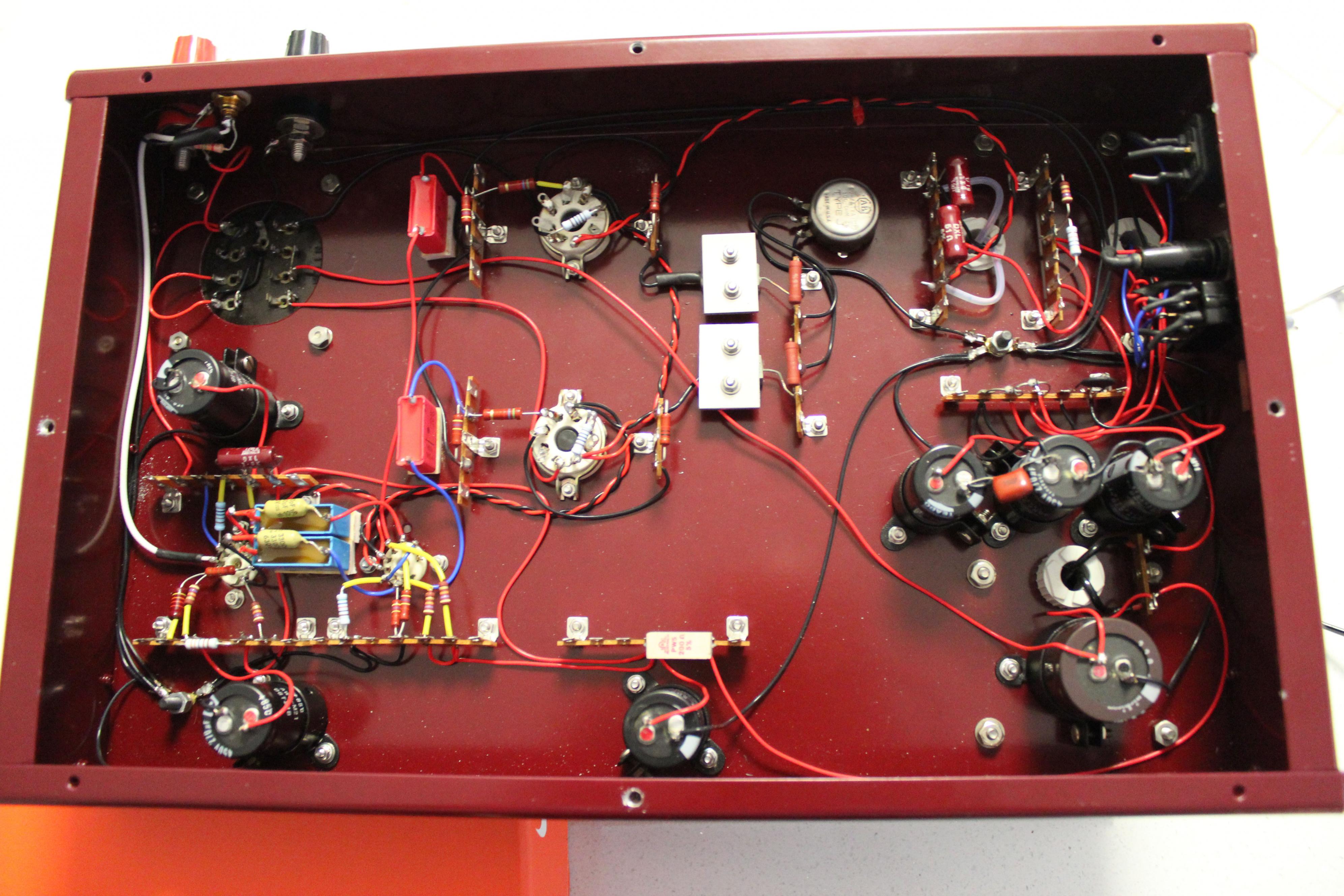

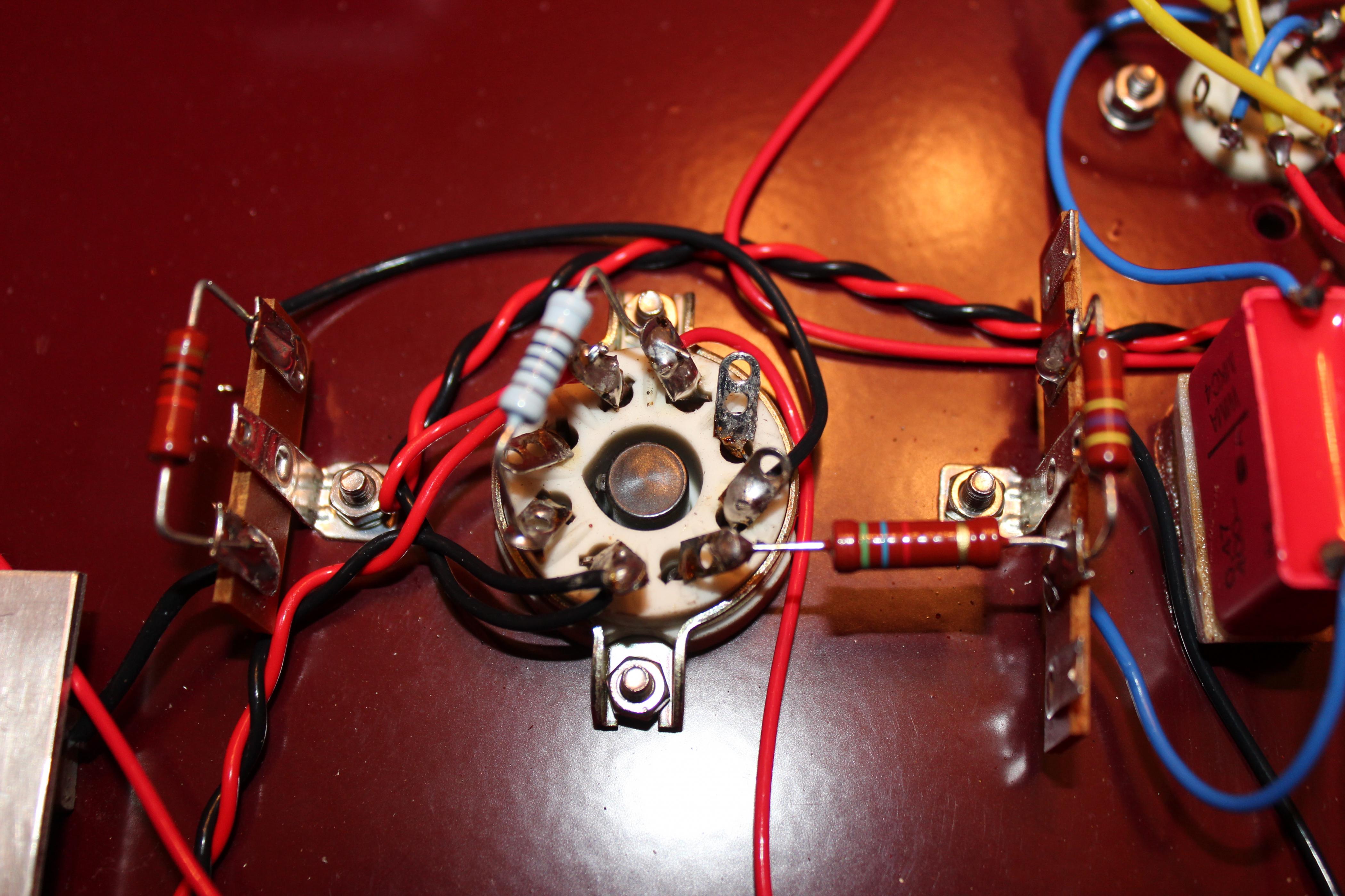

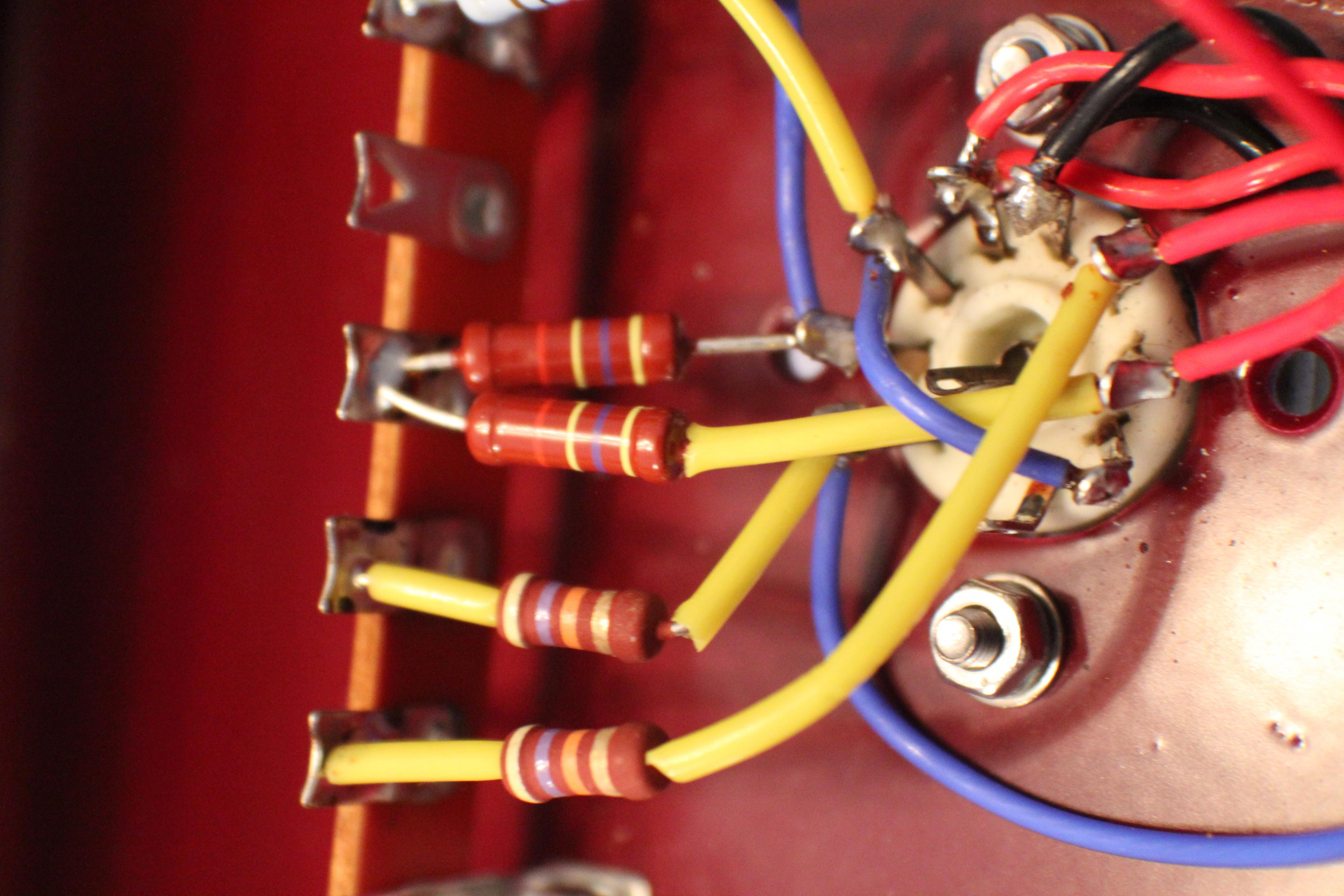

Attached are pictures of the resistor around the driver and output tubes. They don't look like carbon composition resistors although the 2 47k anode resistors on the driver triodes might be.

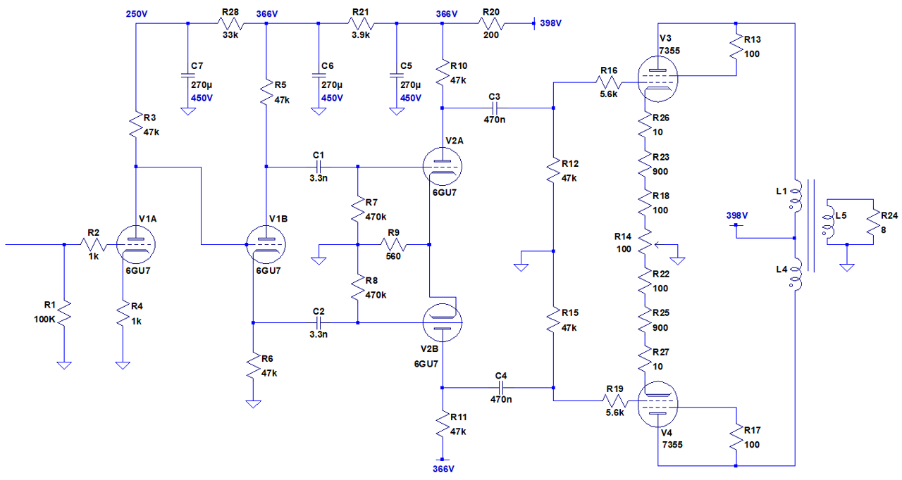

Here's the schematic.
There's a full wave rectifier driving 2 voltage doubler capacitors (270uF/450V) followed by a choke and 330uF/450V capacitor driving what you see in the schematic.

So, I removed the output tubes and the problem wasn't there. Tiny spikes only:
Here's the resistors around one of the output tubes and an overall view. Do any of the resistors around the output tubes look like I should replace them?

Without the output tube there will be much lower current from the PSU. I'd look at the PSU. Maybe the caps drying out?
Another way of looking at this might be that the output tubes are going bad. You could check this by swapping the output tubes between the two channels. Does the problem stick with the tubes or with the amp?

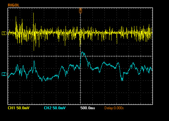

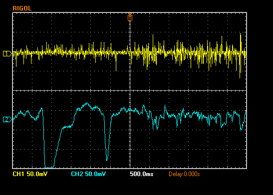

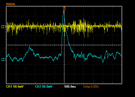

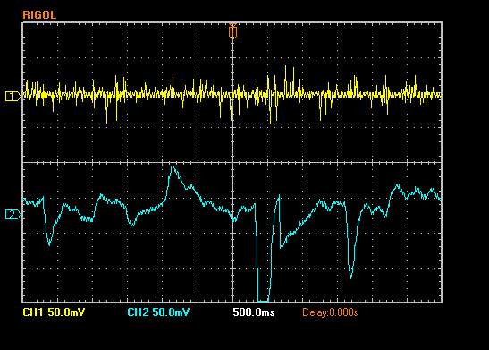

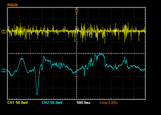

Here are a few screen captures showing the output (top in yellow) and 400V HT (bottom in blue) with R12 and R15 shorted and the cathodes bypassed.
The HT does seem a bit noisy but I don't see any correlation between the output noise and the HT noise.

If R12 and R15 are shorted and the noise is still there, it is in the output stage. Confirm it by removing the driver valve, V2.
The noise could just be worn output valves or a problem with the cathode bias tree. Check the pot has a good wiper connection and it is wire wound.
