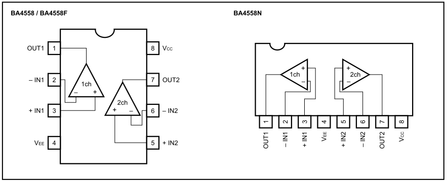

I got scammed from a craigslister. I have a rockford fosgate 400.4 that powers up (no protect light) but no audio output. I have one channel (rear left) thats moving my speaker without any input audio. The other outputs im getting nothing. I have some background with electronics but not much with car amps. I checked the mosfets. No shorts were found. Im getting a short between the 1 and 3 legs on the two diodes on the rail but im not sure if thats the problem. Anyone have a better idea of what I have going on or what I can check next? 😕

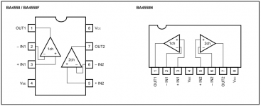

With the black probe always connected to the secondary ground, it measures the voltage on pins 4 and 8 of the operational amplifiers.
You should see 2 identical and opposite voltages (probably +/- 15v).
Post here the results.
I have 18.9v on one diode and -18.9 on the other when putting black lead on ground wire and red on pin 2 of the diodes. I'm unclear on what else to check. "Pins 4 and 8 of the operational amplifiers"???
What is particularly difficult?

Inject a 50hz sinewave signal to the input of all 4 channel (set the crossover to full range).
With the probe, check pin 1 and 7 of all operational amplifier.
You must see the same signal but with different amplitude.
