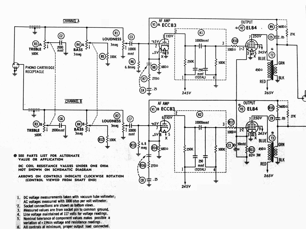

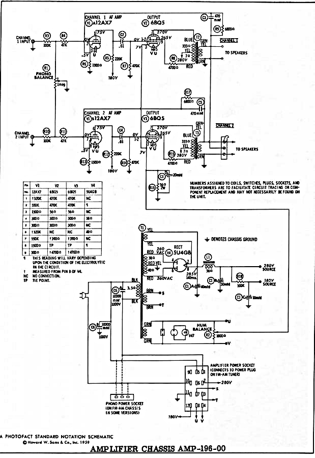

Also, I am enclosing a slightly photoshopped [darkened and sharpened version of the schematic you enclosed - a little more readable for my eyes].
That will be great. It certainly is a learning experience for me.

Unfortunately, the 100M marking could mean either 100 or 10 pF. In some cases, less than 1000 pf is labeled directly in picofarads. In others it follows the resistor color code - one, zero, followed by zero zeroes. The resistors on the vicinity are 6.8 meg, which means the node is high impedance which would tend to favor smaller cap values. 101M would be unambiguous. I would find some way of measuring one of them if contemplating replacement. There is no reason for them to outright fail, howevrer.

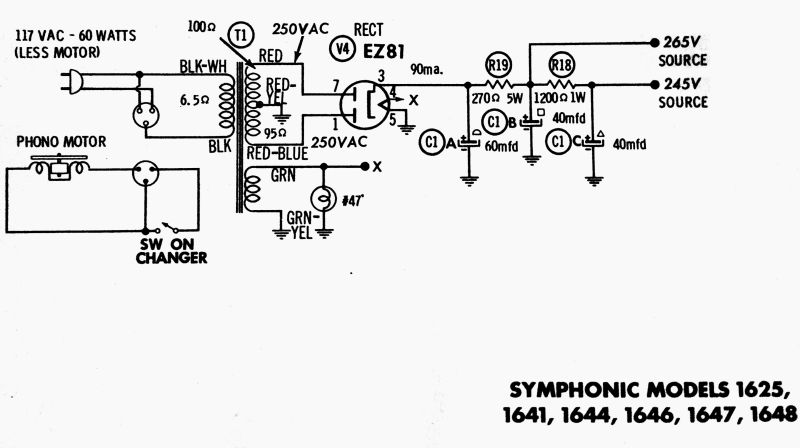

I found a Sams folder that covers four Symphonic models, uses the same four tubes, and power transformer is part number TR-180. (three output transformer #s listed, TR-184, TR-178, TR187 depending on model.) Sounds like we're getting close. But seems off in a number of ways - doesn't have the heat shields, has two four-terminal ceramic RC coupling networks, and doesn't show any three-terminal ones.
The .25 caps and .05 caps are used to shape the frequency response of the feedback network - eliminate them with the tone controls (which are pretty harmless really - will have almost ZERO effect if you're not driving this with a ceramic phono cartridge). A flat frequency response is desired, not an attempt to compensate for cartridge, tone controls, and cheap speakers.

The .05 (C5, C9) is "bass boost" - use the dotted resistor instead. The .25 (C4, C8) is treble boost - just delete it. This amp shows separate R/L Volume and small output transformers (portable phono version). Yours may have loudness compensation (bass boost at lower volume) You can leave that or remove the ceramic module.

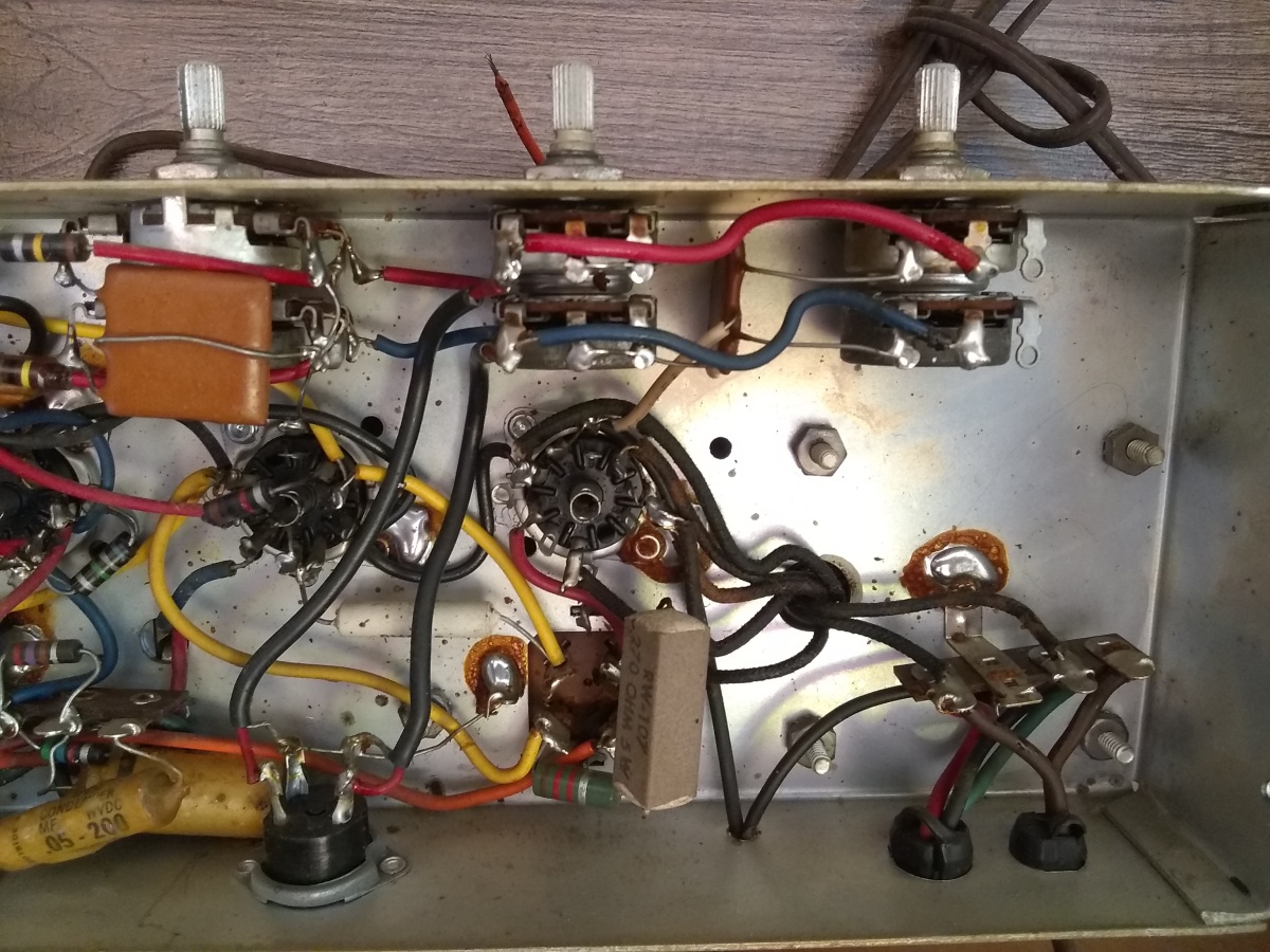

Can't scan it - here are cellphone pics of amp and power supply:

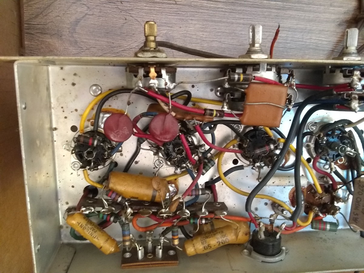

Holy cow - are my eyes playing tricks on me, or are the coupling caps between stages actually in those ceramic networks? If so, it's the first time I've ever encountered that. Even more reason to remove them and replace with discrete components. Thanks to Tom for the excellent sleuthing!
When you say "leave it or remove tje ceramic module" , you are referring to K1 and K2 in the first image right!

Finally got to the project! This last couple of days, I made a lamp limiter and started rewiring. I have a couple of questions. If you look at the first image, near the audio output section, I can see the output going via R9 [5600ohm] and C5 [0.05mfd] [please look at the schematic image]. However there is a 56kohm resistor that is also going straight to the output. This is where the schematic shows I can bypass the R9/C5 and use a 27k resistor. As you can see there is one of 56k there already. Then I can just remove the R9 and C5 and leave the 56k there - or should I remove the 56k and replace with 27k. I guess I can try both.
Another question is re: power supply. If you look at the second image, on the bottom right, I have the power coming in via two brown leads going to the post. However if you look on the top of the post, two black wires leave, I am thinking the primary winding of the power transformer. The power lead coming in on the far right does not seem to go to the transformer winding. There is another set of red/green/black that seems to take the power out and return, ending via green on the transformer winding. Does that mean the phono that was supplied by it was in series?
If so I can feed the posts with the two transformer black leads right? I did check for the continuity using ohms on the multimeter and the two black wires have continuity.

Two coupling networks shown on schematic - I only see one. Possible it has six leads, combining both? Replace with discrete parts: 240K or 220K resistors, .01 caps, 470K resistors. (the 250 pF caps will roll off high frequencies a little - skip them) But for now, leave it - do the minimum to get it working first.
Black wires are power transformer primary. Was switched on / off through the record changer.

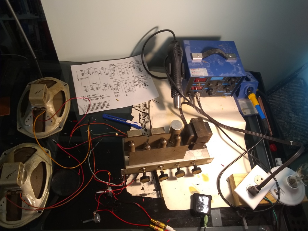

Finally I got to it and managed to make it play. As you can see from the image the old can capacitor is still there. I am waiting on the order of the 50mfd dual capacitors. I reused the speakers it was driving - they are rotten as you can see but didn't want to risk good ones!
I used the preamp tube pins 2 and 7 for the grids, fed them from an old mp3 player uvia 100kohm pots and 100ohm resistor. Powered through a lamp limiter. I am super chuffed, this is my first valve project. It was fairly clean without any overt hum.
Now I am going to go and disconnect the left two pots on the chassis, place the new ones in there and make proper speaker posts. Then the case/box!
