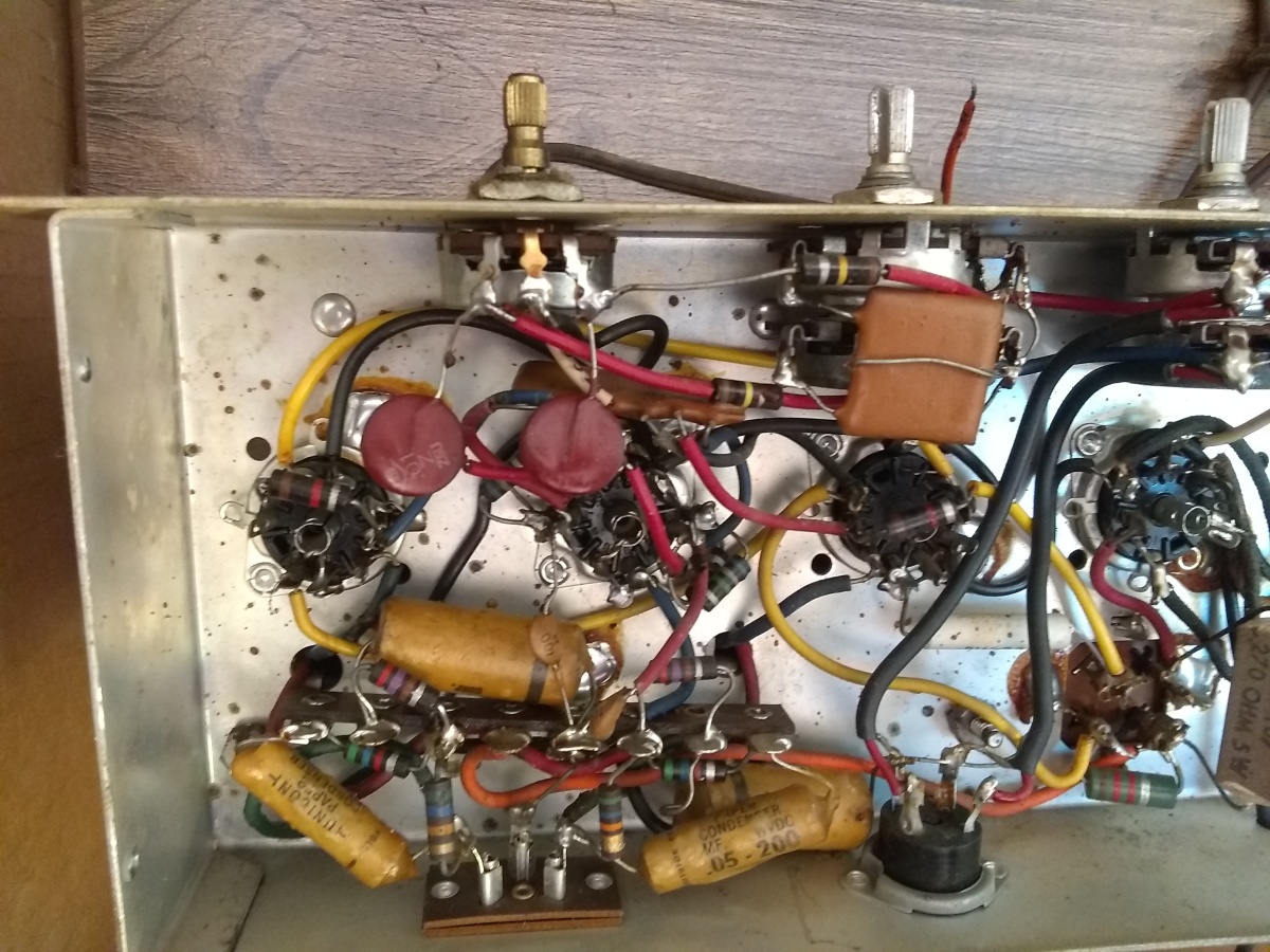

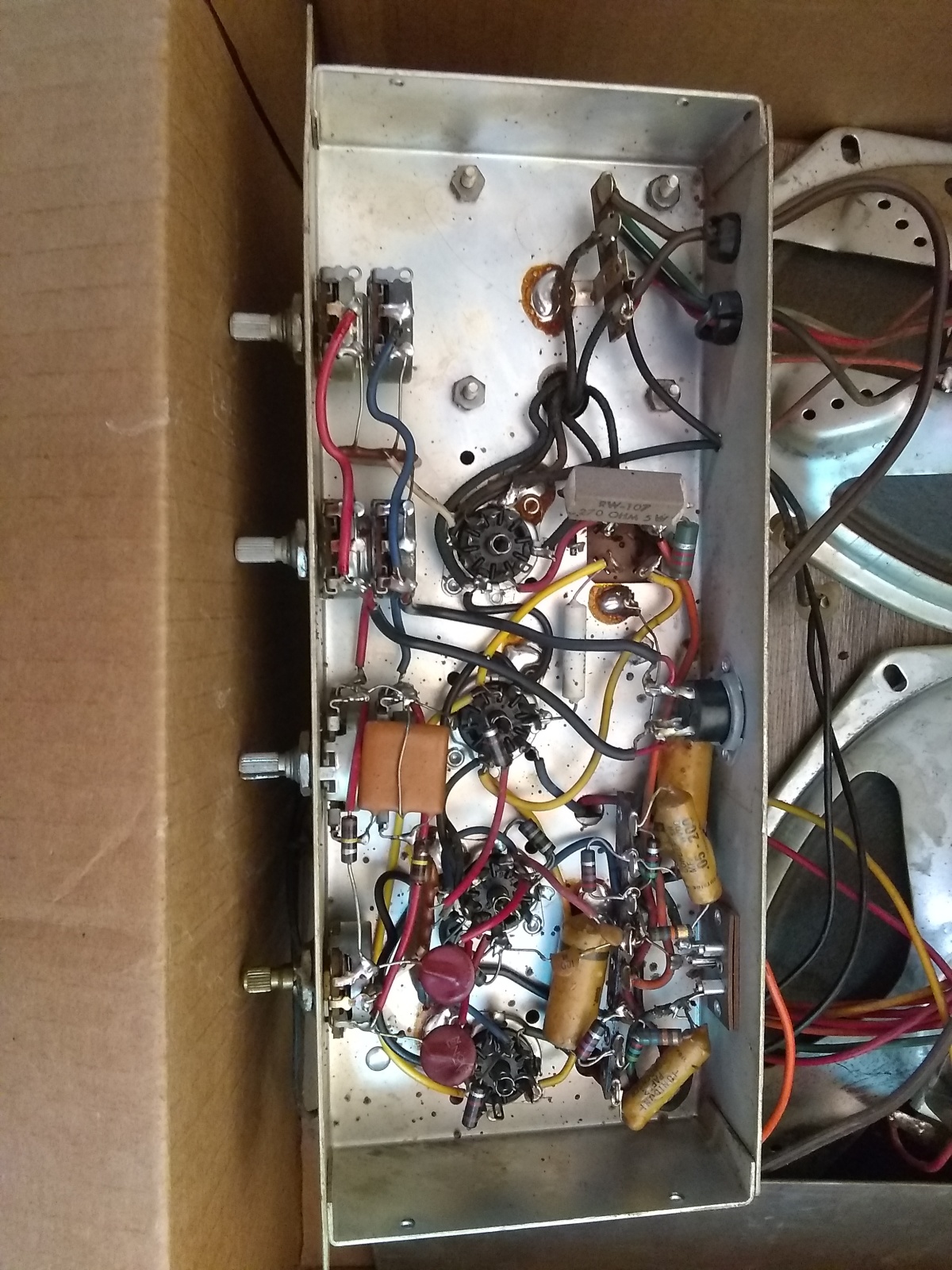

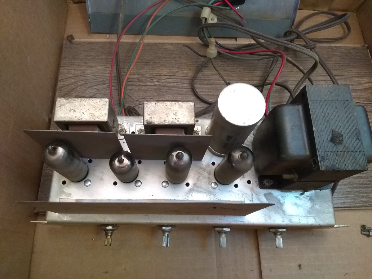

I am looking for help in bringing a tube amp I bought in flea market back to life. It was part of a turntable console by a company called "Symphonic". I dismantled carefully and brought the turntable and the amp in. I am a fairly newbie to valve electronics - have some experience with microcontrollers, simple discrete circuits like rectifier bridges, h bridges for controlling dc motors etc. I guess none of my pitifully small knowledge will help me here with the grownup world of valves.
I am hoping to bring it back to life, took lots of pictures so I know where things should go just in case. I understand that all the electrolytic caps must go! I have been looking at the circuit underneath and can't figure out what capacitors to order. I am assuming I need to change to Can capacitor too that is on the top of the circuit.
Also, once I put the new caps in, is it ok to power it on or should I use a current limiter as described by "uncle doug" on youtube? I have a simple multimeter. I don't have a variac. I have a reasonable soldering equipment. I will put some pictures. Is there anyone who is willing to kindly handhold and guide me through this process?
Main power transformer has "TR180", 831022 on it. It has one EZ81/6030, two of EL84/6BQ5/6035, one of ECC83/6030.
Sorry about haphazard info and lots of questions. Thanks in advance.

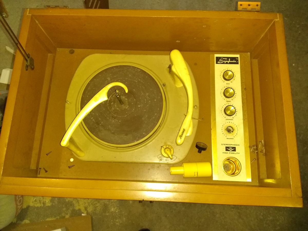

It's cheap, but (fortunately) not dangerously so. 🙂 A power transformer is present.
The turntable and cartridge are GUANO. 😡 They can destroy valuable LPs.
You can refurbish the amp to play "OK", when fed from a CDP or decent TT/cart./phono preamp combo.

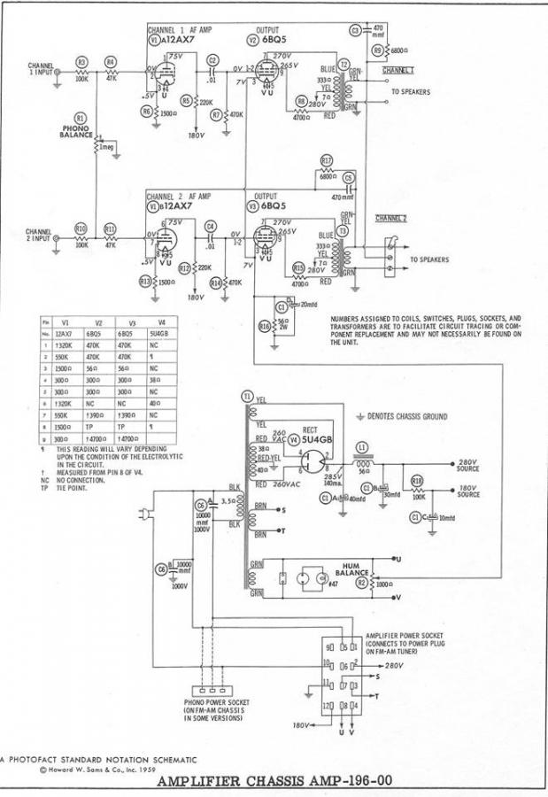

The circuitry is simple single ended 12AX7 section voltage amplifier driving 6BQ5 pentode O/P. It delivers about 5 WPC. The tone controls are utter garbage and have to go. You retain the sheet metal, transformers, and tubes (if they test good). You can clamp mount a nice part in the opening, where the "twistlok" can is currently mounted. A safety grounded, 3 wire, power cord is in order too.
You can look at this Magnavox schematic for ideas about how you rebuild your piece. Instead of a balance pot., use 2 individual volume controls to set listening level and channel to channel balance.

But before you basically scrap and rebuild it, see if you like the sound of it as is. I've been pleasantly surprised before...

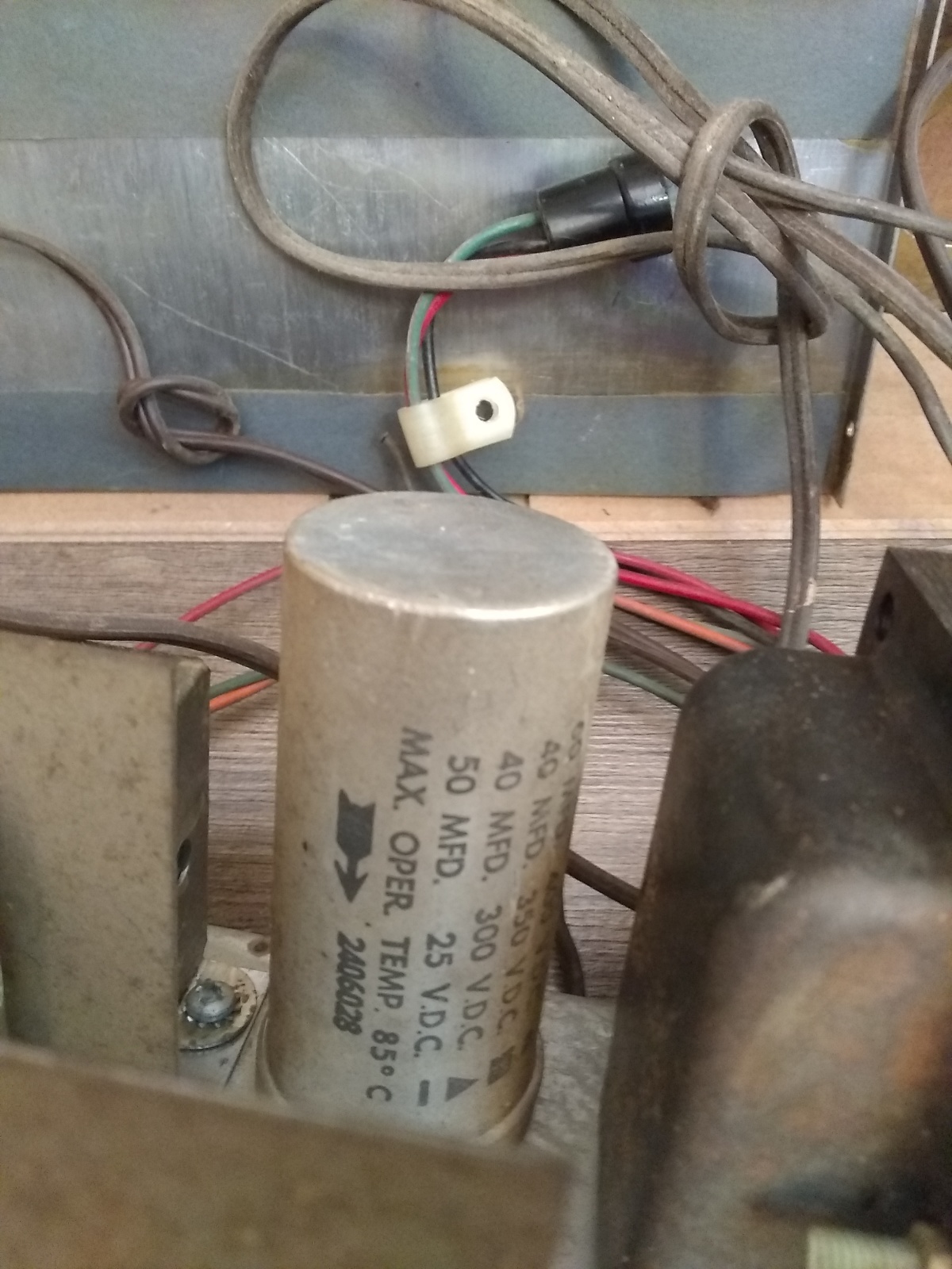

Firstly, if you're new to tubes be aware that there is high voltage present, potentially in excess of 400 volts depending on the device. I would expect at least 300 in a device like this. Make sure you understand how to work safely around these kinds of voltages.
You're correct that the electrolytic must go, but of equal importance are the wax coupling capacitors. With age the paper dielectric breaks down and they leak DC across them. All of them MUST go, as they can destroy output tubes and even output transformers. I've seen some very nice equipment destroyed by bad coupling capacitors (A monitor amp from a recording studio, built from a modified heathkit AA-40 and running KT88 tubes).
The Multi-section electrolytic can is a PITA to replace, and If I were you I'd disconnect it (DO NOT leave it connected, as it WILL eventually short) and use modern capacitors internally on a terminal strip.
The tubes are likely fine.

Power it up on a lamp limiter first and leave it on for a bit, see if the big can cap will reform. It's not necessary to replace all electrolytics at first, those cylindrical caps will almost certainly need replacing, the ceramics should be fine.
The 0.05 caps can be replaced by 47n or 0.047u 630v rated axial poly caps. Can't see what the other two underneath are.
Give it a go before you rip it apart, once you've learned a bit more you can replace things like tone controls etc.
Some of the resistors may be out of spec, but worry about them later, valve amplifiers are different to tranny amps.

That power transformer looks nice and beefy.
Yes, and the 150 mA. capable 6CA4/EZ81 rectifier is more than the circuitry needs. The OEM probably used that pairing with a radio containing model. Economies of scale in inventory control work to the OP's advantage. The power trafo/rectifier are (IMO) the best part of the entire package.
Might as well take advantage of available "real estate" and clamp mount the twin 50 μF./500 WVDC F&T part Jim McShane sells in the hole. Going up in WVDC never causes trouble.
Either 0.047 μF./400 WVDC 716P series Orange Drops or Soviet surplus K40 paper in oil (PIO) parts are highly suitable as replacements for the 0.05 μF./200 WVDC waxed paper parts.
The ceramic disc caps. rate to be intact, but the square, multi-lead, part is a PEC (an early, minimal, integrated circuit) which all too often goes bad. You need the exact OEM schematic in order to learn the values contained and assemble a replacement from discrete parts, when failure has occurred. IMO, there's more than 1 good reason for disposing of tone controls.

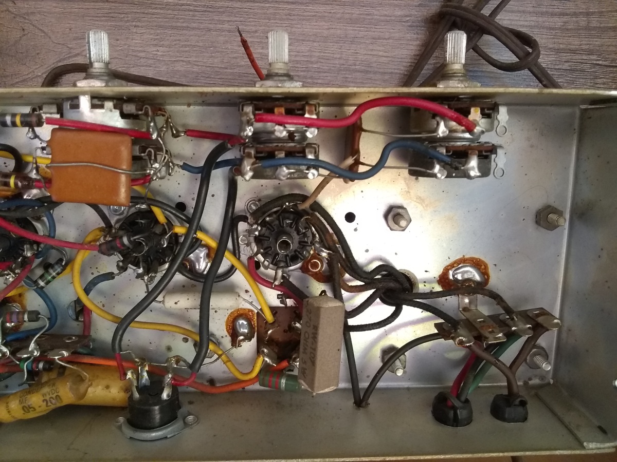

Those "multi-legged caps" are (usually) proprietary RC networks for the tone controls. As previously mentioned you'll need the actual schematic to make any real sense out of these. That's why Eli suggested removing them completely, as it eliminates one unknown and a potential source of trouble.

Mr_Zenith,
If you look at the lower right of the 1st underside photo, you'll see a "Cheap Charlie" twin RCA jack on phenolic. They're pretty closely spaced and have to be used with cabling that's terminated with Neutrik/Rean NYS-352G plugs.

I found the replacement for the big can - Capacitor - Electrolytic, 50/50 mF @ 500 VDC, F&T: Amazon.com: Industrial & Scientific
Will that work?
Also I was unable to find the 0.25mf - instead found 0.27mf - not sure if this will make a big difference! Mouser Electronics

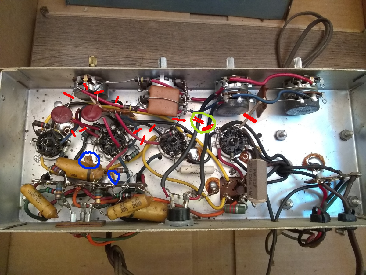

I am thinking of chopping off the tone controls this weekend. I attached an image with some markings. I am sorry about the amateurish markings
The red lines are all the controls that are connected to the pots somehow. Especially the multileg cap and the first pot with the bronze center has a lot of connections.
I can see the input going to the second pot from the right. [red double lines inside green circle] Without the benefit of schematic, can you tell me whether I can do away with all these? If I can, then I guess I don't even need to replace the 0.1mfd orange caps. Somehow the bronze turner makes me think that that is a necessary piece.
If I do remove the pot the input is connected to, then I am guessing the inputs need to go to the preamp tube - - in this case the second one from the left, holding the ecc83 tube.
Also inside the blue circles there are two tiny caps that read "100M" - judging by the size and 3 digit - is it safe to assume that is a 100 picofarad with tolerance of 20%?
The transformer date code is 1960, week 22. That may be enough for me to find a schematic in my files - though a model number or chassis number would be better. Unfortunately, I no longer have a scanner since "upgrading" to Windows 10. But I can find a way to copy it, I'm sure.
Unfortunately, the 100M marking could mean either 100 or 10 pF. In some cases, less than 1000 pf is labeled directly in picofarads. In others it follows the resistor color code - one, zero, followed by zero zeroes. The resistors on the vicinity are 6.8 meg, which means the node is high impedance which would tend to favor smaller cap values. 101M would be unambiguous. I would find some way of measuring one of them if contemplating replacement. There is no reason for them to outright fail, howevrer.
First things 1st. You have a safety issue! Install a proper, 3 wire, correctly "bonded", safety grounded power cable. You don't want that exposed chassis shocking anybody. 😱
Not having the OEM schematic is "flying blind." 🙁 FWIW, I'd go with a bastardized version of the Magnavox schematic I linked earlier and am now uploading. That way, all the "extraneous" stuff currently in situ will just occupy space and you don't have to worry about cutting a wrong wire.
R1, R3, & R10 go. R4 & R11 become 100 Ω/1/2 W. carbon composition mounted right at the socket lugs. Connect 100 Kohm log. taper pots. across the I/P jacks, with the wipers connected to the "free" ends of the 100 Ω parts. You will remove the OEM volume and balance controls to make room for the new 100 Kohm parts.
Magnavox (bless them) used a CLC PSU filter. You'll settle for CRC. The twin 50 μF. F&T part McShane sells will fit into the opening currently occupied by the OEM can and is OK for use with your 6CA4/EZ81. All other 'lytics needed will go underneath the chassis top. Modern 'lytics are much more volumetrically efficient than the old time stuff.
The 470 pF. parts, C3 & C5, are for phase compensation. Their value is tied to the O/P transformers in use. Your "iron" is different and you need an oscilloscope plus signal generator to experimentally determine an appropriate value. Leave them out, at least for now. The firm 20 KHz. limit of "Red Book" CD will work to your advantage. Info. above 20 KHz., as provided by phono or HIREZ digital, could be problematic.
