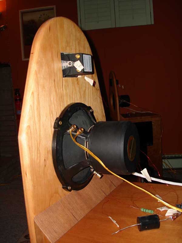

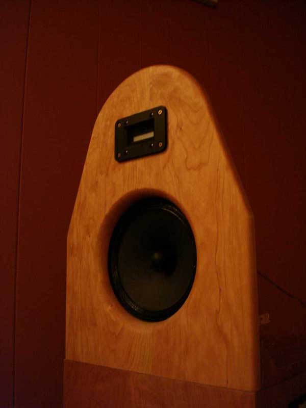

I use the Supravox 215-ESC field drivers in open baffle with excellent results😎.
They are currently run at 7.0 volts and full range with Fountek ribbon supertweeter crossed over at 10Khz first order. The bass (70 Hz and below) come from a separate active crossover and power four open baffle 15" Hawthorne Augie woofers. The bass is equalized with a DEQ 2496. Attached is a picture.
Have fun with your speakers,
Jim Levinson

Hi David,
Jim Levinson
