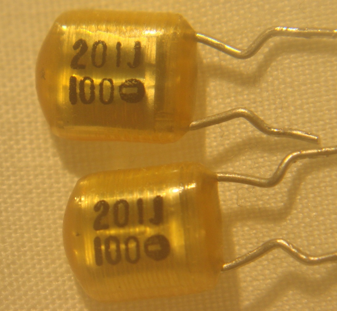

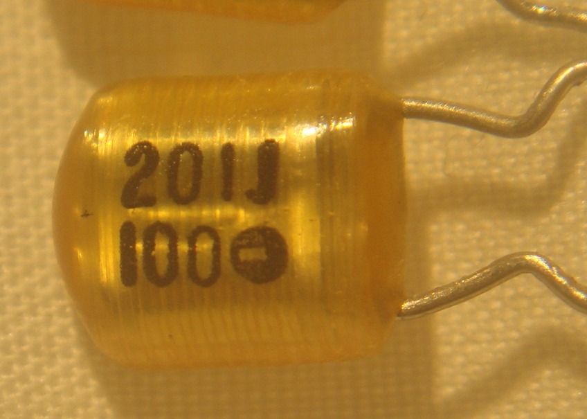

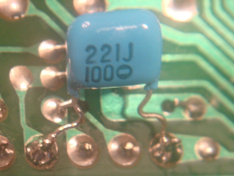

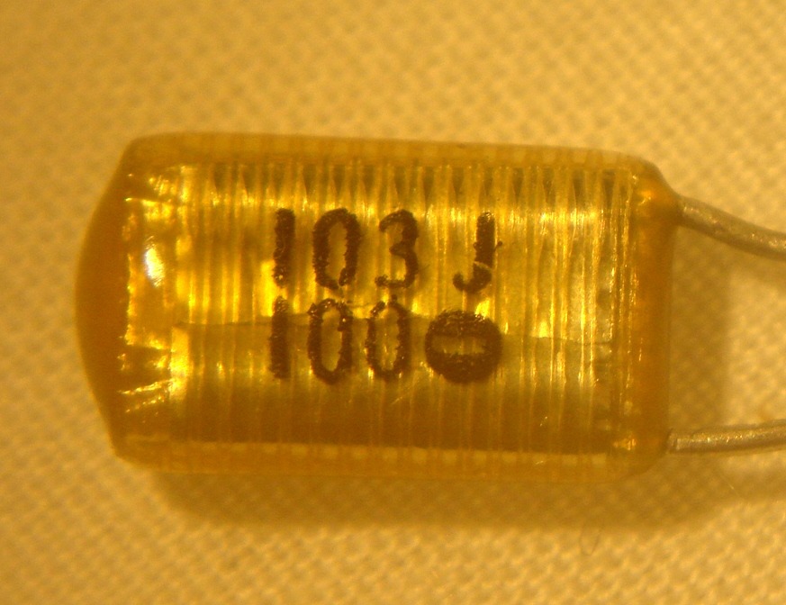

Hi Everyone, Looking for a source to buy small metalized polyester film capacitors in 100pf ~ 1500pf range only and only made by a Japanese company that puts this “No Entry sign” 🚫 on its capacitor packaging. Please see attached images for clarification. Company name is not Nissei Electric (which uses N logo on small film caps). No, it is not Nitsuko. This is another Japanese company. Please post here if you know recognise this logo or you know the name of this company with this strange 🚫 logo? They are not on caps.wiki site. Thank you
Most likely this manufacturer from Taiwan - https://www.taiyang.com.tw/product-detail-2790495.html
It seems it is a joint venture with a Japanese company:
The establishment of TAIWAN TAI YANG Electronics Co., Ltd. in 1967 as a joint venture with TAITSU Corporation of Japan.
Same products and logo from the Japanese company - http://www.taitsu.co.jp/english/products/consumer/index.html
Thank you very much for your help. Much appreciated it. I have another logo identification challenge... I will post seperately
