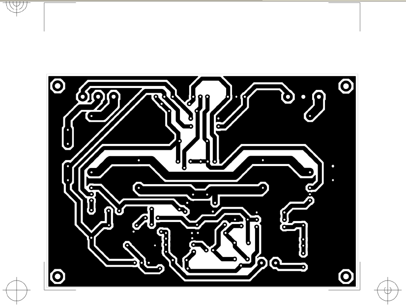

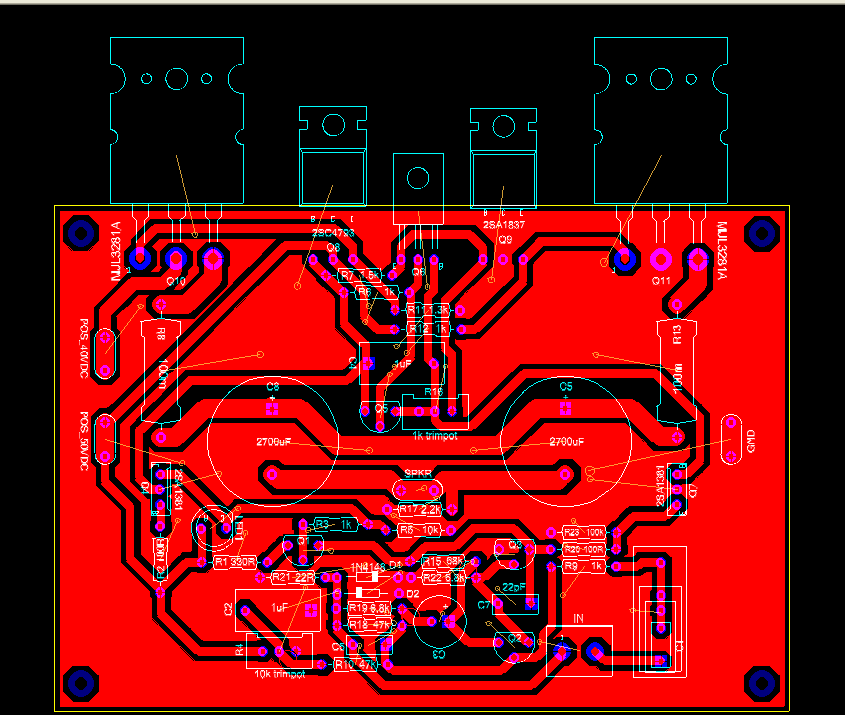

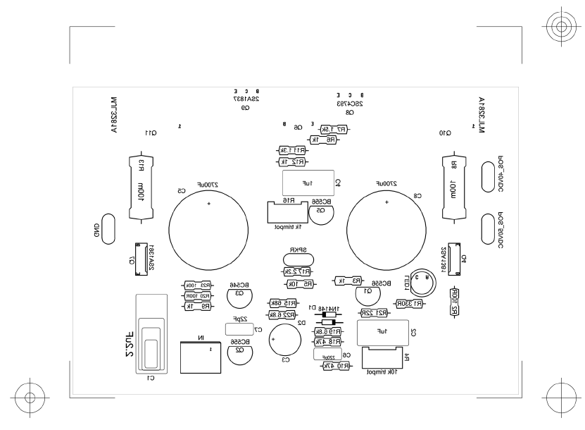

Alrighty then, I did it. A little rough but it will do for the first complete prototype:
Silkscreen is printed on the other side. I'm taking tomorrow off so I may do a bit more with it - drill holes, add parts, etc.

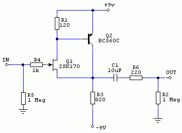

How's it going with the construction MJL21193 ?
I am thinking that if I build this amp I should change the input device to a CFP - it's become my favourite compound device these days - would it work, would it help, did you try this in your sims ?
Perhaps a JFET/BJT CFP - what are your thoughts on this ?

You can improve it a bit by putting some resistance in series with
the emitter of the BJT, say 47 ohms.
If you want lower distortion, use another 2SK170 as a current
source to the -9V rail instead of the 820 ohm, and then maybe
load the output with 10K or 20K to ground.
:cool:

Tried all that and it's wasted effort - B1 still sounds better.
The shematic presented above is just for illustration - JFET/BJT CFP looks attractive but results are sonicaly disappointing.

I'm still stalled. I haven't done anything since.
The CFP (bjt type) works fine in simulation, though there doesn't seem to be any measured improvement - THD the same.
What does make an improvement to this circuit (at least in simulation) is another "gain" block at the input - a high beta, NPN emitter follower at the input. I was playing with this before and may (will) include it in future testing.
