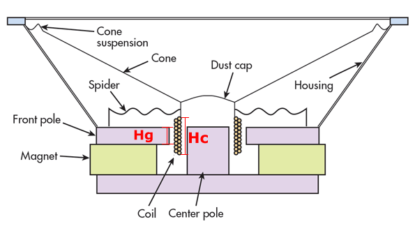

"Evenhung" refers to the relationship between the height of the magnetic gap (AKA top plate or front pole of the motor assembly) and the height of the voice coil.
Here's a cross section of a typical driver.
In this case, the voice coil is taller than the top plate, so the voice coil can move some distance in or out and still keep the same amount of turns of wire fully in the magnetic gap, so the force generated by the voice coil stays nice and linear with respect to changing input signals. That would be called overhung.
An Even hung coil would be exactly the same height as the gap, so as soon as the coil starts moving, it no longer has the same number of turns of wire in the gap, so won't trach the input signal in as linear a manner.
This is mostly going to result in increased distortion, but also would mean that the driver just doesn't continue to get louder as the input signal is turned up.
