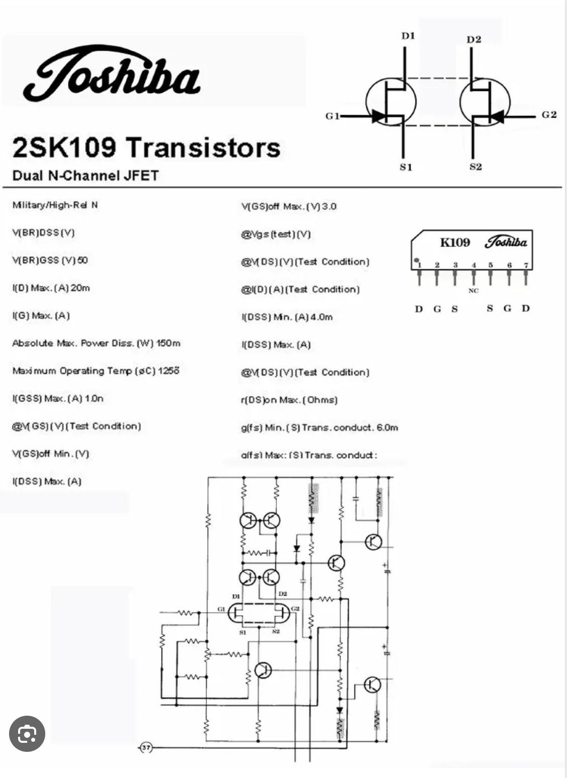

A Alexandre Member Joined 2004 2024-06-02 1:35 pm #1 2024-06-02 1:35 pm #1 The datasheets for Mitsubishi jfets do not exist on the internet, does anyone have the databook? Thanks, Alex JonSnell Electronic Member Joined 2012 jonsnell.co.uk 2024-06-02 2:35 pm #2 2024-06-02 2:35 pm #2 That is because they were made by Toshiba and Mitsubishi badged some as their own. A common occurance. Attachments Screenshot 2024-06-02 at 14.34.03.png 253.2 KB · Views: 70 Reactions: Alexandre You must log in or register to reply here.
