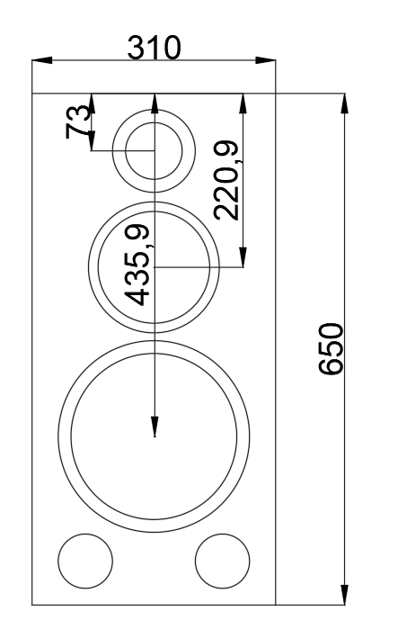

Looking for crossover for Satori 3 Way build
This is my design.
The idea was a box with a chamber for mid/tweeter about 8 liter and 43 liter for woofer.
2 font bass reflex ports 4,7cm diameter and 25cm long to tune to Fb/F3 28/31Hz
