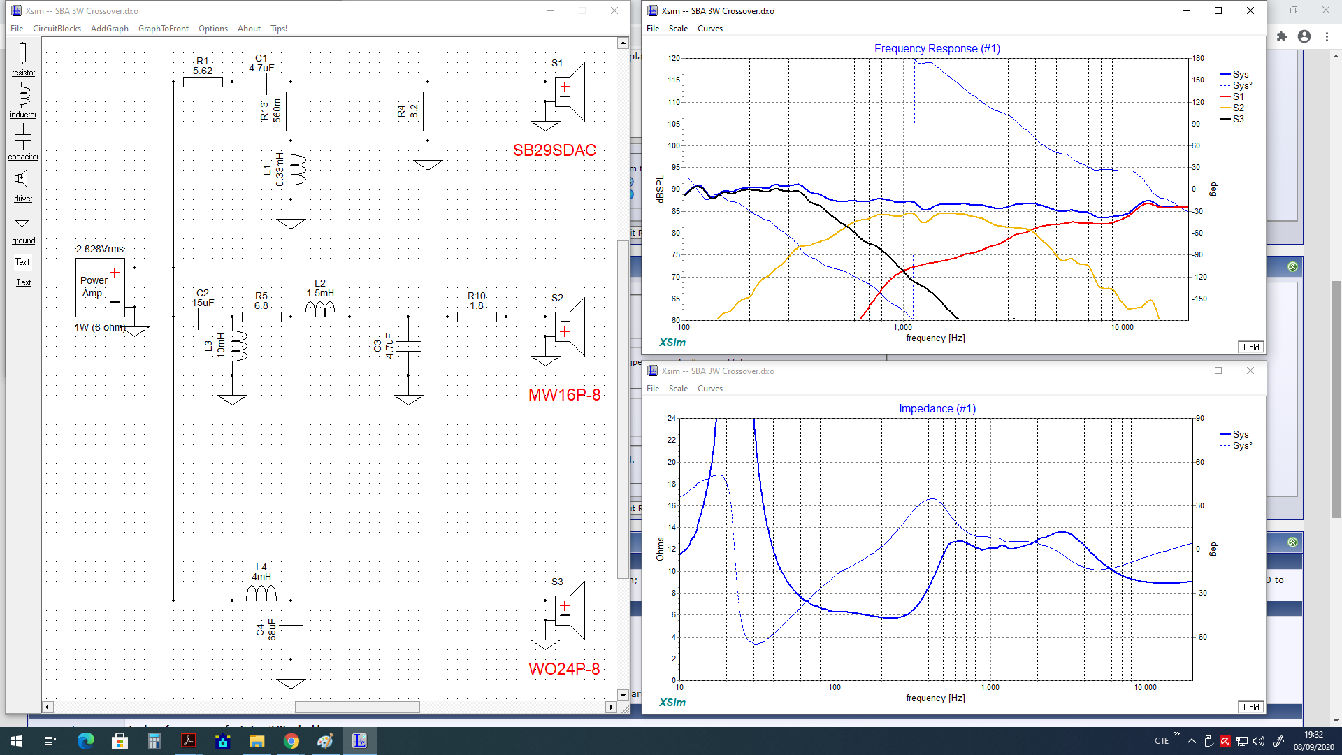

I have made this first simulation, but it looks impedace is very high from 500Hz (woofer/mid crossover point).
Box will be very similar to Troels Gravesen SBA 941 design.
600 H x 310 W x 350 D
Roughly 45 liters for woofer.
What do you think about?
Attached you will find the Xsim file to play with

High impedance is usually no problem. That high impedance is particularly caused by the 6.8 Ohm series resistor in series with the mid. Do you really need that much attenuation for the mid? I bet, that R5 can easily heats up when volume is cranked.

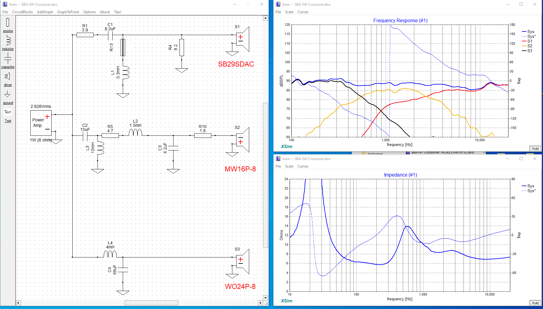

Since you are crossing the 160 mm driver at about 3.8 kHz, I suspect you will be getting some beaming in that region. That driver will be dispersing widely up to about 2k, then it will start to narrow. Then at 3.8 k the 29 mm dome takes over and the dispersion will be very wide again.
Have you tried any simulations where the crossover from MW16 to SB29 is a bit lower? Like 2.5 k? I suspect a lower crossover will have a more smoother off-axis response (horizontal off-axis response).
Thanks to all for your help and tips.
Hifijim, I’m going to try a lower crossover point too.
I’m in the preliminary stage doing simulations and will order parts to try.
Let’s see if I can find a lower crossover point.
The fact is that I’m in doubt I’d stick to the sb29sdac or try the satori tweeter.
Again: any help or tip will be very welcome.

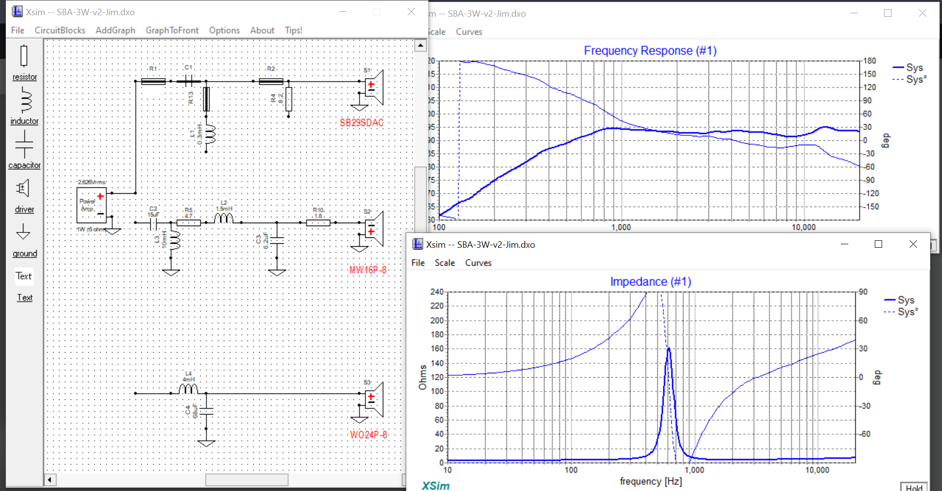

I think there is something wrong with the impedance file for the SB29SDAC driver. looking at filename=SB29SDAC.zma I see a maximum impedance of 161.809 Ohm at 612.866 Hz. The SBA website shows the max impedance should be around 11 Ohm at that same frequency.

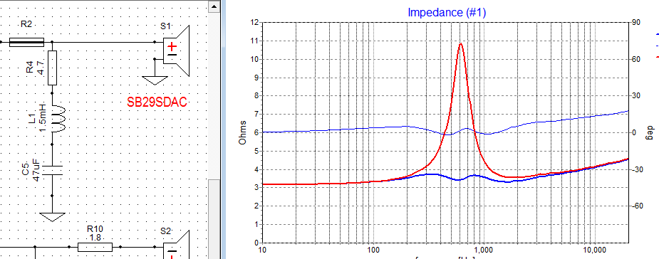

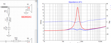

I traced it again. It is different but it is still difficult to work with. Maybe you could try a notch filter instead of the parallel resistor (you can still use a parallel resistor as part of an L-pad if you want the impedance to stay lower).
[Rename the file by removing .txt]
  • sb29sdac(b).zma.txt
    sb29sdac(b).zma.txt
