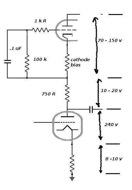

Here's a few details to help if you wish to use your OT as per my suggestion:
For the interstage, these resistors will provide ground reference,
and hence cathode bias, provided they follow recommendations for the RS242.
This is in case your interstage secondary doesn't have a c.t.
Here's a more detailed sketch of one half of an output section:
The 750 ohm load resistor only needs to be 2-5 watts.

If its not an autotransformer, I don't see a problem in my circuit.

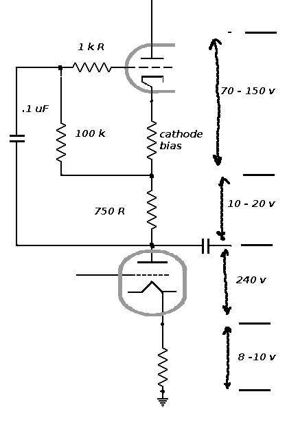

If you move the lower end of the 0,1u to the output tubes anode(below the 750) you get a bootstrapping effect and a significantly higher Ri. Drawing error?
Yep. Sorry about that. Up late.
Here's the corrected version:

Thanks for the tip.I will try it.You may split it, like 27k at the bottom, 6k2 at the top.
The result will be almost like CCS load.

I think you are a bit confused:
Almost all output transformers are bifilar, so that DC for instance in Push-Pull styles are mostly cancelled out.
SE transformers are also bifilar, the purpose being mainly close coupling between windings.
In SE (single ended) transformers, the only design difference of significance here,
is that there is a physical gap in the core and larger core mass to prevent early saturation due to an imbalanced DC current.
The 'bifilar' characteristic, meaning paired wiring is used for close coupling has nothing to do with suitability for grounded or ungrounded use.
The circuit diagram for this transformer shows nothing unusual,
or unsuitable for my circuit:
Here's a good quote about the real difference between SE and PP transformers.
It illustrates that it is hard to use a PP for an SE, without careful planning.
However, you can certainly go the other way,
when you have no DC current issues, as in my circuit
(although a PP tranny is more efficient):

Look at my circuit again.
Yes its "Push-Pull",
but its also MINUS the standard PP-feature,
namely theres NO DC-current flowing through the primary,
not in either, nor in both directions. None at all.
So this circuit isn't "push-pull" in the normal sense.
Think again.

Now it looks better. One more thing: don't you think that 100K and 0.1 uF are odd near that upper tubes? Why don't you short and remove them?
Ahh ok.
Actually, you are probably right again:
